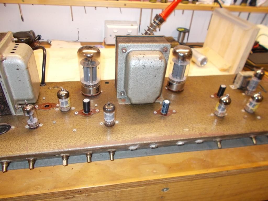

Hi guys, Thought I'd share another vintage Aussie amp.
I have a few Fi Sonics that are normally a head and cab for the 30w plus amps.
So this one is as rare as, cause I've never seen one before this
I bought this as a chassis only and looks like it's been sitting on a shelf for sometime.
Some interesting wiring has been done??????
Gave it the onceover and the OT looks to be good and the calcs put it at 5k with a 15ohm load (also found a datasheet) for a pair of KT88.
There did not appear to have any resistors fried but the CT for the heaters has got rather hot and made the plastic insulation on the wire brittle and some has broken off.
It appears to have enough insulation left under the paper rap, this wire is much lighter gauge than the heater wires themselves.
My thoughts are to trim the CT off under the rap so it does not come in contact with the transformer casing and add an artificial CT.

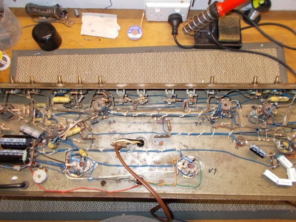

I have posted this restore http://www.guitargear.net.au/discussion/index.php?topic=48692.0  and there is some questions on some of the circuit wiring/components.
First up is the 10M leak resistors in the PI.
The 100k between the plates of V1
The 120k on V4
The extra 25u bypass cap on V4b
 :dontknow:
  • Posts: 5274
Re: FI SONIC KT88 COMBO
« Reply #6 on: June 02, 2017, 09:03:59 pm »
That's OK. A LTP PI has a very high input impedance even if you use 1M resistors.
That provides the path for the 'dry' signal.
The 120k on V4
That looks like a schematic error???
Maybe 50µF is better than 25µF???
  • Posts: 2928
« Reply #7 on: June 02, 2017, 10:17:18 pm »
Thanks sluckey.
The 120k is a mystery, I have checked that many times and all wiring is original.
I'm hoping to get this one up and running over the weekend, hopefully it won't go BANG!
Yes, it is. It would make sense if it connected from plate to plate. But as drawn V4B has a normal 100K plate load resistor connected to node C and the 120K is also a plate load resistor but connected to node D. That makes no sense! Are you sure it's connected as shown?
  • Posts: 2928
« Reply #10 on: June 06, 2017, 04:05:30 am »
Hey sluckey, This is the resistor in question
As you can see the solder is dull much the same as other joints and it's a carbon comp (the only one)
I'll remove it and take some more voltages.

« Reply #11 on: June 07, 2017, 06:17:56 am »
Perhaps just to raise D and E up a titch (perhaps E was under 200V).

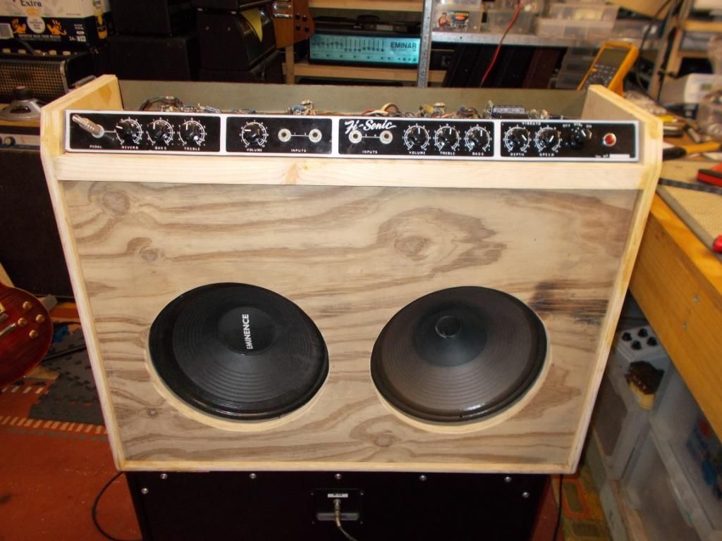

Hi guys, Some tiding up.
Some tweaking of the trem and reverb is still needed.

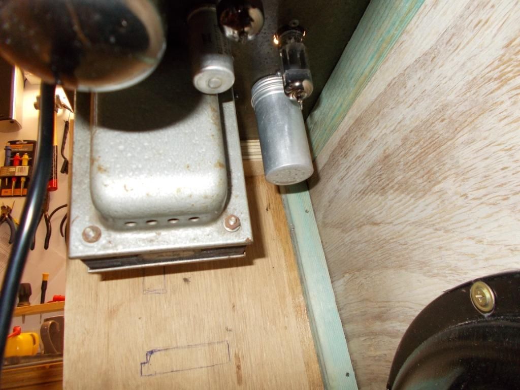

Hi guys, Some more progress.
Rewired trem circuit as the original wasn't great. This circuit is in other Fi Sonic amps.
The reverb rewired with the control pre recovery stage, work much better, more usable reverb.
New LDR/NEON as the old ones were stuffed. The original setup had these mounted on a 4pin socket. Not having a 4pin plug,I found a replacement and a nice aluminium can to house the LDR/NEON(I'm assuming this is what they were thinking)
With most Fi Sonic's they had a removal lid, makes working on them great.

I have a choice of speakers
These are in most of the Fisonic cabinets along with 12ux50 speakers
There is also a 12UX50 I have seen as well
The info on the 12u50 I believe they are more a bass speaker and the 12UX50 is a PA/guitar
These Etone's have also been found in some cabs and are a guitar speaker.
I believe they are rated at 30w and the 12U50 are 50w
I'm sure the amp will push 60+ watts.
