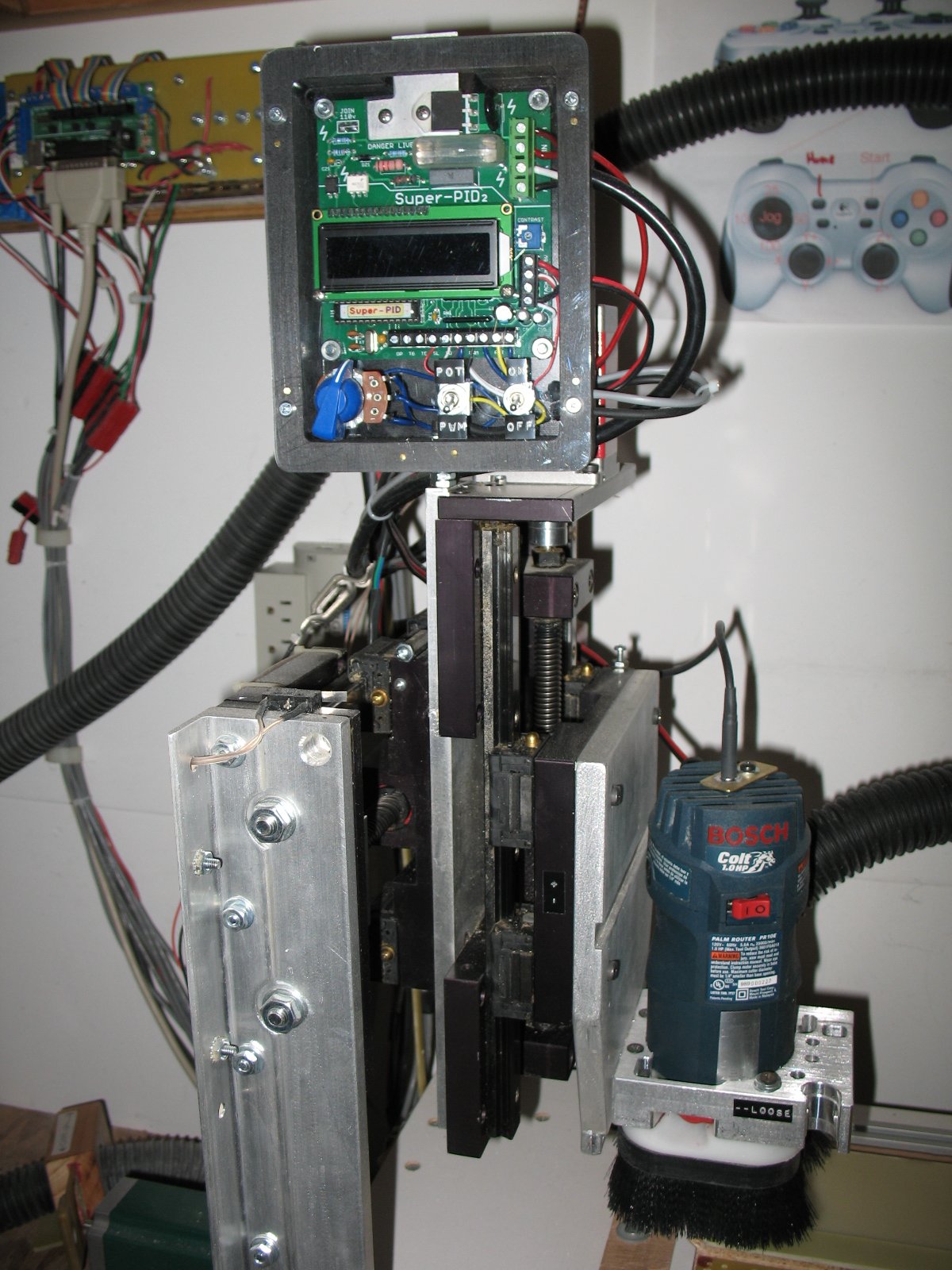

Super PID
I have my Super PID mounted on top of my Y axis
The power to the router and the sensor wire move up and down when the Z axis does
This mounting has worked out really well

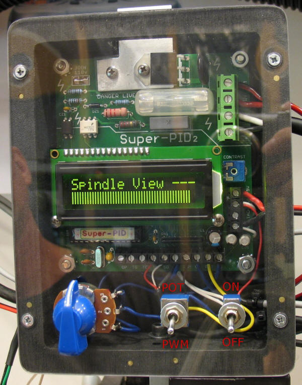

Super PID Motor Control
The Super PID circuit board is inside a box that I machined from black HDPE plastic
The clear cover is Lexan
I have since added labels to the switches with a Rotex label gun
The pot can control the motor speed manually when the switch is set to POT
When the switch is set to PWM, Mach 3 controls the motor speed with G-code
The ON/OFF switch can turn the motor on and off manually.
Or, Mach3 can control the motor on and off with G-Code

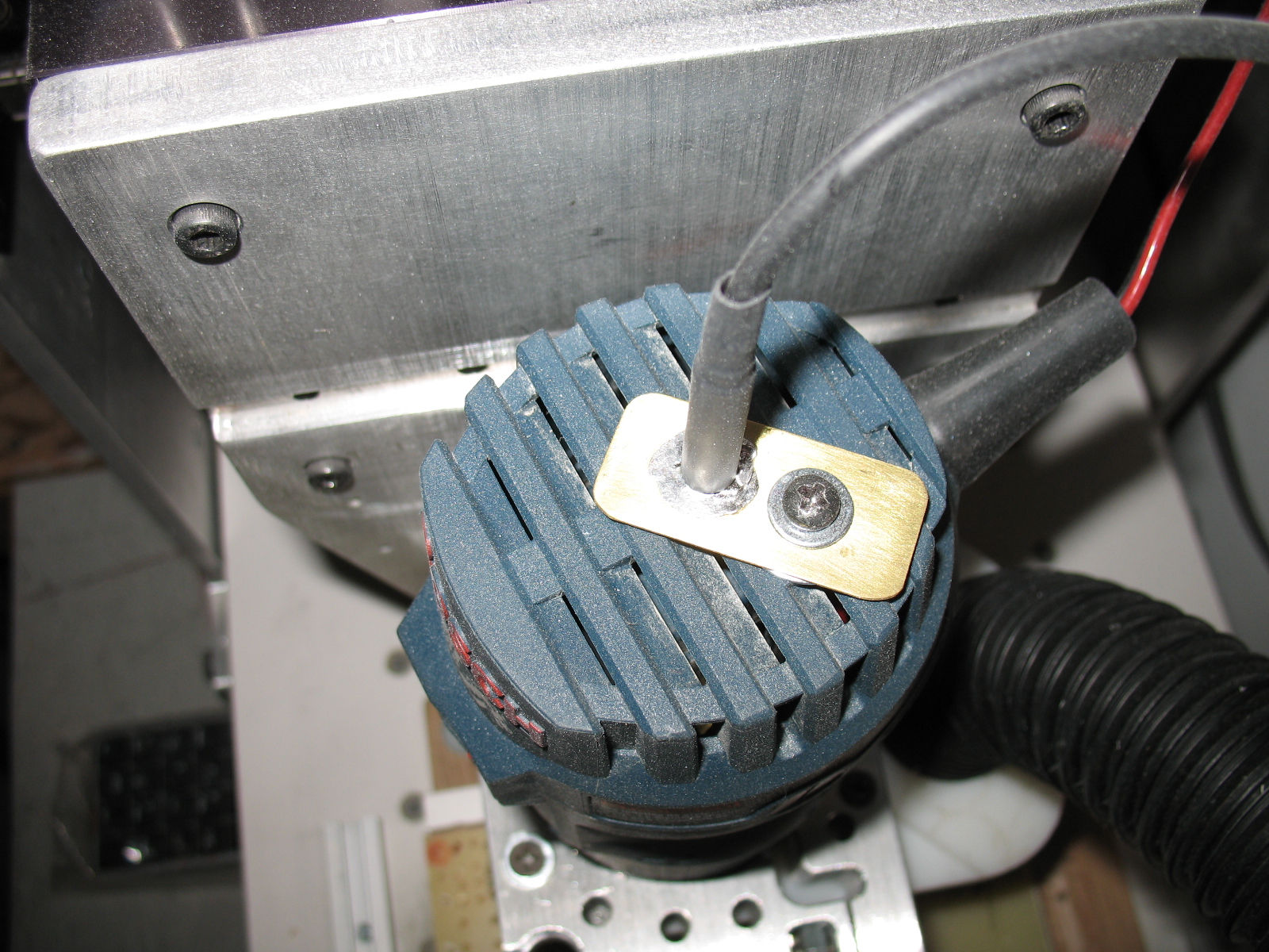

You have to install a speed sensor on the router so that Super PID can detect what the current motor speed is
The sensor detects a Light and Dark area on the motor shaft.
If the router speed slows down under a heavy cutting load, the super PID will increase the motor speed to keep it constant.
I soldered a piece of round brass tubing to a flat brass plate
The sensor is Pushed down into the brass tube and is just a few millimeters above the Black and White area on the motor shaft
I used a dab of clear silicon RTV to glue the sensor into the brass tube and to keep dust out
I added some heat shrink tubing to the sensor wire to make it thicker and to give it some strain relief.
The black screw is the stock cover screw for the Bosch Colt
I drilled an over sized hole in the blue plastic housing that is off center
This way you can move the sensor around a bit and find the best spot and then lock it down with the screw

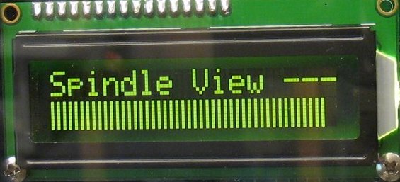

spindle meter
As you manually rotate the motor shaft the Super PID will show you the strength of the sensor reading
Rotate the motor shaft so the sensor is reading the white area on the motor shaft
You want to get the green bars as high to the right as possible when the sensor is reading the White area on the shaft
Then you rotate the motor shaft to the black area
You want the green bars as low as possible
Lock the sensor down when you find the best spot

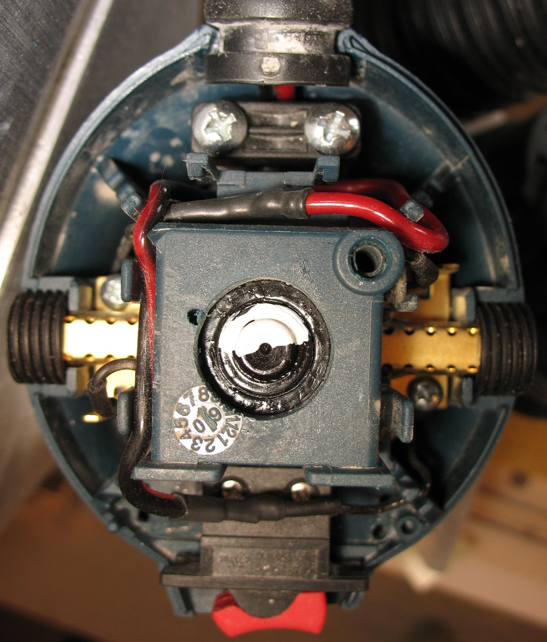

Bosch Colt
Here you can see the end of the motor shaft is painted Black and White
The sensor is positioned a bit off the center of the shaft so it gets a clear picture of the Black and White area as the shaft is spinning
The blue plastic housing had to be trimmed to be able to see the end of the motor shaft.
I trimmed a big round hole with a Dremel tool rasp bit.
You could also drill the hole out if your drill can accept a large bit
You have to take the router apart and remove the blue plastic housing to be able to do this
The big blue square cap you see in the picture above is the rear bearing support
My housing had two spring washers behind the bearing
These washers push the bearing down and keep the shaft from bobbing up and down
In the picture above you are looking at the motor shaft and part of the pressed on rear motor bearing.
The bearing fits snug in the blue plastic housing, but you can pull it apart easily.
Take out the brushes first before you disassemble the router

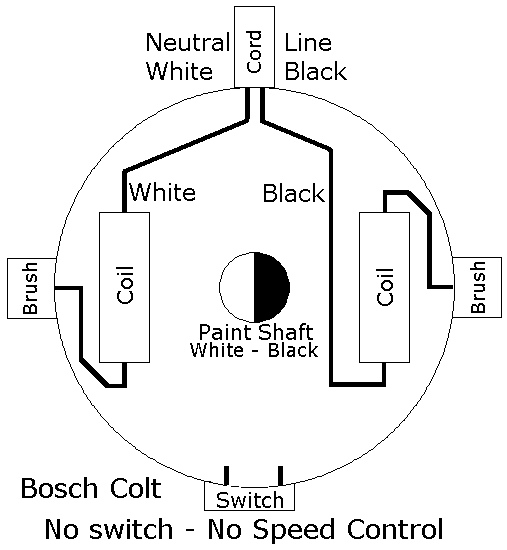

Bosch Colt wiring diagram
Here's the Bosch Colt wiring diagram with the switch and speed control disconnected
You have to get rid of the variable speed control in the Bosch Colt to be able to use the Super PID
I also disconnected the red power switch because it is a wimpy little switch and is a weak point.
You want the wiring to be solid and direct to the motor brushes to get the most power.
I soldered and heat shrinked my connections
There's no need for a power switch if you have Emergency stop on your CNC
You can also stop the router on the Mach3 screen or with the keyboard
I left the power switch in the housing just to block dust, but it does nothing
I also removed the big bulky Bosch Colt power cord
I only needed a 3 foot long cord that goes from the Super PID to the router
I used some super flexible 18 gauge zip cord
That cord is Red and Black in the picture up above.
