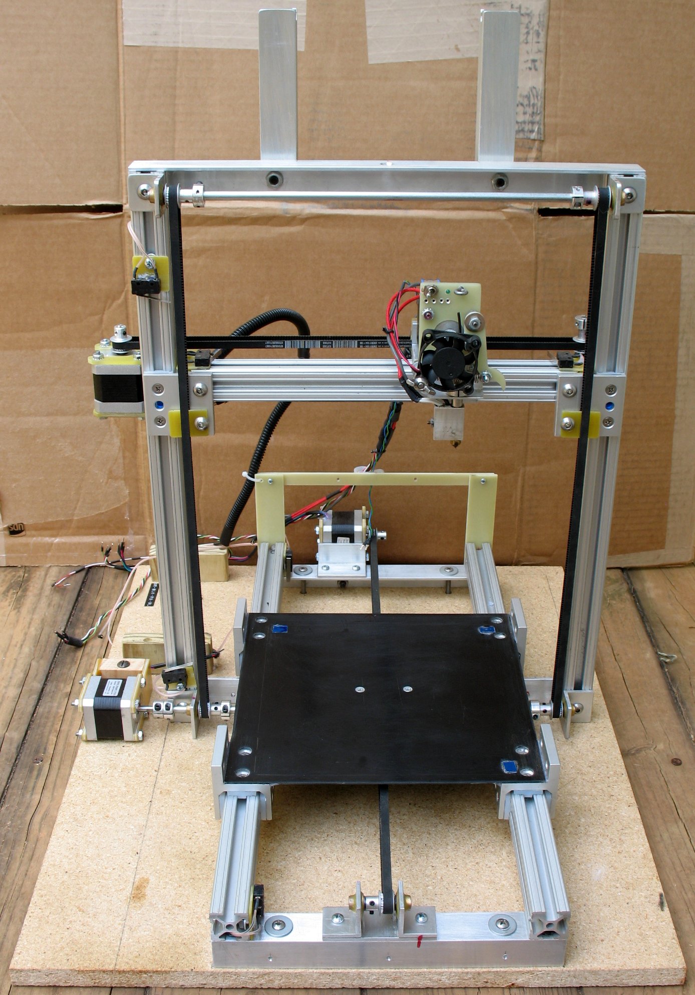

Here's the printer spec's
The print bed is 200mm x 200mm X and Y axis x 254mm for the Z axis
The Frame is 1 inch T-Slot extrusions
The Bearings are T-Slot linear bearings that use UHMW Plastic.
There are no lead screws and no smooth rods
There are 4 x GT2 drive belts and 8 x GT2 20 tooth pulleys
4 x Nema 17 Stepper motors
2 x Metal drive shafts with bronze oil lite bearings
40 watt cartridge heater for the extruder
Probotix driver boards, breakout board and power supply

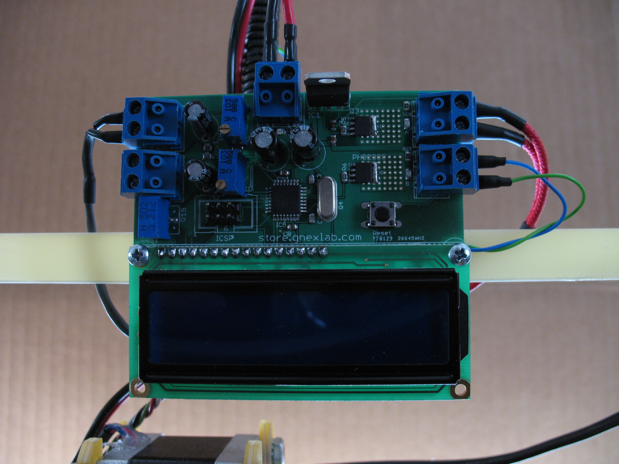

Gnex lab dual temp control board for the hot end and heater bed
Ball bearing filament spindle
The G-Code is created using Slic3r
I am running the G-code using Mach3
All the yellow-ish colored material you see in the images below is G10 Garolite
I machined all the Garolite pieces on my CNC machine

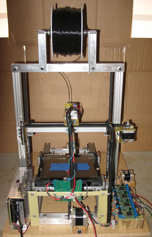

3D printer 3D Printer

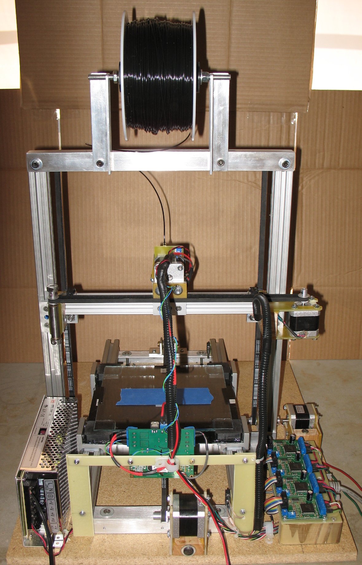

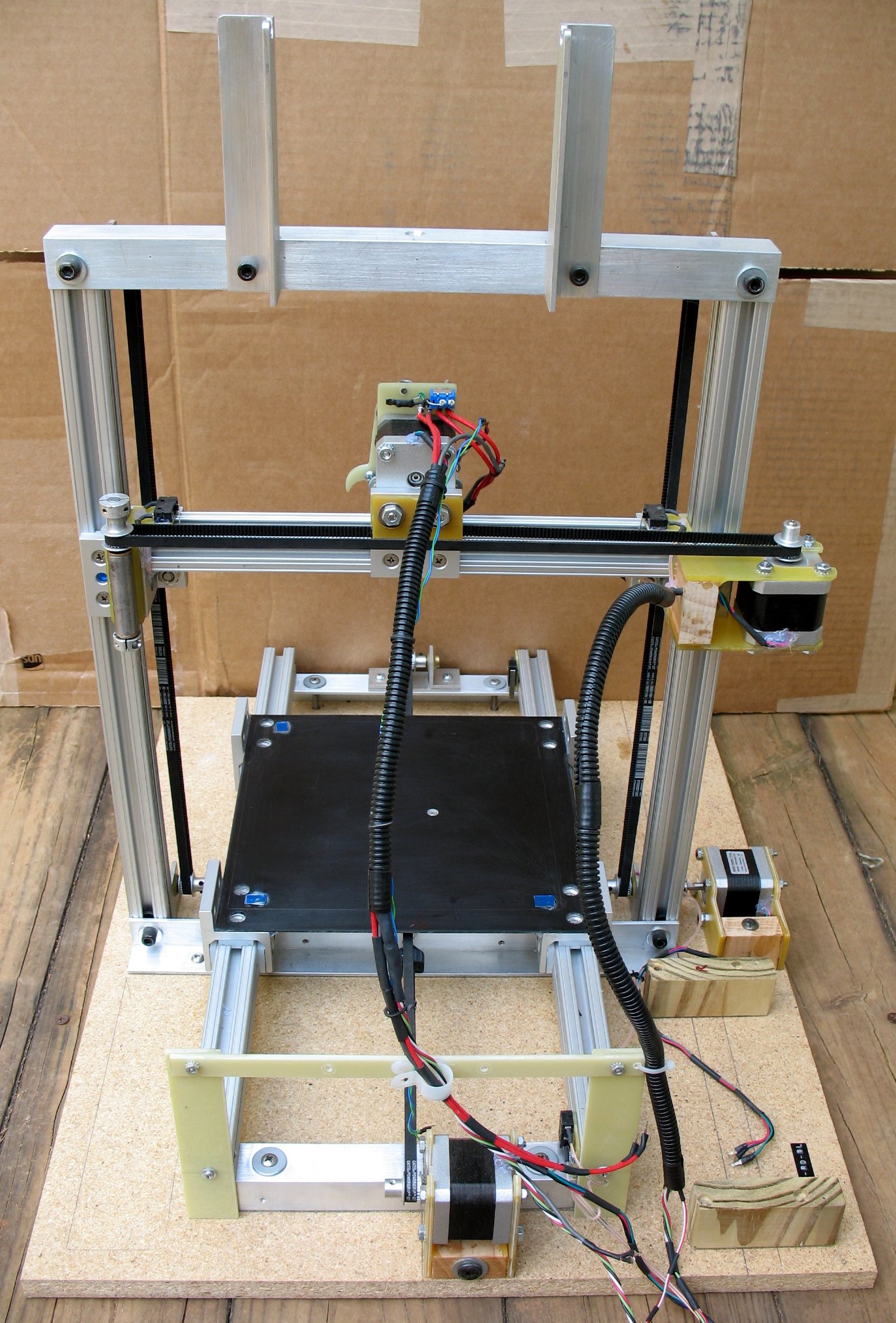

Left: Front view - Right: Rear view

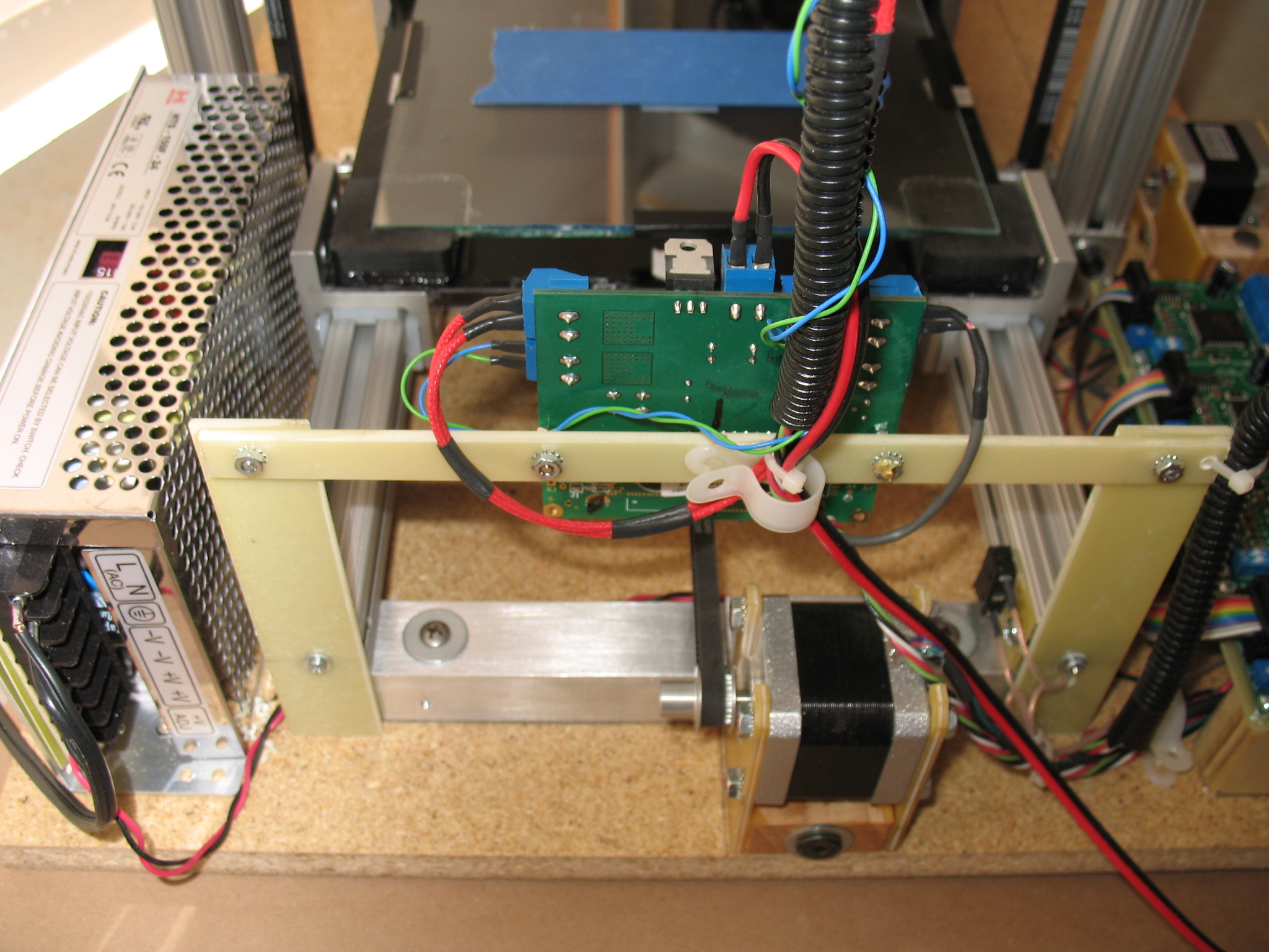

The frame, Y-motor, electronics and power supply are screwed down to the board

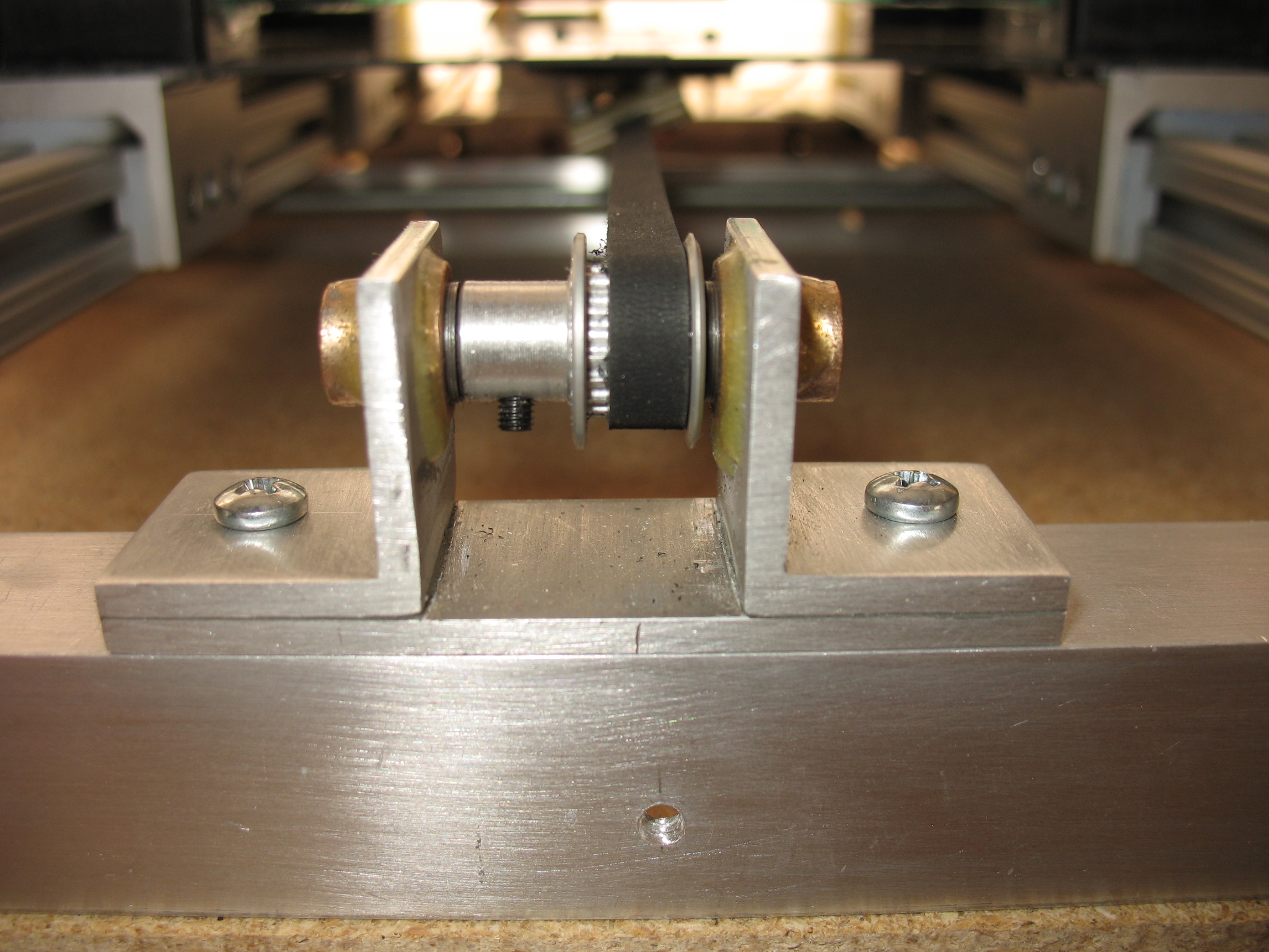

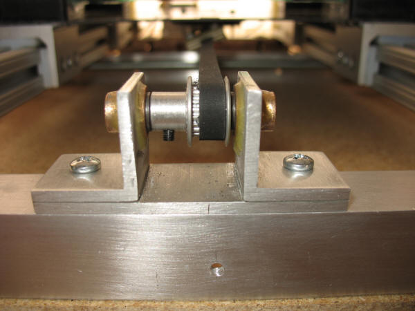

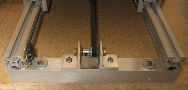

3d Printer front end 3d Printer front end

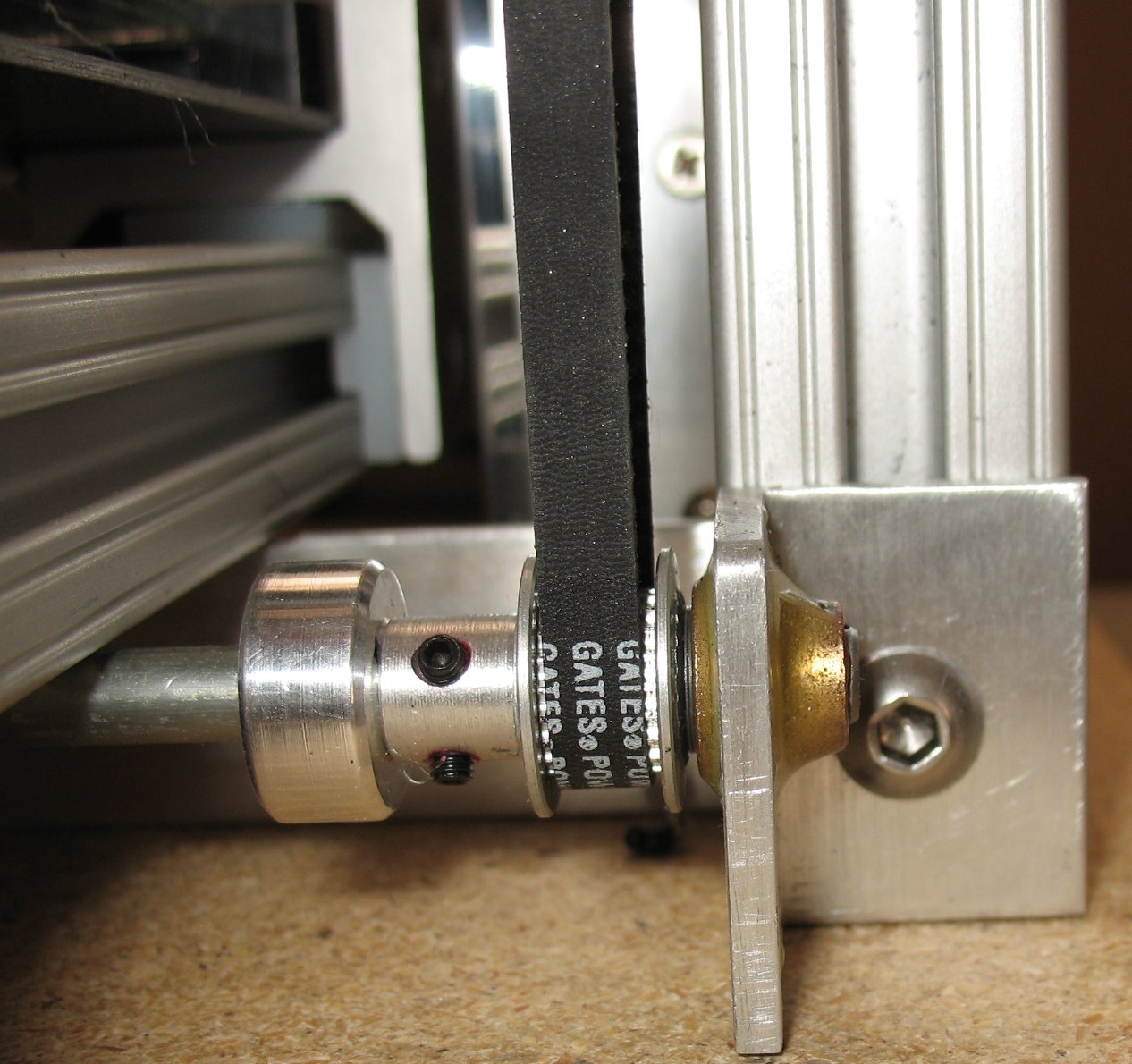

Left: The front end of the Y axis
Right: The Y axis belt idler pulley
The belt is clamped under the bed in the center
The belt is cut at this point and there is a spring attached to a clamp that spans a gap and keeps tension on the belt

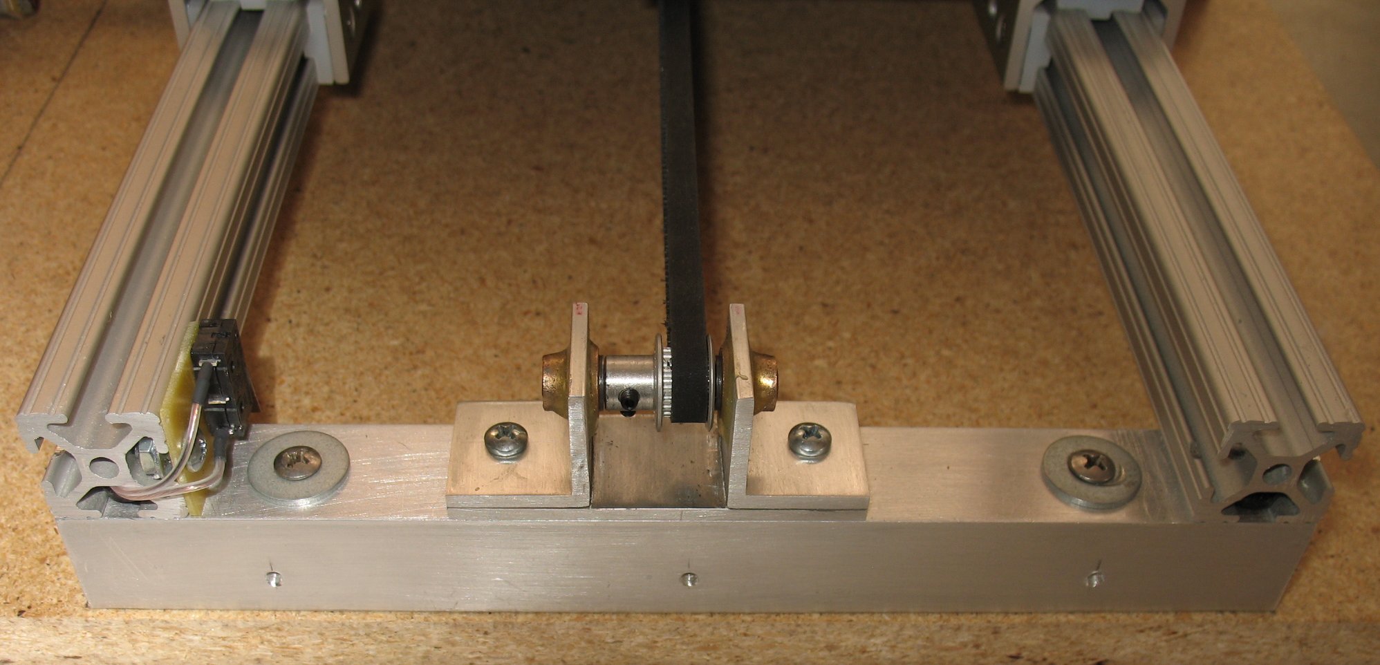

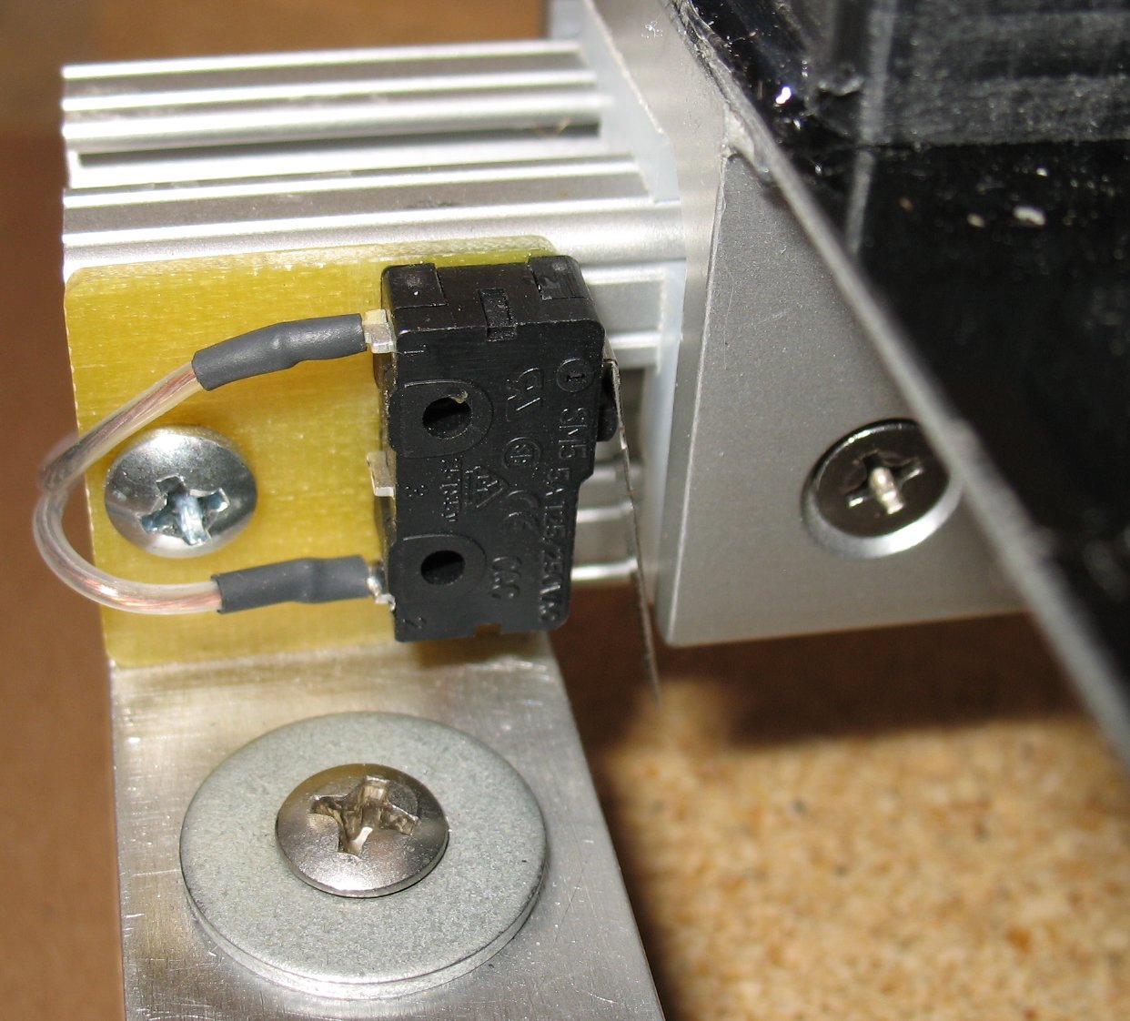

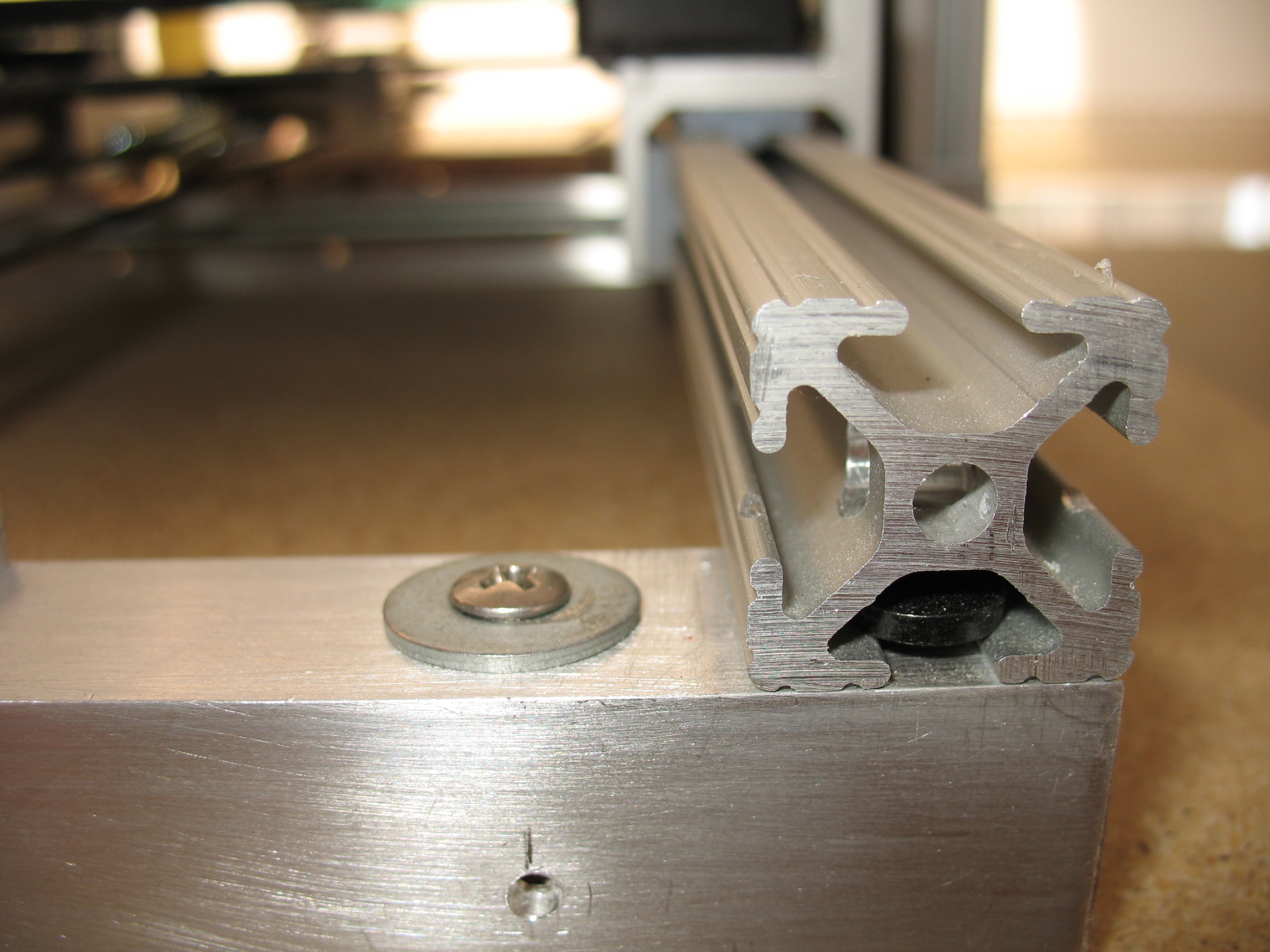

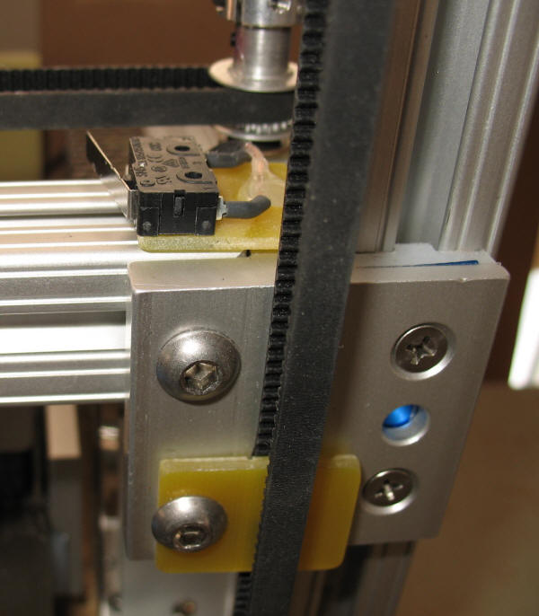

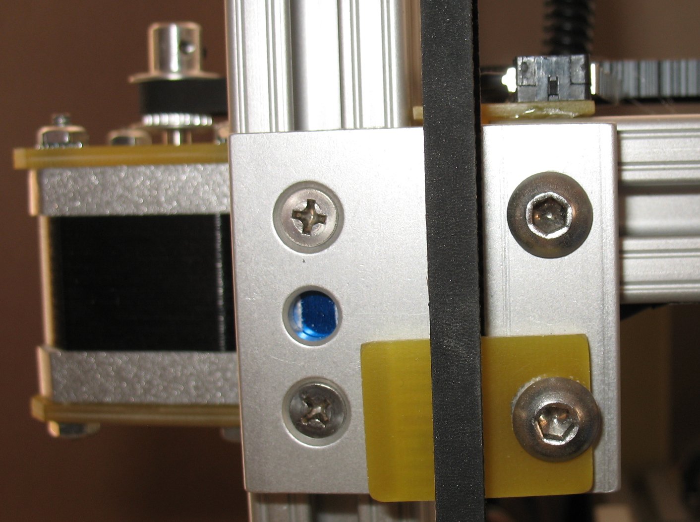

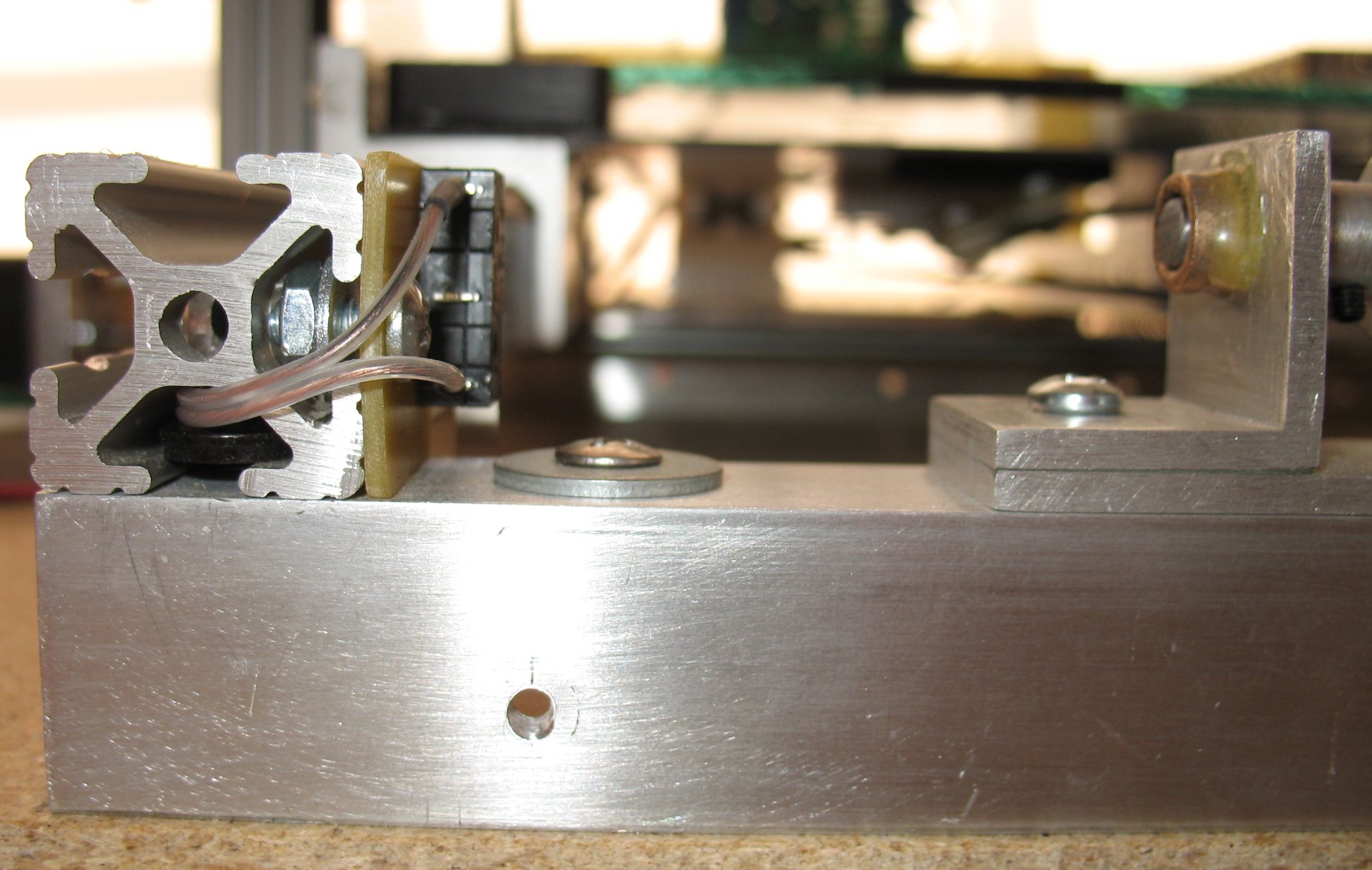

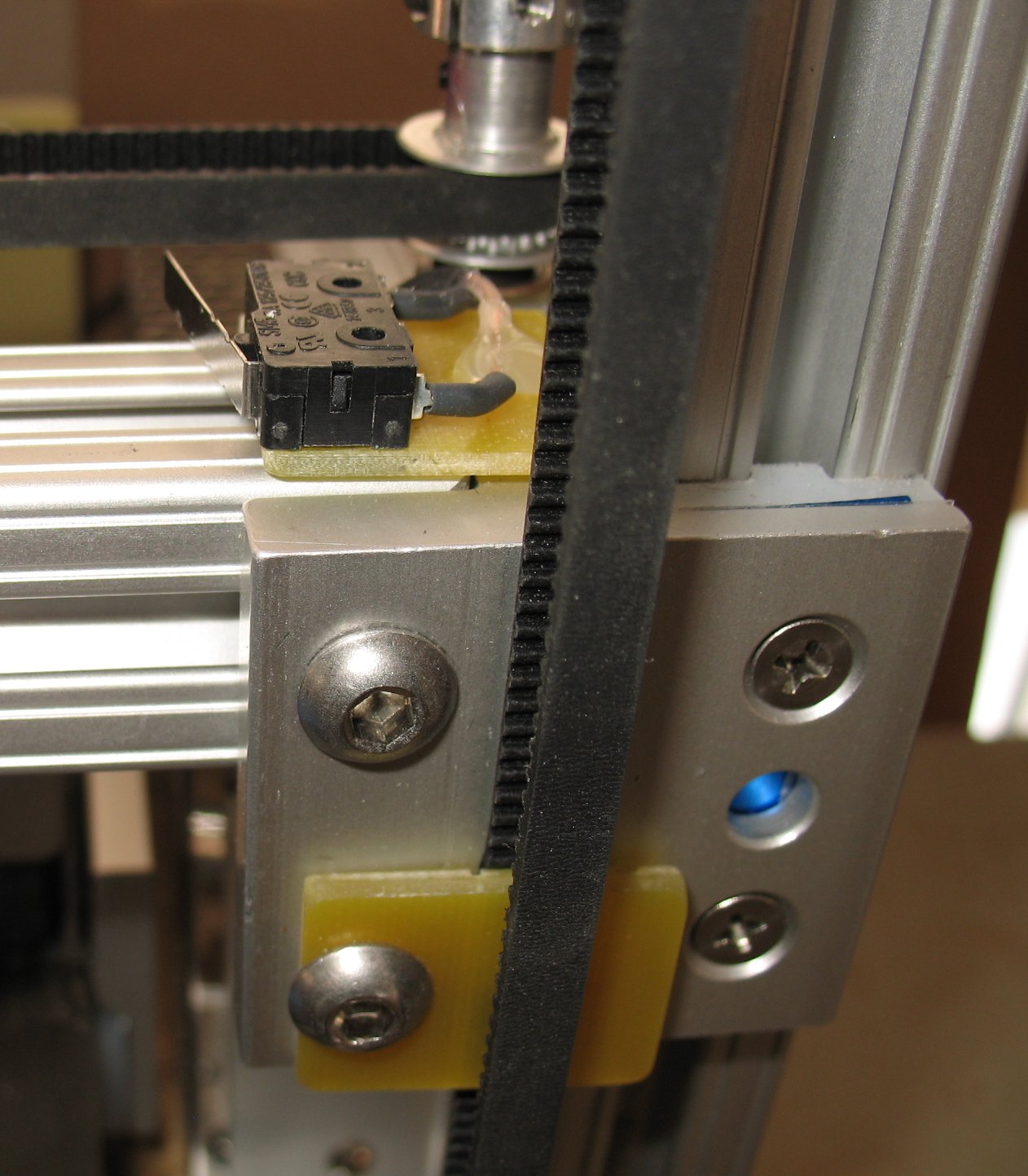

Left: Y axis left side with limit switch attached to T-Slot
Right: Y axis right side
The T-Slots are bolted down to 1 inch aluminum angle using T-Slot 1/4-20 nuts and bolts
3D printer Limit switch  3d Printer Linear bearing
Left: Close up of a limit switch
The linear bearings contact the limit switches
Right: Close up of a T-Slot linear bearing

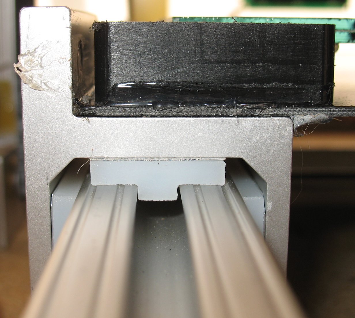

The bearing material is UHMW-PET
The UHMW-PET bearings are screwed onto the bearing blocks
.005 inch shims are used behind the bearing material to get the 3 bearings set perfectly on the T-Slots
By adjusting all 3 bearings on each bearing block, you can remove all the play and get a smooth sliding bearing
It's a bit of work to get these bearings set right

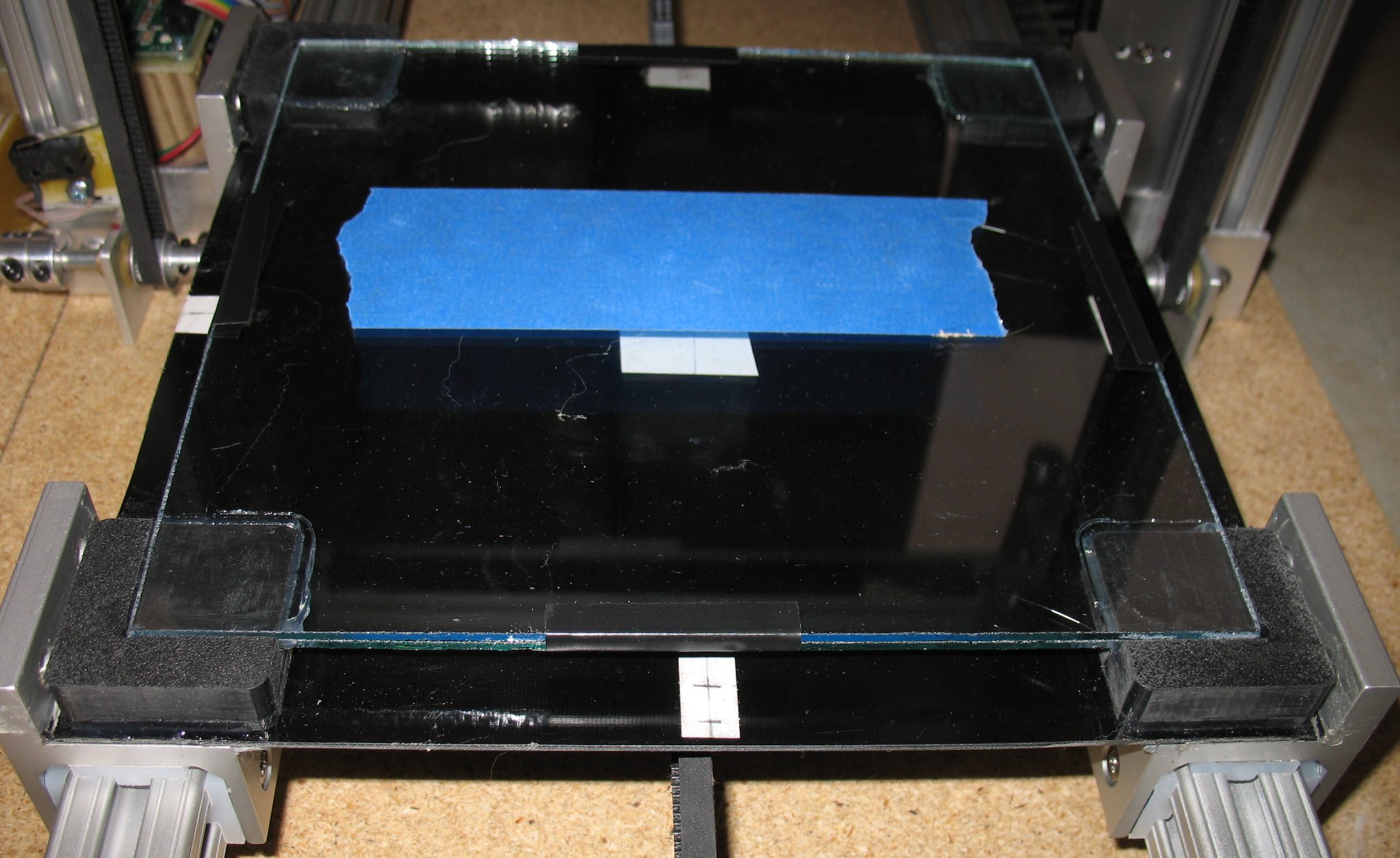

3d printer bed -3d printer bed

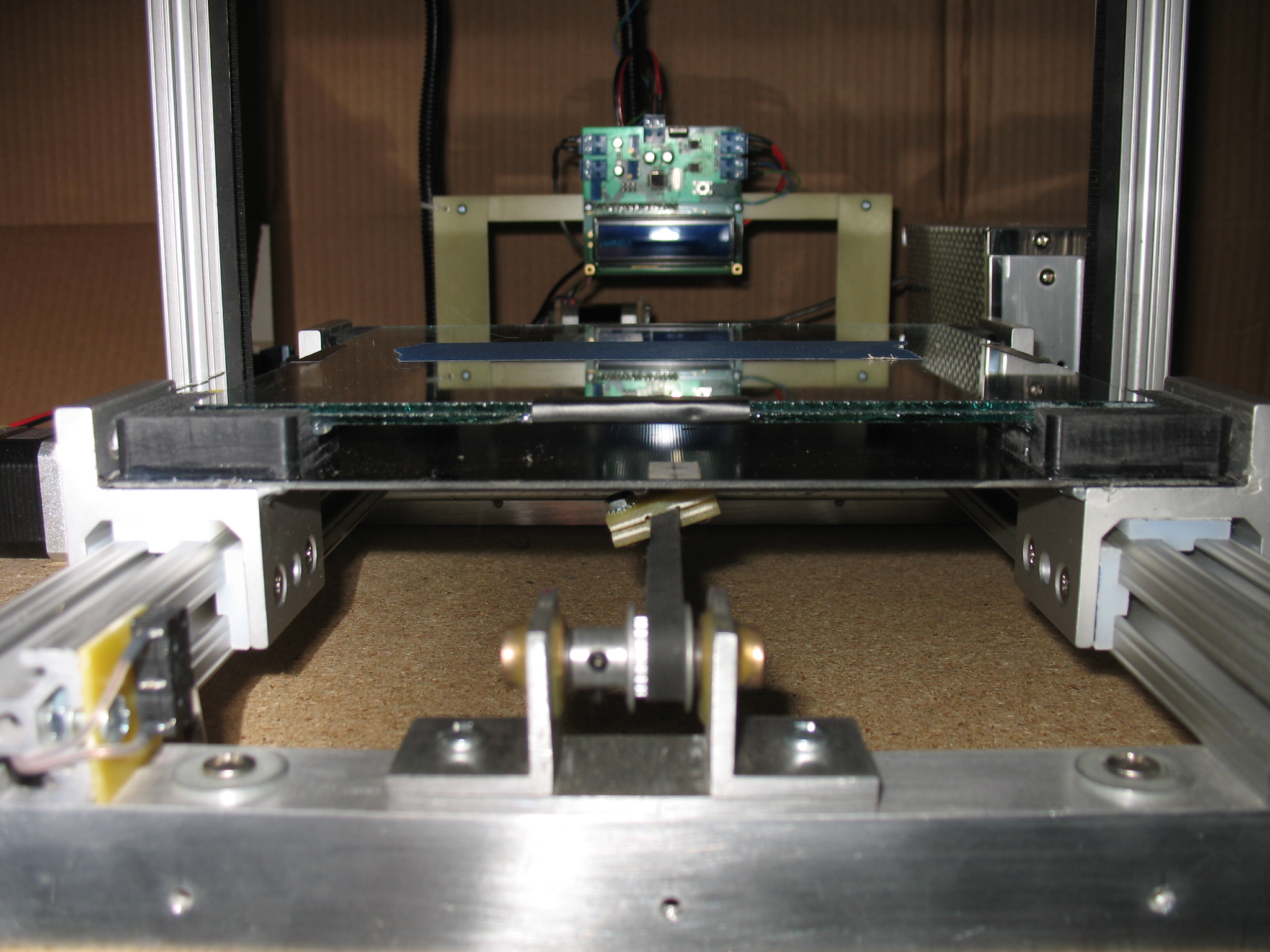

A couple shots of my 3d printer bed
I don't have a heater yet but I left room under the glass for a 8 x 8 inch heater
The black material is G10 and it is glued to the bearing blocks
This method keeps the bearing blocks in perfect alignment because there are no screws forcing it one way or the other
The whole bed slides out the end of the T-Slots as an assembly
I have two sheets of glass
The bottom glass sits on 4 corner blocks and the glass is glued to the 4 corner blocks
The top glass can be removed
The top glass is leveled by inserting .005 inch shims under each corner
I am currently only printing PLA and so a heater is not needed
The PLA sticks to the blue painters tape really nice
If I want to use ABS, I will have to install a heater

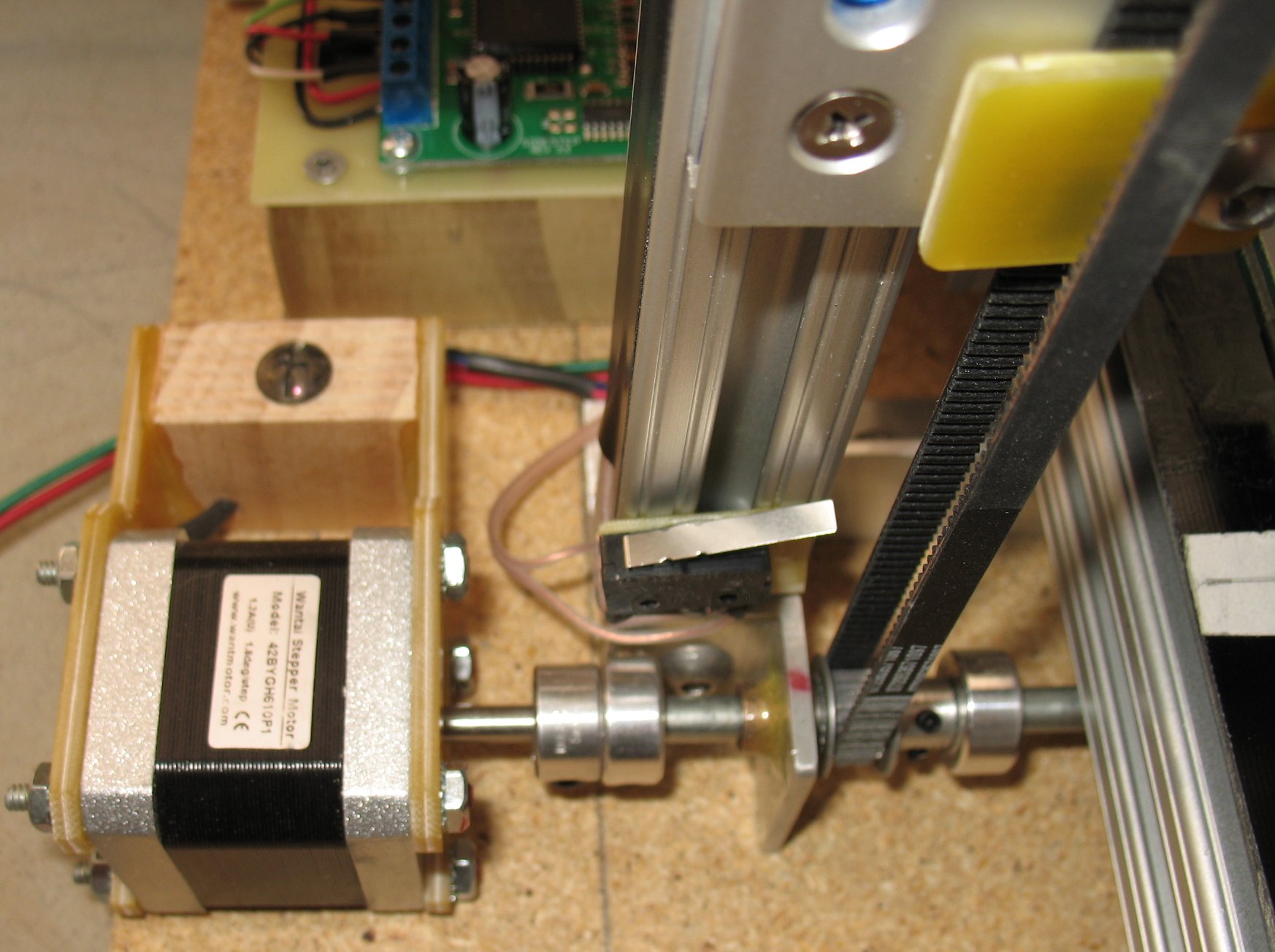

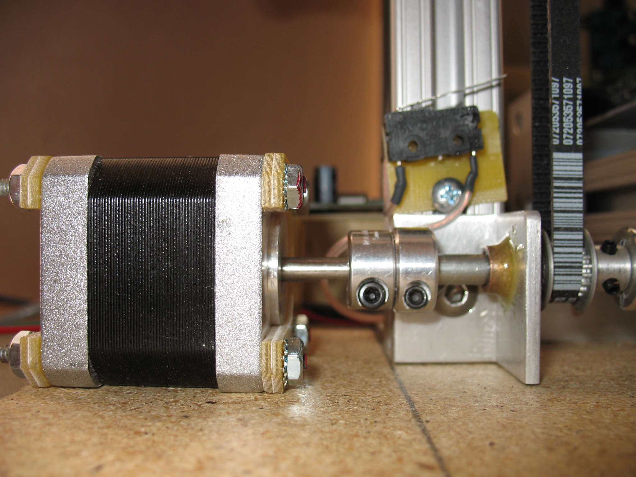

3d printer motor 3d printer stepper motor

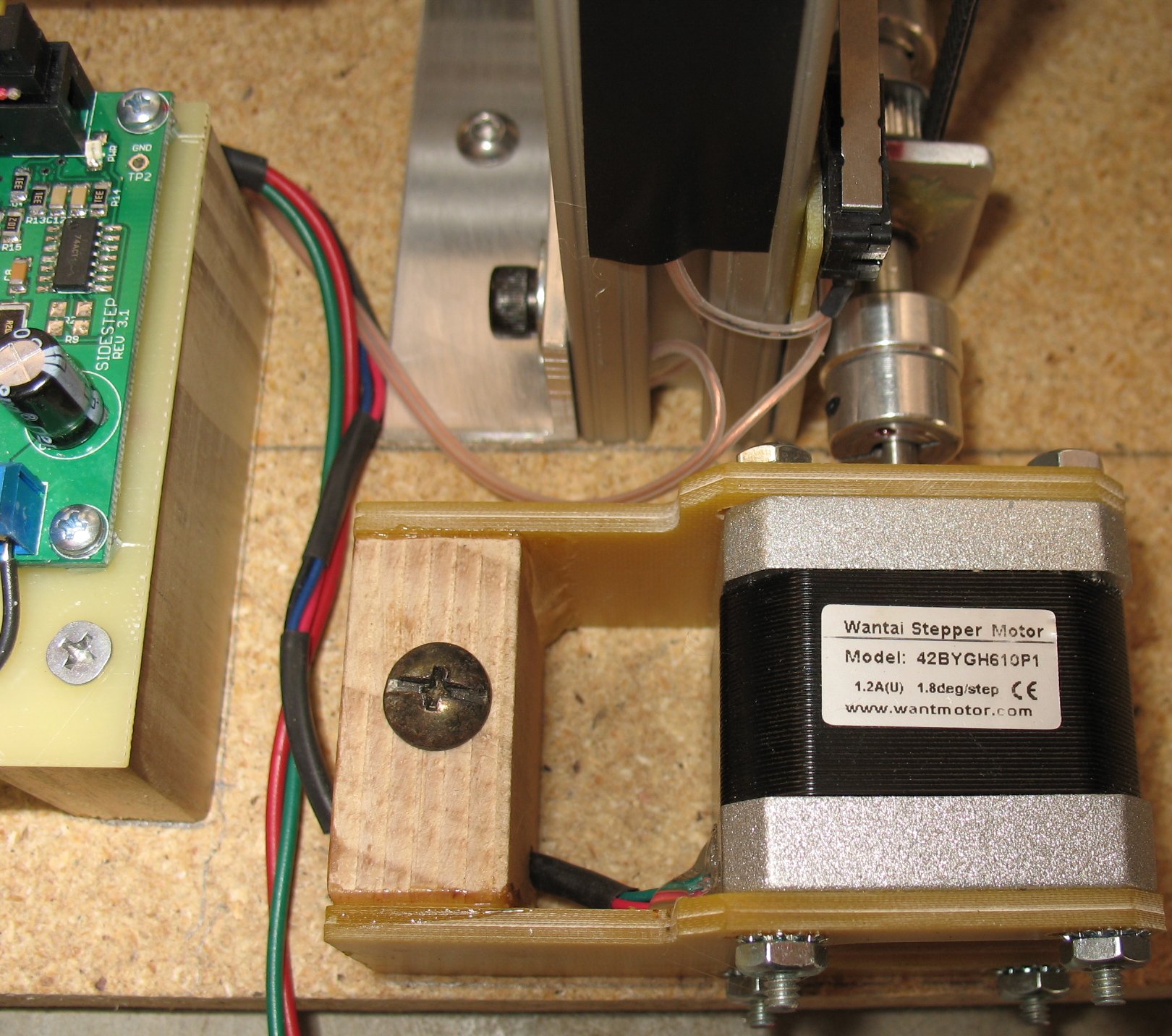

The Z axis stepper motor
The motor is coupled to a drive shaft
The drive shaft bearings are bronze Oil Lites which are epoxied onto right angle brackets
The drive shaft has a GT2 20 tooth pulley on each end
There are clamp on spacers next to the pulleys just to give some added support to the pulley
The pulleys drive two GT2 belts
At the top of the frame is another drive shaft with two GT2 pulleys
The belt is clamped onto the Linear bearings of the X axis at each end of the X axis
This way, the X axis has two belts pulling it up and down to keep it level and in sync
See the images below also

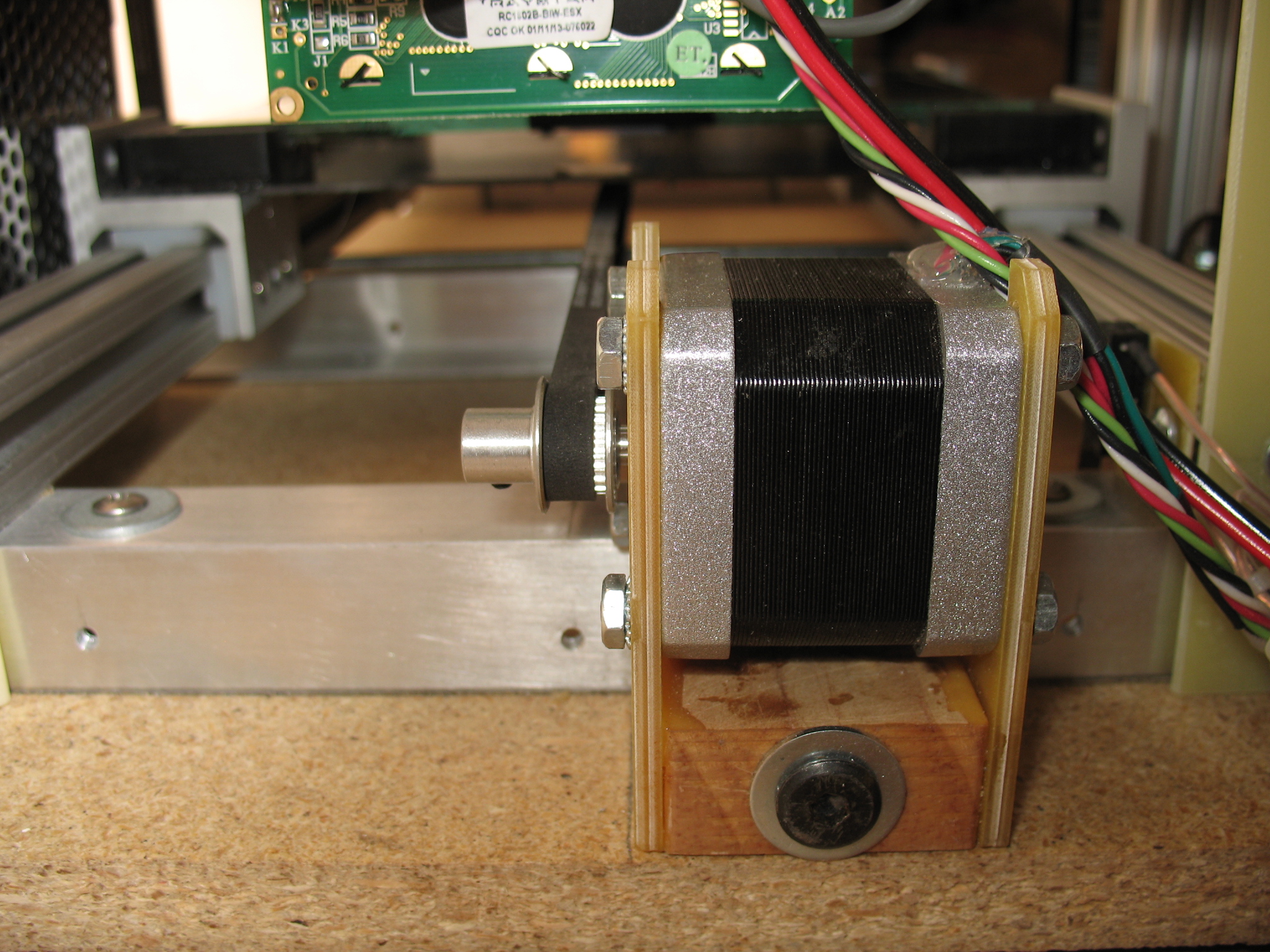

Left: Rear view of the 3D printer
Right: Rear view of the Y axis stepper motor

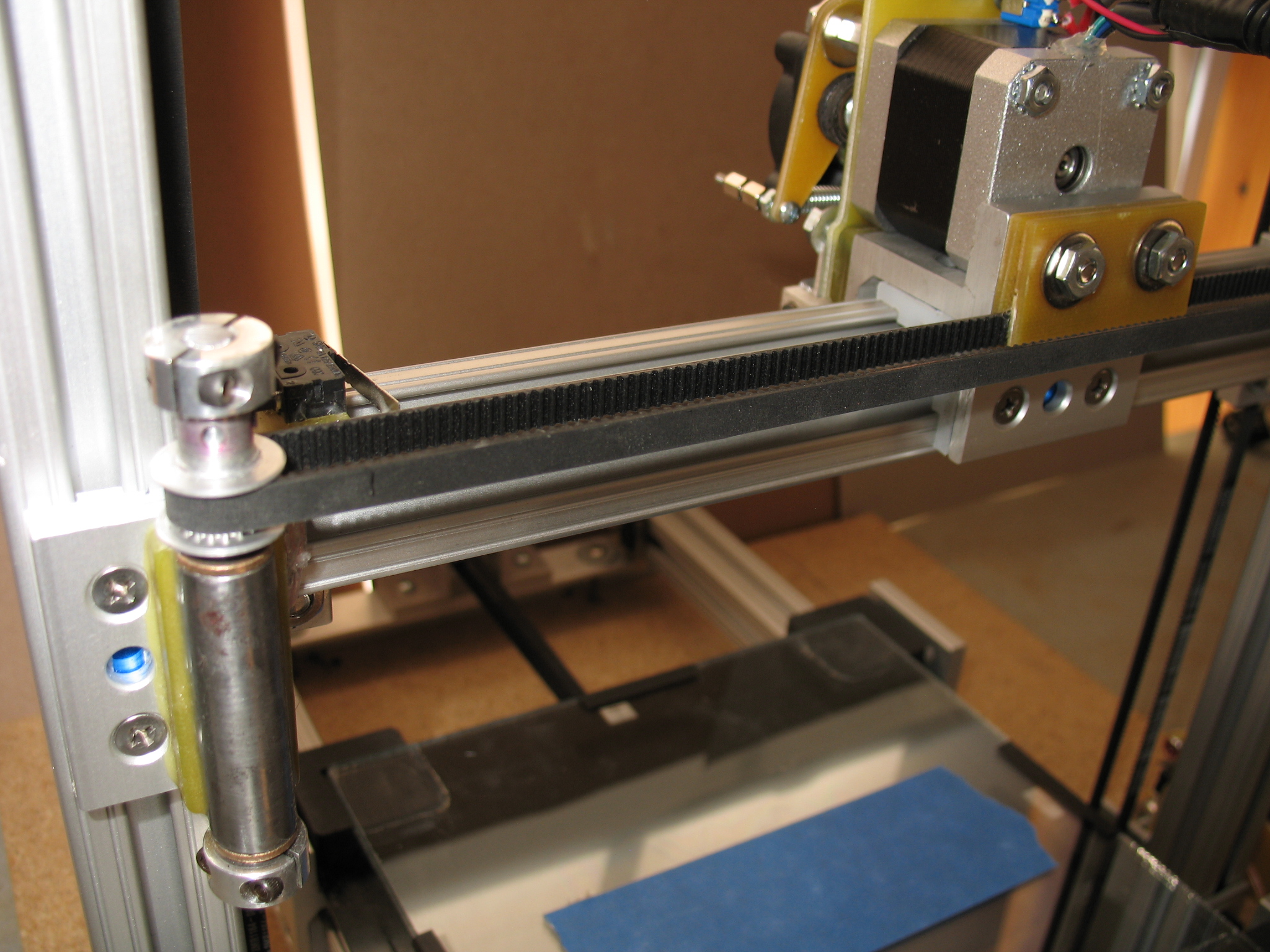

3d printer X axis 3d printer X axis

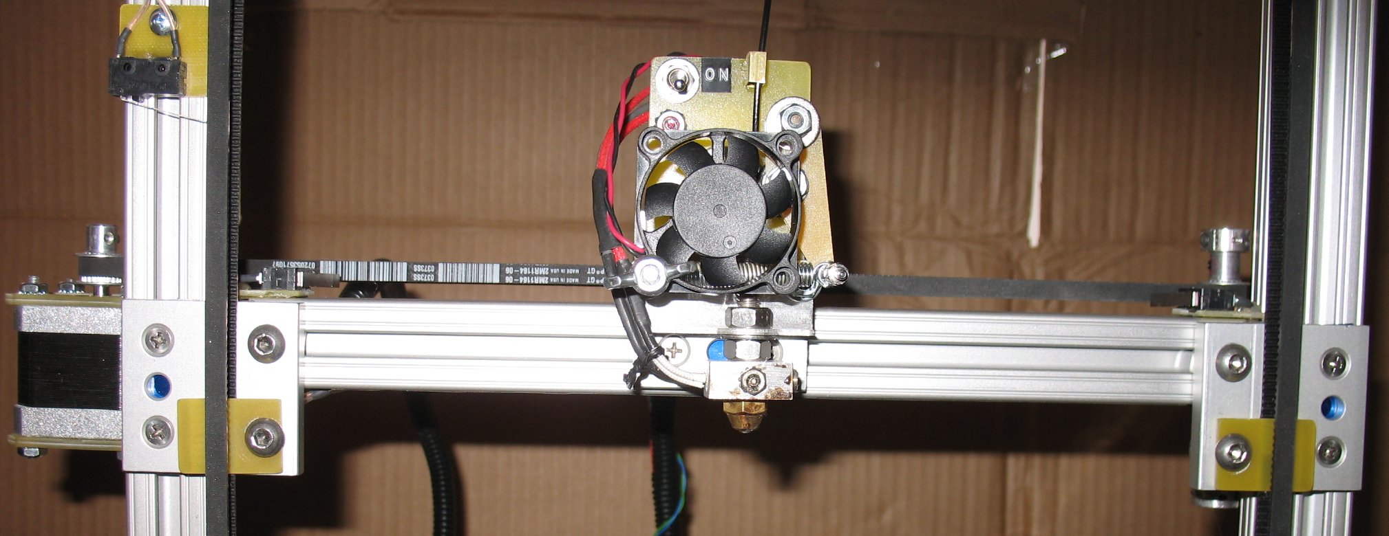

Left: The X axis
Right: X axis idler pulley rear view

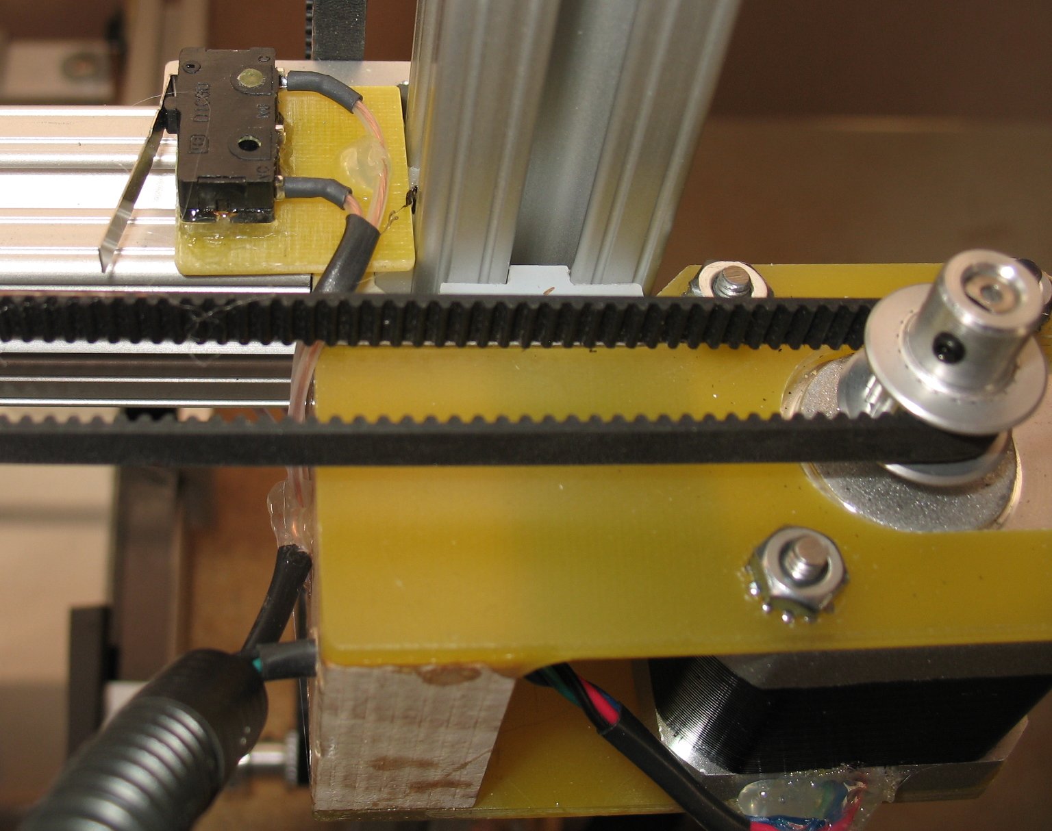

The X axis pulls a T-Slot linear bearing
The Extruder is connected to the X axis linear bearing

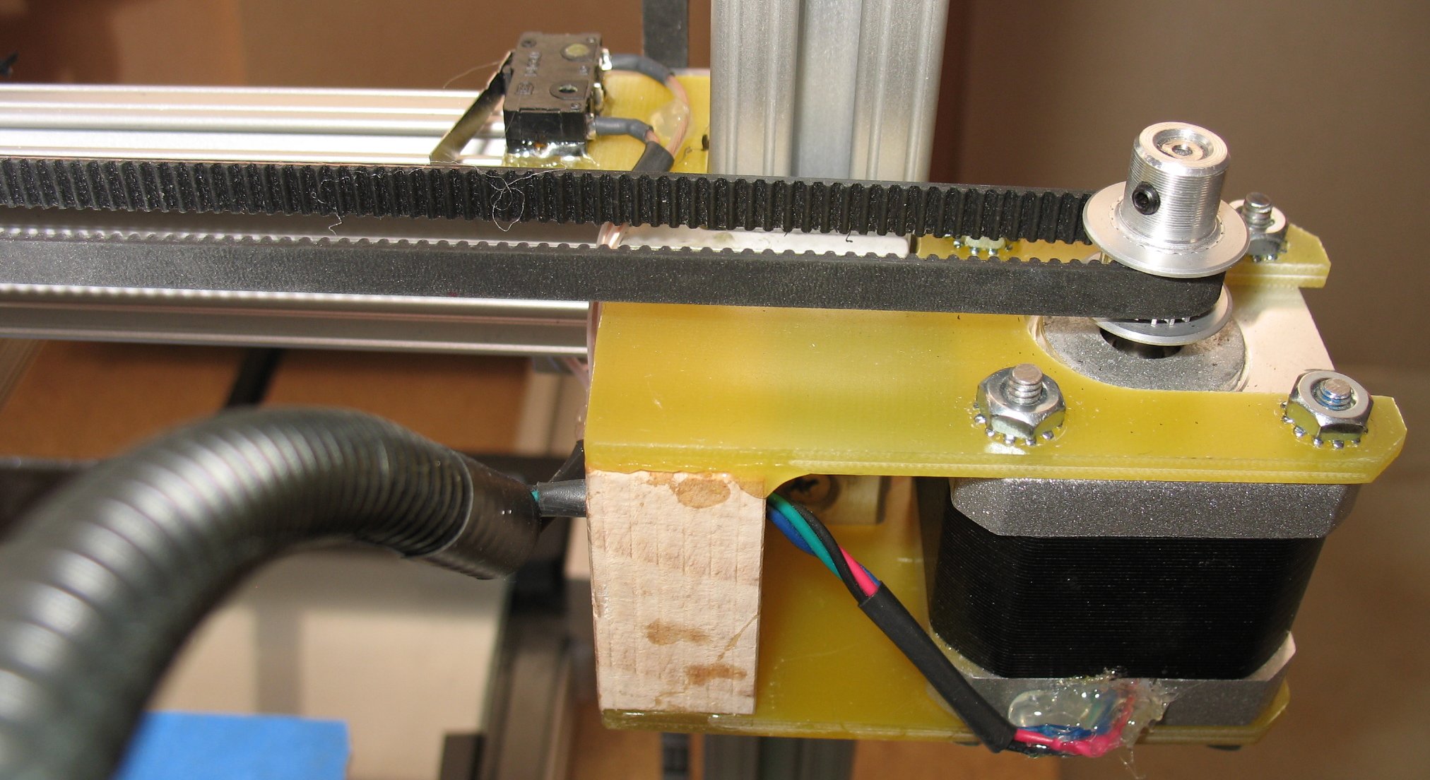

The X axis stepper motor
The motor brackets are made from G10 Garolite
The motor bracket screw holes are slotted so you can move the motor and set the belt tension
The motor bracket is epoxied onto the X axis linear bearings

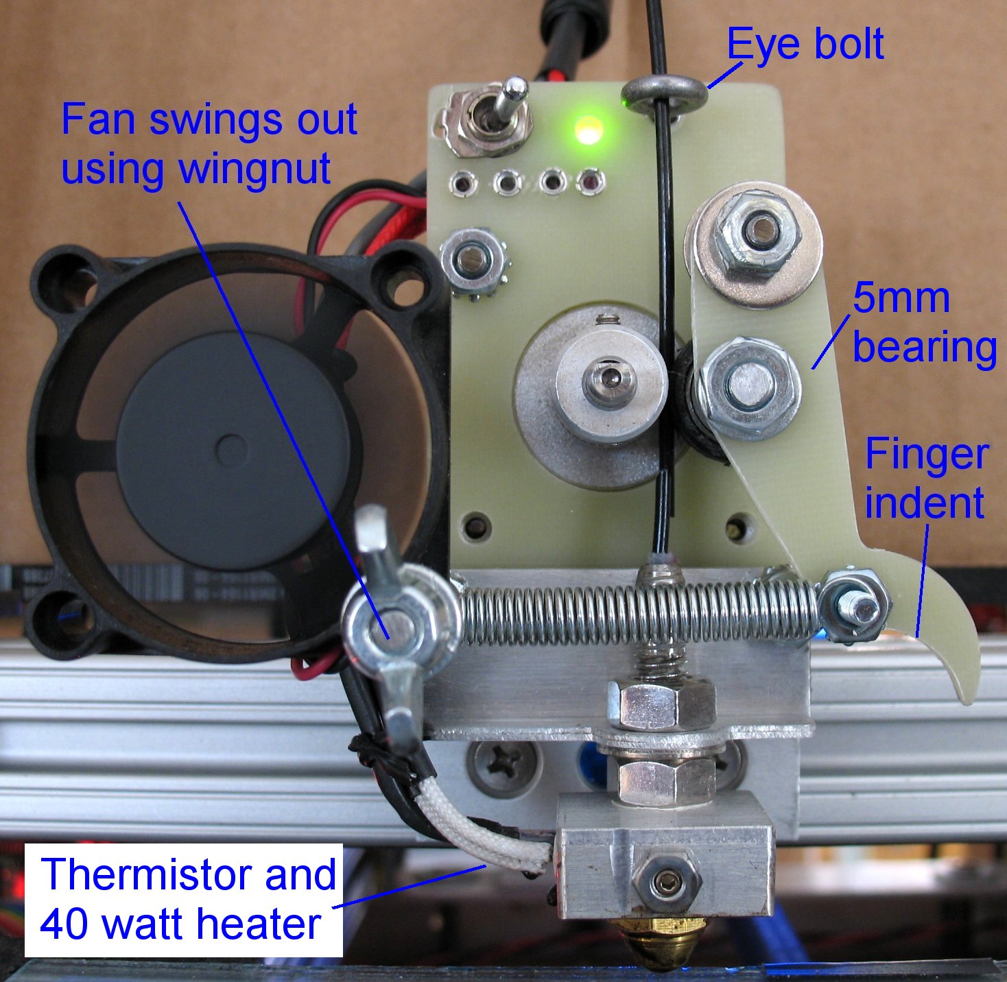

3D printer extruder  3D printer extruder

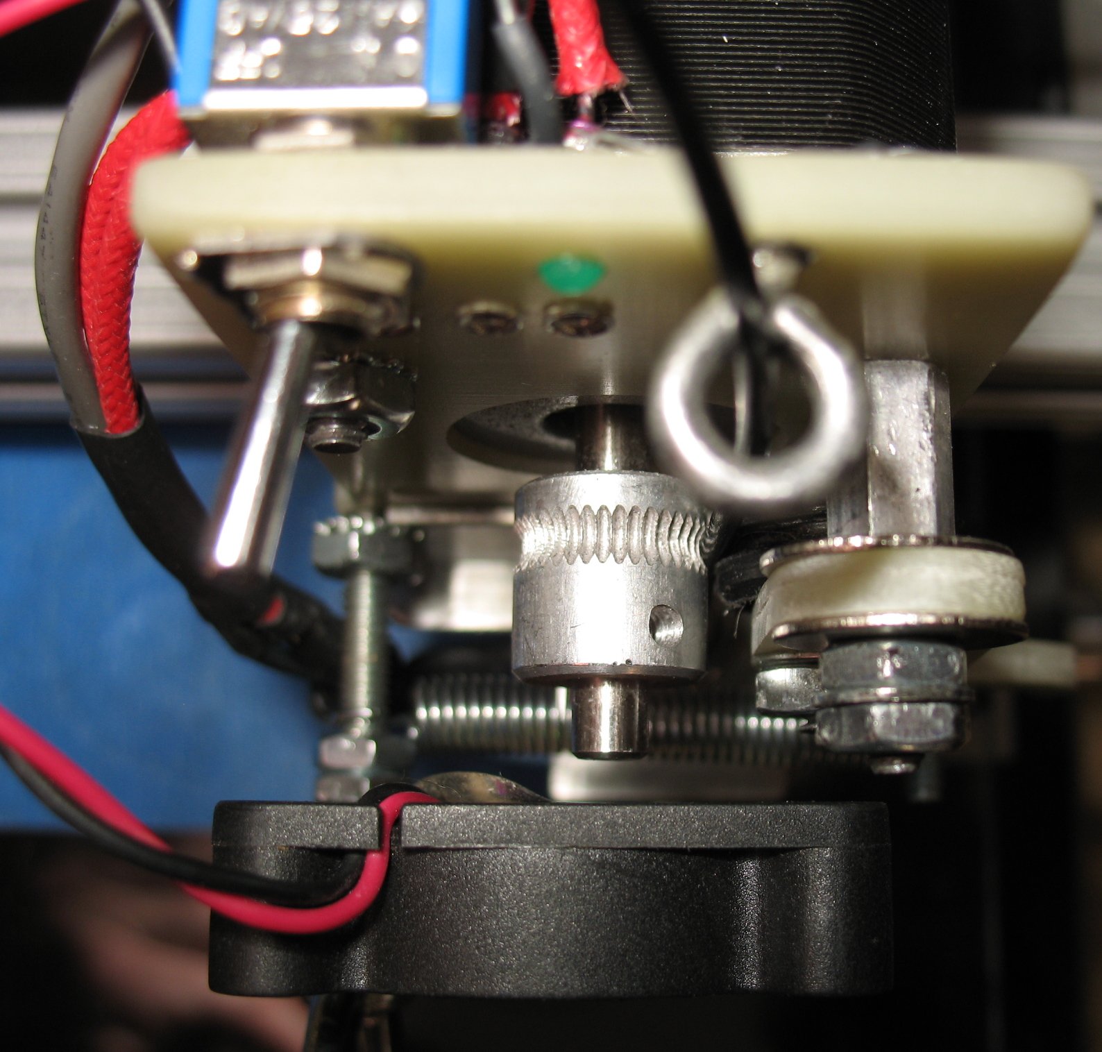

I made the extruder from scratch (See updated extruder info below)
I machined the filament gear on my CNC machine

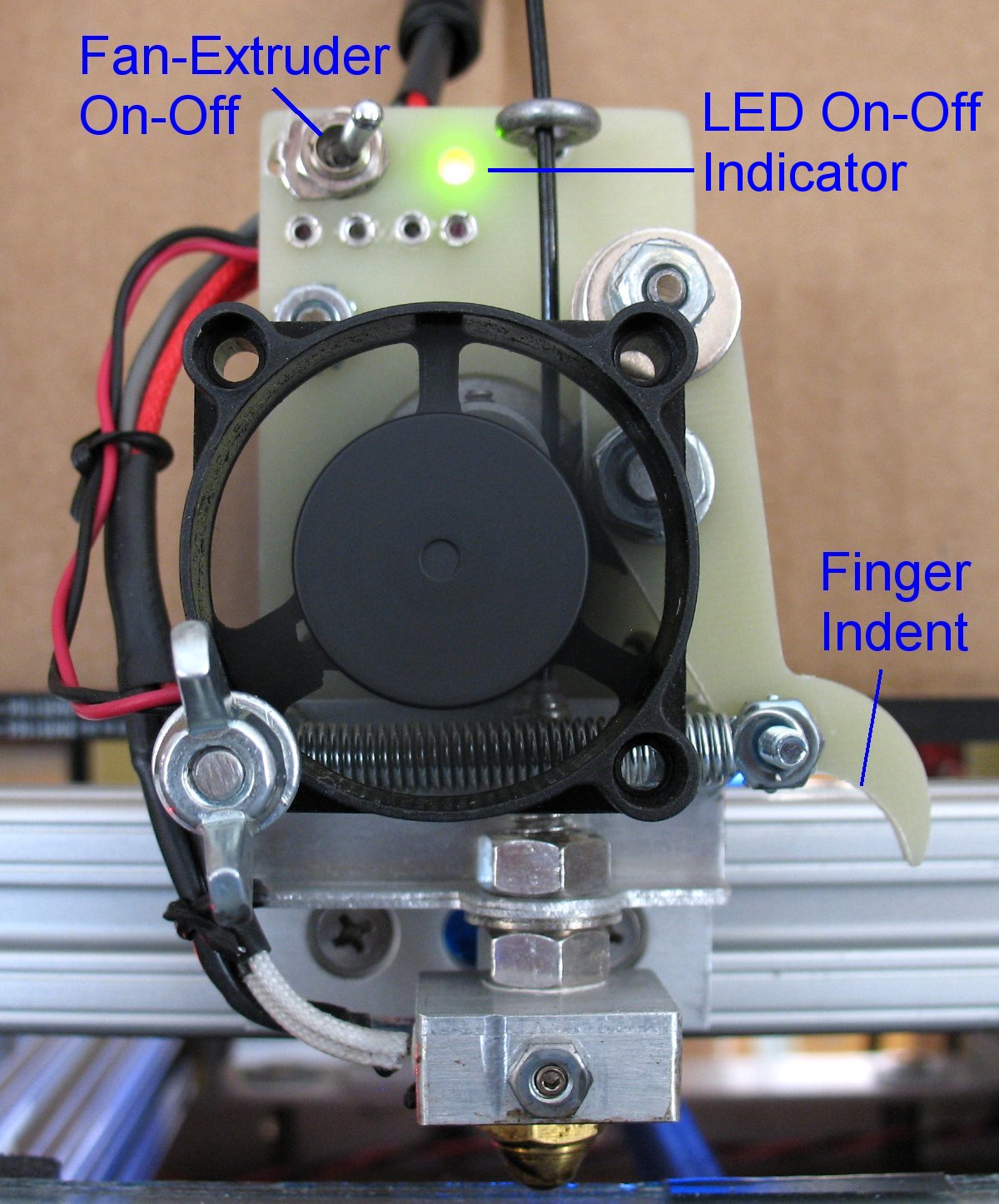

There is a spring loaded arm that forces the filament up against the gear
The spring loaded arm has a 5mm sealed bearing with a plastic grooved outer rim
I added a finger indent to make pulling the spring loaded arm out of the way to load filament

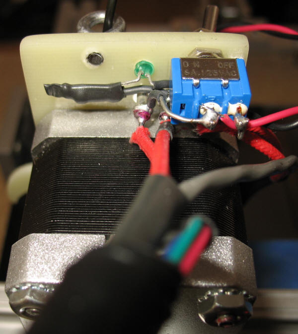

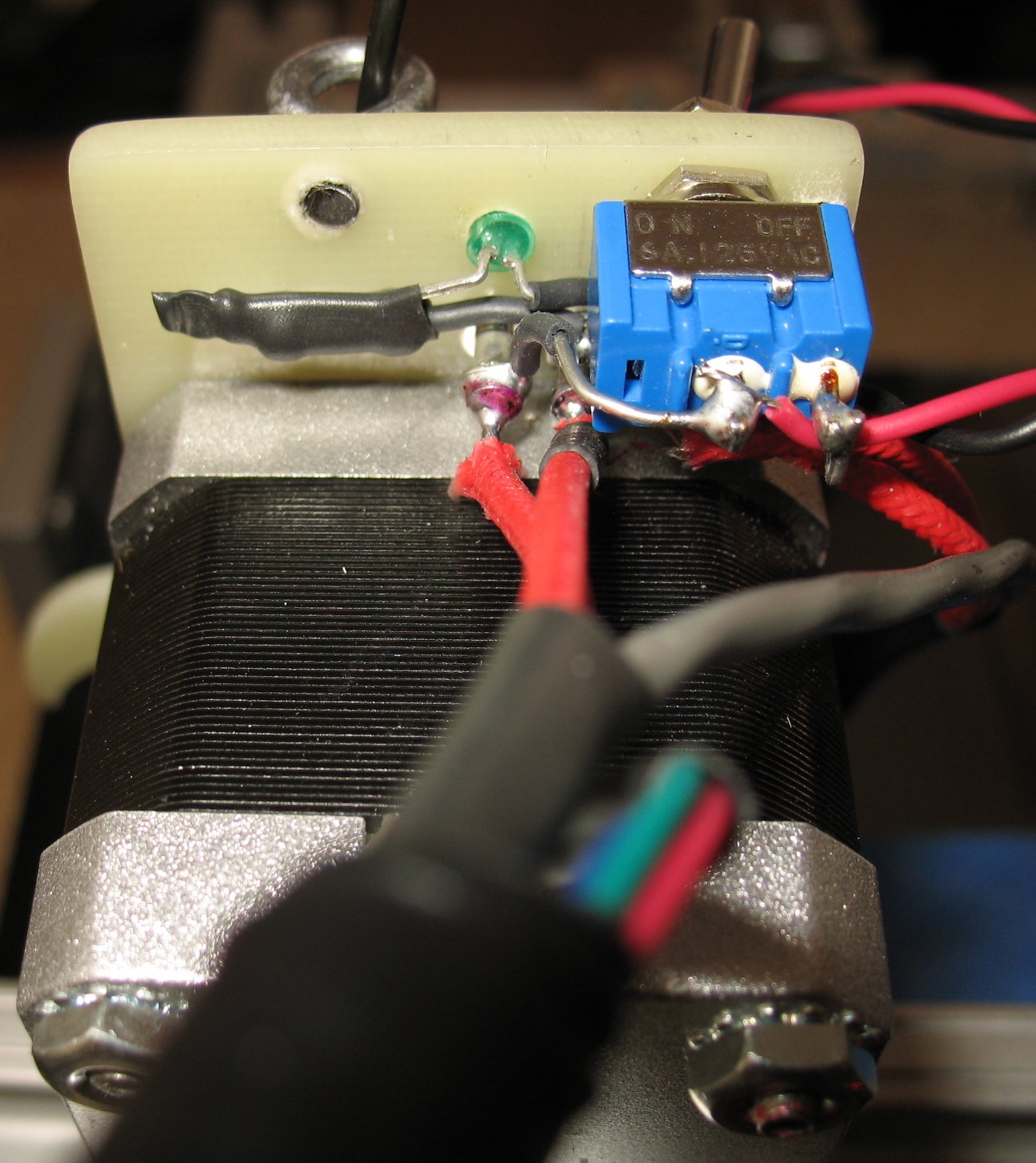

The switch at the top turns on the 40 watt cartridge heater and the fan
I added a LED to indicate when the extruder heater is on
I added an eye bolt that aligns the filament with the filament gear and idler rrm
The 40mm fan swings out of the way by loosening a wing nut
The fan cools the Stainless Steel delivery tube at the top end
The SS delivery tube has a PFTE sleeve inside to keep the filament from touching the insides of the SS tube
There is a thermistor on the hot end
A Gnex temp control board reads the thermistor on the hot end and keeps the temperature steady

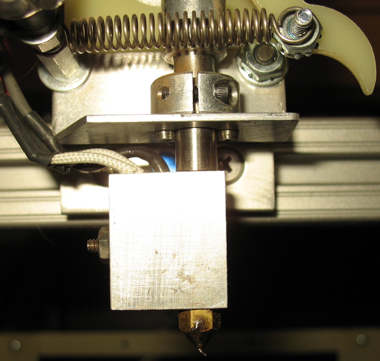

UPDATE:
I updated the extruder to a new design and it works really well
It has a vertical heater block with a stainless steel delivery tube
Inside the tube is a thick PFTE tube
The filament is protected from heat until it reaches the hot end
The 40 watt heater cartridge and Thermistor are inside the aluminum block
There is a set screw and a nut on the left side that clamps the heater cartridge in place
You can the wires on the left side of the stainless steel tube
The brass nozzle is a .39 Makerbot style nozzle

Right: Rear view of the extruder switches and LED

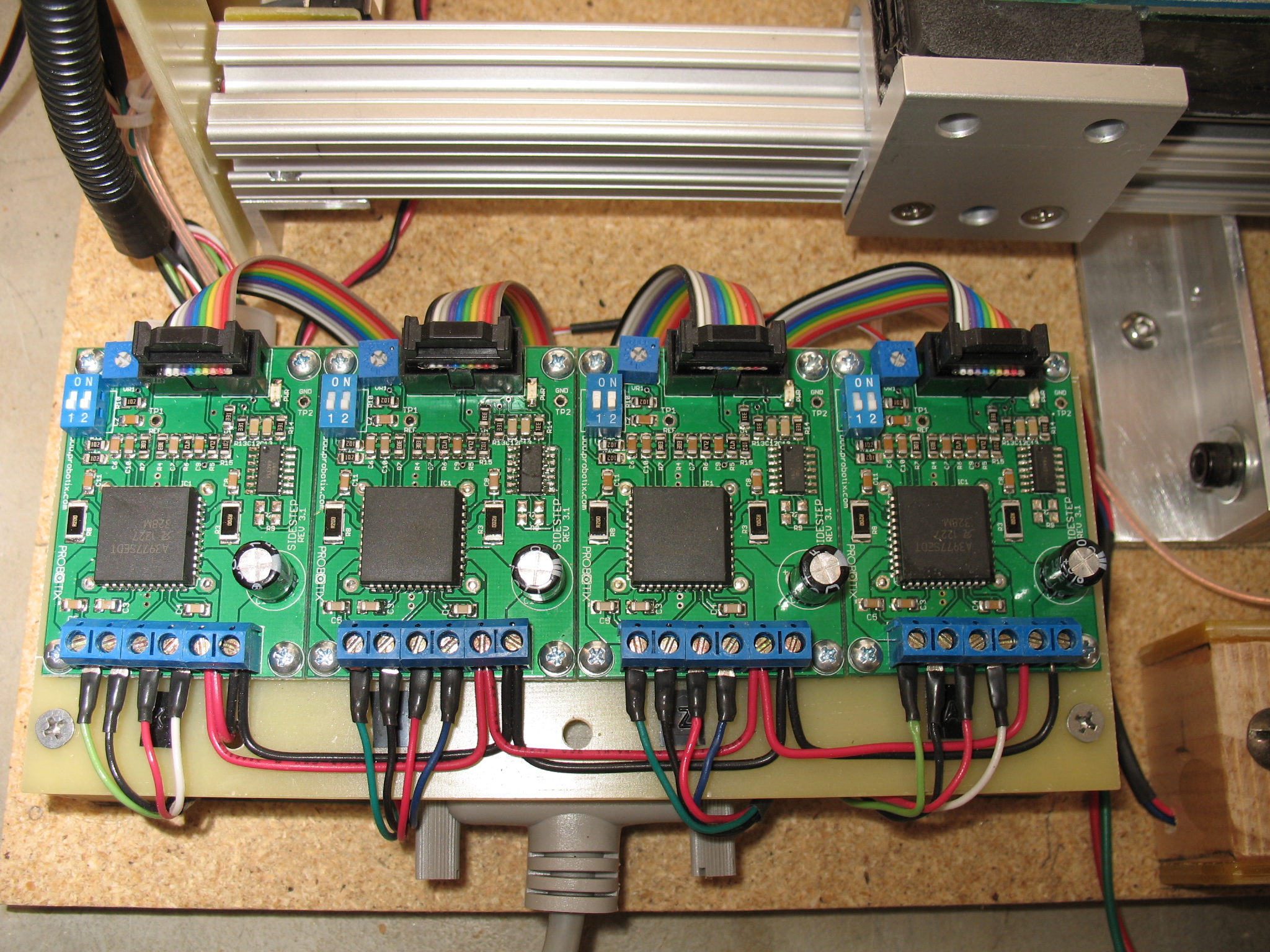

3d printer power supply 3d printer drivers

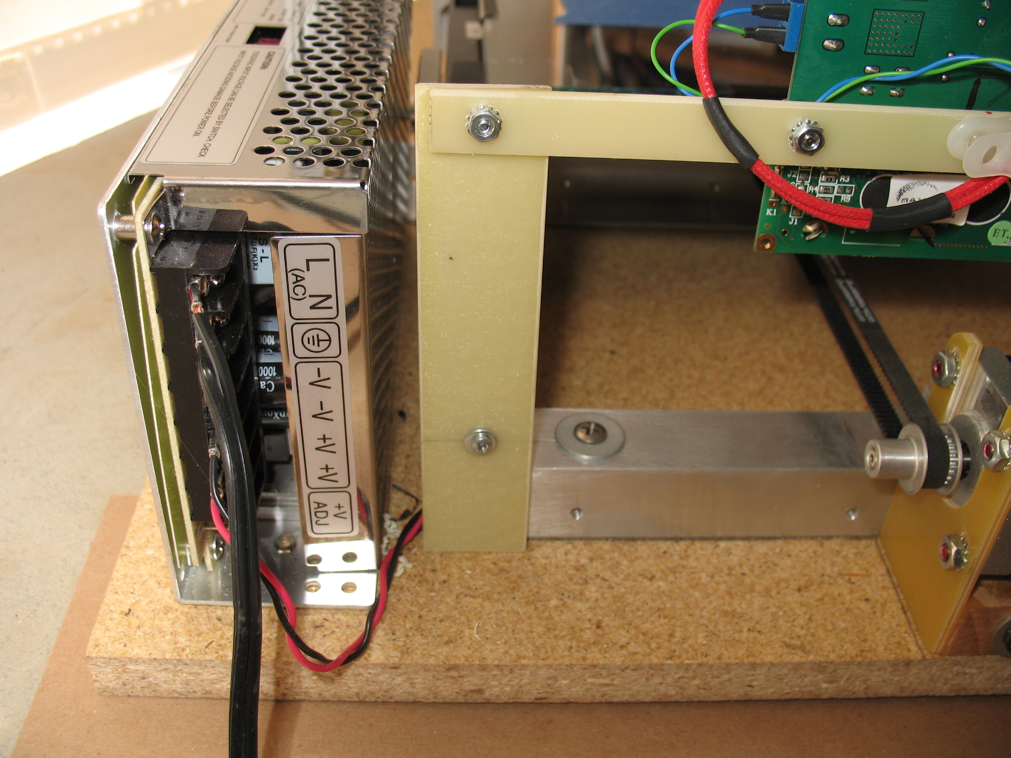

Left: The Probotix driver boards and power supply
Right: Probotix side step driver boards
Under the driver boards is a Probotix parallel port breakout board
Mach3 uses a parallel port to drive the motors and control items like spindles, cooling misters, etc.

Left: The Gnex dual temperature control board. This board can control the extruder and a bed heater

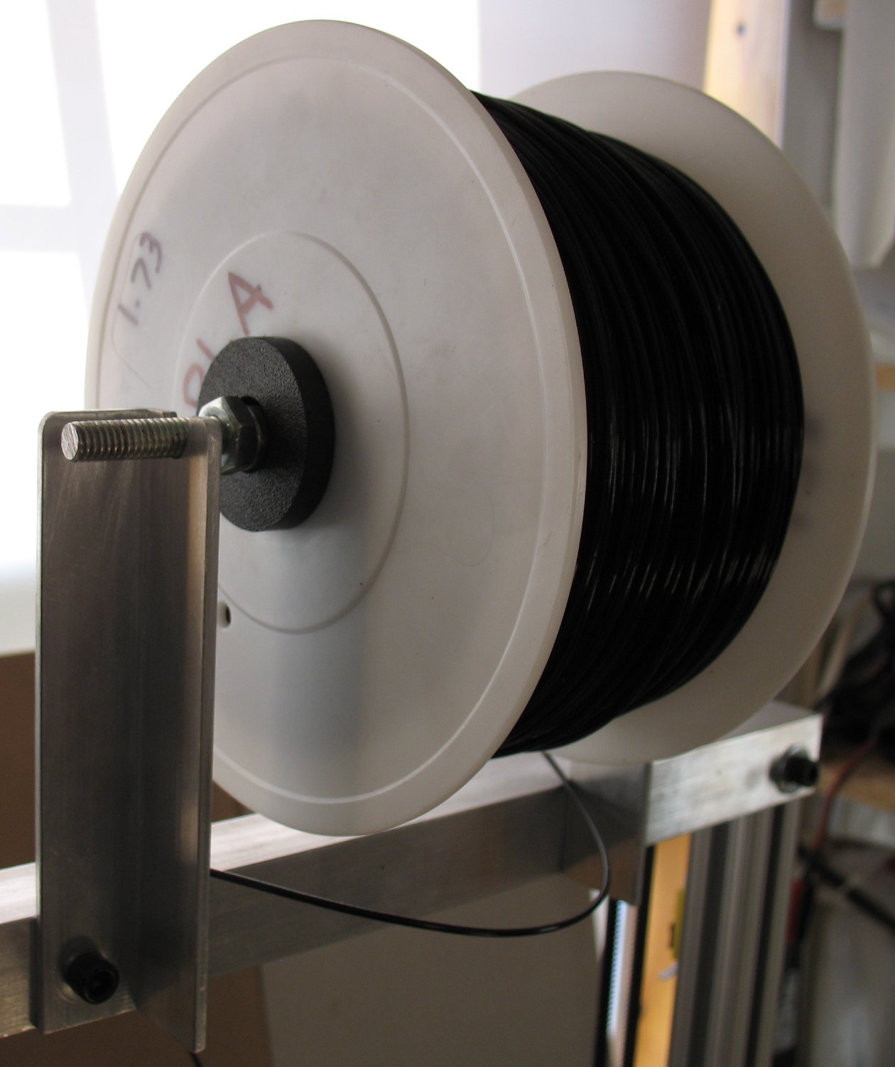

Right: The ball bearing mounted filament spool support
Inside there are two 1/4 inch sealed ball bearings so the spool turns very easily

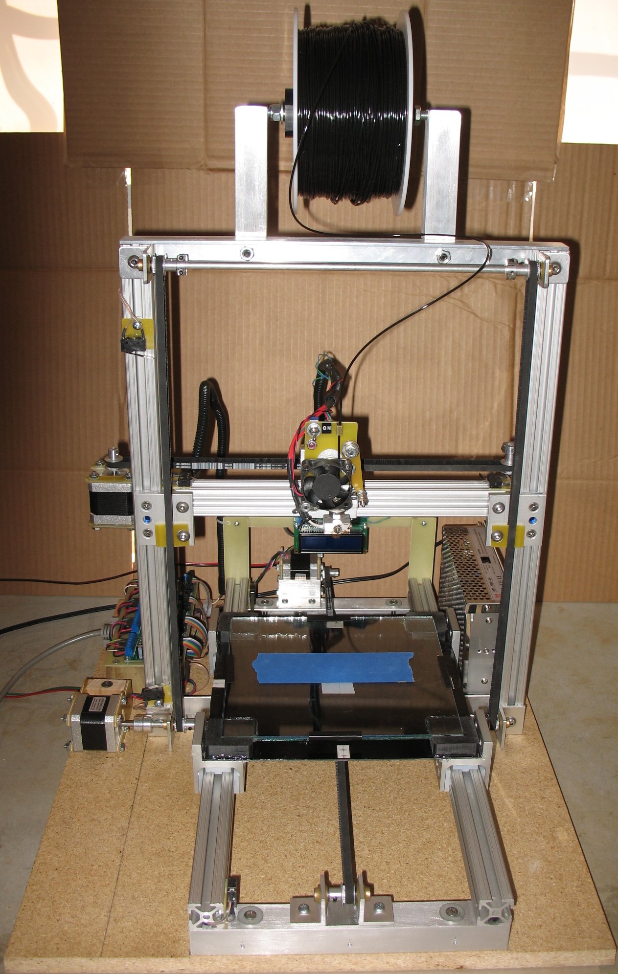

08/06/2013: Here are some up to date images of the printer
I will be offering this printer for sale as it is shown in the two images above

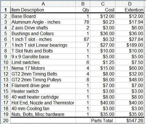

Here's a list of the parts I used and my cost
printer parts
