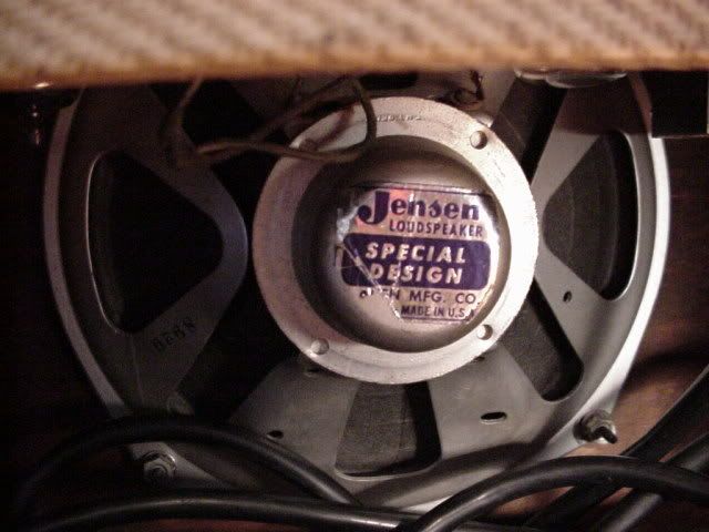

I just worked on a Gibson Skylark GA5T amp. Tube compliments is a 5Y3-12AX7- and the power tube is unknown. Looks like a 7199 / /6BQ5 but not sure. Not a 6V6 tube as i have seen on some GA5T model schematics. I can find nothing online that come close to this GA5T faceplate. The speaker code is 285416. Rola 6th week of 1941. I looked at the pots but no numbers stamped on the back. There are number on the side but they are so small i can not see them very well even with a magnifying glass. The wire is not cloth. I have seen amps that used the PVC wire in the early 60's but this cab and chassis looks much older. Brown bakelite chicken knobs
Have you seen this model Gibson Skylark and do you know the year it was made?

I'd say a ca. 1961 GA-5T with a replaced speaker. Tube complement should be 12AX7, 6BM8, 5Y3GT. A similar version was sold as the GA-1RT Maestro reverb unit.

Thanks FYL. I told the owner that the speaker probably was replaced long ago. It had a Craftsman two prong power cord on it from the 60's that has those fine lines on it. I tell ya it sounded like a dam 6V6 tube though with nice breakup.
I'm not so sure about that...  my guess on the code would be Rola 16th week of 1954.  Usually if those date codes are 3 digits they only have a 1 digit year code and you have to make an educated guess at the decade.  The Jensen Special Design sticker is interesting.  Possibly the original speaker was the Jensen and whoever replaced the speaker peeled and re-stuck the label.

A speaker made in 1941 would probably be a field coil speaker rather than a PM speaker. You missed the code conversion. Code 285416 converts to Rola, 16th week of '54 or '64. See below...
http://www.webervst.com/codes.html
or this pic...

Your right Steve. I have been doing all kinds of backward thinking latley. Ever take the band off the Bologna and throw the Bologna away and you find yourself standing there with the red band in your hand?
