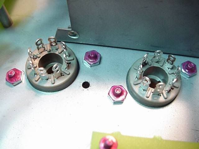

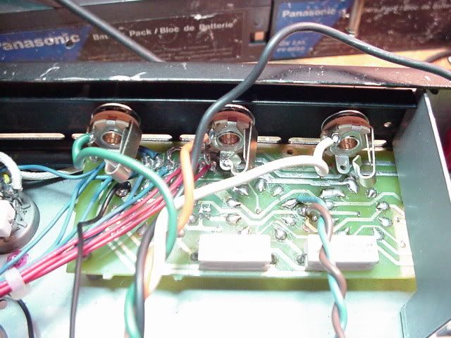

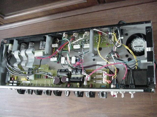

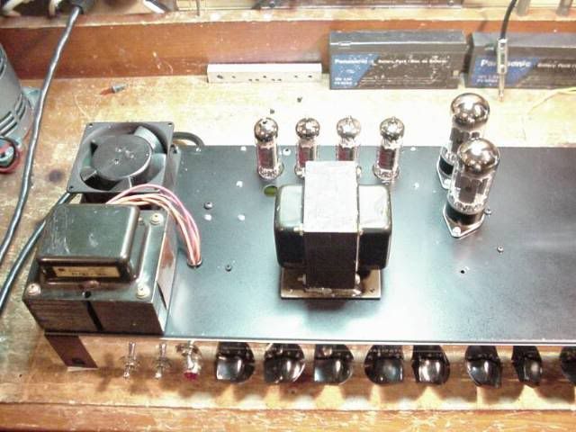

« on: December 16, 2011, 06:38:48 pm »

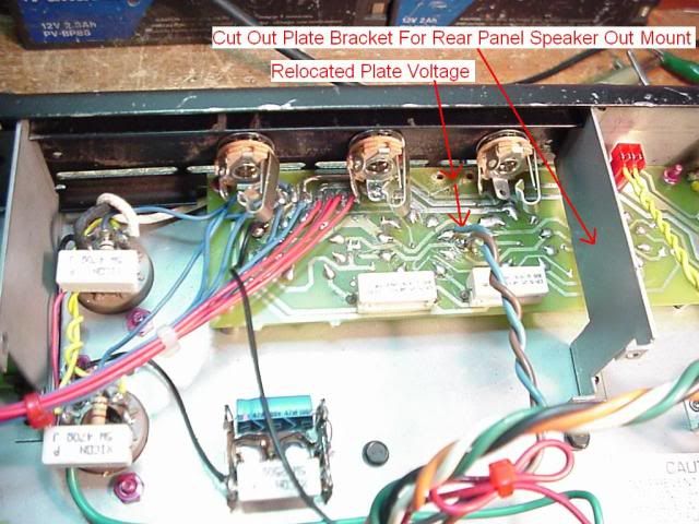

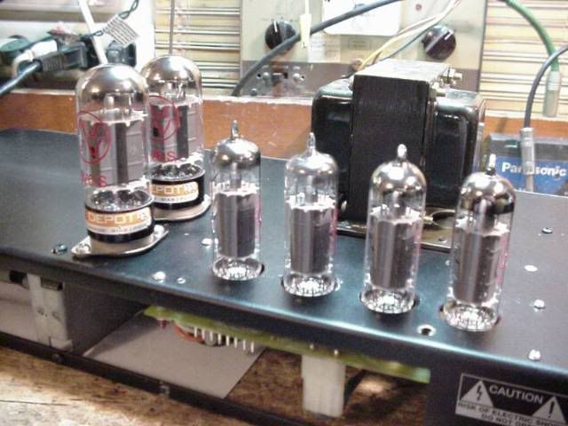

I dont like how peavey and some other manufactures mount the tubes horizontally inside the chassis. So after a lot of thinking and planning i made my move. I reversed the heater fuse and 100R screen resistors to the opposite side of the board to have access to them after remounting the board. I punched out the chassis for the EL84 power tubes and relocated the power tube board on aluminum standoffs. Then i thought i might as well put in a pair of octal sockets for some 6V6 tubes as well. I left the preamp tubes mounted as they were stock.  I have to wire up the 6V6 tubes and switch for switching between the EL84 and 6V6 power tubes.  I love 6V6 tubes and in think it will be a great addition. The original reason was to get the El84 tubes vertical and mounted on the chassis. The fan works but pulls in a lot of dust.  I found large balls of dust bunnies on the amp boards,power switches and transformers when i first opened up the amp
The first pic is the stock amp before going manic
« Last Edit: December 16, 2011, 07:33:19 pm by plexi50 »

NICE IDEA
that way you have fresher tubes & an option for a mix of tubes
how do you think to switch between tubes ? (or you mean swap tubes ?)
the hole for octal tubes looks absolutely perfectly done, what did you used to make it ?

I had to make a template of the power board using a piece of thin cardboard. I used a wet rag to dampen the top of the tube sockets and then pressed onto cardboard leaving a perfect print of the socket pins holes and center point of the tubes
I am going to switch the plate voltage from one set of tubes to the other using a heavy switch i have. I dont want the plate voltage on all power tubes at the same time drawing too much current and altering the transformer B+ to low
Nice tick
ok I can follow you, with the switch you swap B+ from a pair of el84 to a pair of 6v6
but what about filaments ? Does your PS has enough current for the two more tubes connected at the same time?

The heater filament voltage with all tubes light up is 6.0 VAC across pins 4&5.  It's close. I have to wire the plate switching tommorrow and will see what happens. I got the 6V6 cathode biasing finished today along with a few other wiring changes to make some space for the 4-8-16 ohm speaker jacks on the old power tube cover plate. Man im tired

To turn off the tubes.... Just lift the cathodes and the tubes will not draw any current. Except for the heaters. Are you sure the PT can handle the extra 900 ma's?

Yes, LooseChange is right, better to switch the low voltage cathodes than the high voltage plates
With a DPDT switch you can swap between a pair of el84 or a pair of 6v6
the unknown is if the PS can give the more current for the two added tubes
may be you must switch also heaters so when you connect a pair of 6v6 instead of a pair of el84 you save from the heater supply 620ma instead to have 900ma of higher consumption if the 6v6 tubes heaters are allways connected
Kagliostro

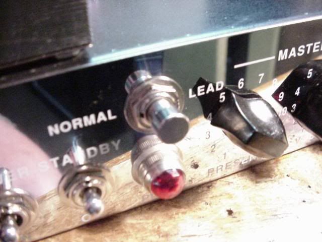

The one thing i didnt want to do was to drill any holes in the face plate.
have you considered to close a little portion of the big squared hole you have near the fuse in the back panel ?
the power tubes aren't more in that place so the hot air coming from preamp tubes will be much less than previously
which was your initial idea about placing the switch for swapping plates ?
a 3pdt switch will do the job with only one hole

I think you want to lift the cathode of the unused set of power tubes. Easy SPDT.
Don't just switch the OT to one sets plates or the other. Pretty sure it's not good to have voltage on the screens and nothing connected to the plates.
Also four EL84s and two 6V6s don't use the same load. If the amp has a multi-tap OT, plug the speaker(s) into the next higher output when using 6V6s.
EX: if the stock amp uses a 8 ohm load with four EL84s plug the speaker into the 16 ohm tap when using the two 6V6s.
(maybe use a DPDT switch instead of a SPDT switch, one side switches taps the other connects cathodes)
« Last Edit: December 18, 2011, 09:35:08 am by jeff »

I'm worried about the extra heater current. Wouldn't wanna blow the PT. What I would do is this: I'd pull two of the EL84s, plug the speaker into the next higher tap and use the switch to select two 6V6s or two EL84s(cathodes). If you're in a situation where you need four EL84s swap the speaker back put in the extra EL84s and take out the 6V6s.

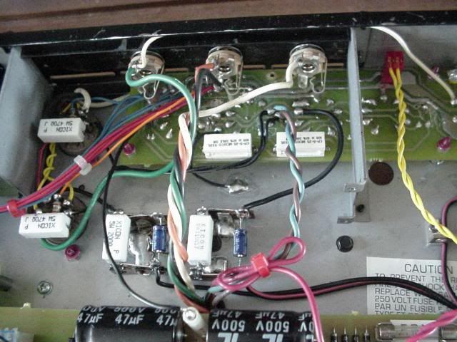

All good ideas and i thank you all for your input. It's all fun for sure. I relocated the plate supply as it was too close to the rear speaker output panel. I used my dremel to cut out the bracket that mounts and secures the rear panel where the power tubes used to be also securing the speaker out jacks. So far i think this has turned out real well. This is a great sounding amp with the El84's. I cant wait to hear the 6V6's. All that is left to do is wire the speaker common and put in that SPDT for the cathode lift's. I promise i wont be doing this again anytime in the near future. It's brain drain

I have the 6V6 tubes wiring  completed. I have a serious squeel as soon as i flip the standby switch. The El84's sound great as usual. OT polarity on the 6V6 tubes is not the issue. It's maginfying glass time

Figured out my problem. I could not use the cathode bias i was trying to use along with the fixed bias on the power board. Long story. What i need is a DPDT switch to lift the cathodes of the tubes to switch between them. Then use the other side of the DPDT switch and add a 10--20k resistor in series with the 33k bias resistor on the power board to bring the bias of the 6V6 tubes down about 3 ma. Other than that it is working wonderfully. The 6V6 tubes are unbelieveable. Fat and sweet sounding in this amp. Not muddy or breaking up too early. Has a nice full warm wood tone.  They breakup nicely. Im glad i did all this. The main point was to get the tubes out into the air and out from inside the chassis but it went far beyond that.  More pics tommorrow after i finish the DPDT switching
not able to figure it
why is necessary the switch in the bias path ? is not the same to add the resistor in the path feeding the 6v6 tubes without the use of a switch ?
I've difficulties if I don't see a schematic
please can you explain ?

I scrapped the cathode biasing and used fixed biasing for both sets of tubes

I put the Channel switch back where it was and put a small SPDT switch in between the power switches to lift the cathodes and switch between the EL84 & 6V6 power tubes. I had barley just enoungh room between the switches. Finished* I love this amp
