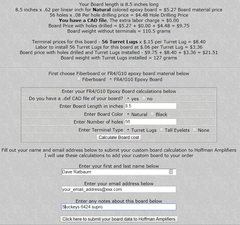

I just realized that I never posted a link to my Supro webpage. It's mostly the same info found in this thread, but in a more condensed and organized manner.
     http://sluckeyamps.com/supro/supro.htm

Re: Supro S6424 project
« Reply #113 on: August 14, 2017, 06:33:06 am »
My question is where might I put the effects loop?
That would have to go between the junction of the 270K channel mixing resistors and V2 pin 2. Whatever you do, be sure that V2 pin 2 has a resistance path to ground, maybe add a dedicated 1M grid leak resistor.

I have the drilling file already set up for this board
If anyone wants one, fill out the calculator program first here
http://hoffmanamps.com/php/PartsList/BoardPriceCalculator.php
Pick yes that you have a cad file so there will not be an extra charge
Pick the material type, color and terminal type
The board is 8.5 inches long
Fill out a note that says
Sluckeys 6424 Supro and I will know to use the drilling file I have already created
If you have other parts you need, go to my shopping cart and add a note to your order to add this custom board after you have filled out the board price calculator form
If you do not need any other parts, just email me to order the board after you have submitting the board price calculation form
Look at the screen shot below to see how I filled out the calculator form
« Last Edit: October 02, 2017, 09:26:17 am by EL34 »
