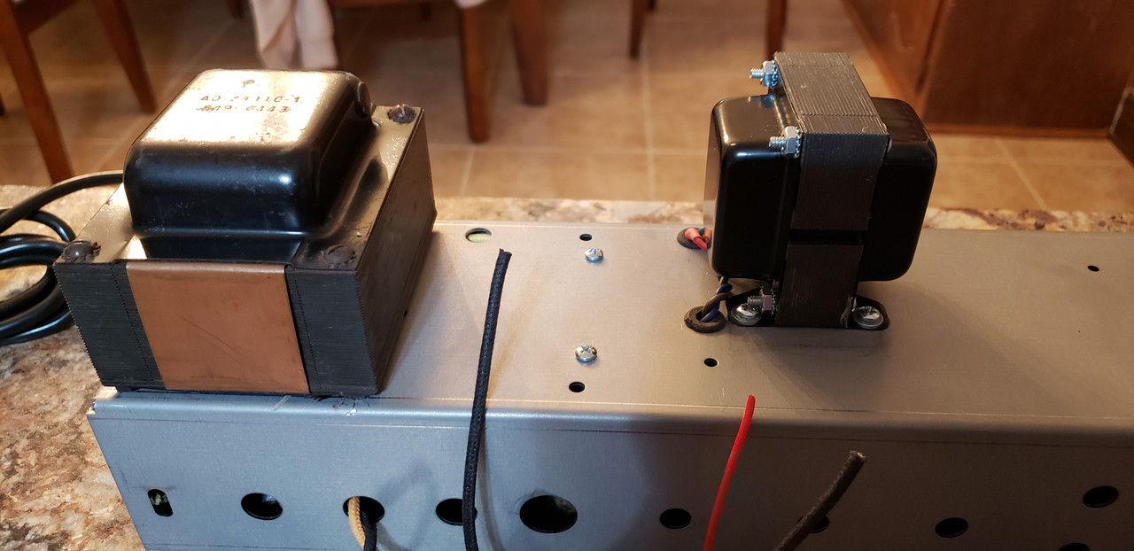

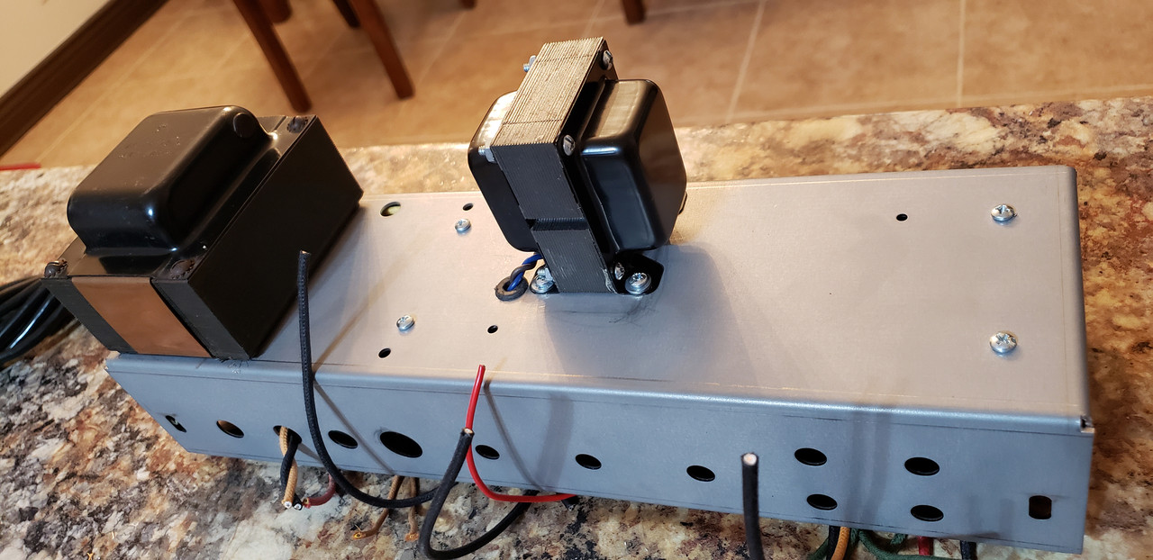

Any issues with the OT tranny?
I mean other than 1/2 the shell missing as a laydown unit and no mounting feet...LOL
I ordered shells cheap with mount feet to convert to a stand up unit...
  • Posts: 5377
Re: 5E3 Sluckyamps with AO-29 iron
« Reply #3 on: April 11, 2021, 06:32:36 am »
OT is fine, better than what came in the original. I'd like to see a pic of the OT with your new end bells.

It took a minute for the bells to arrive from China.

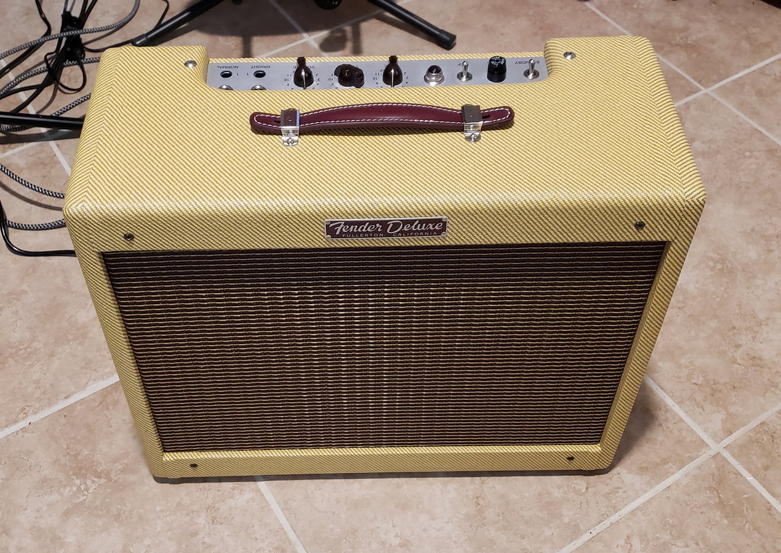

Here are the pics of the completed build.
