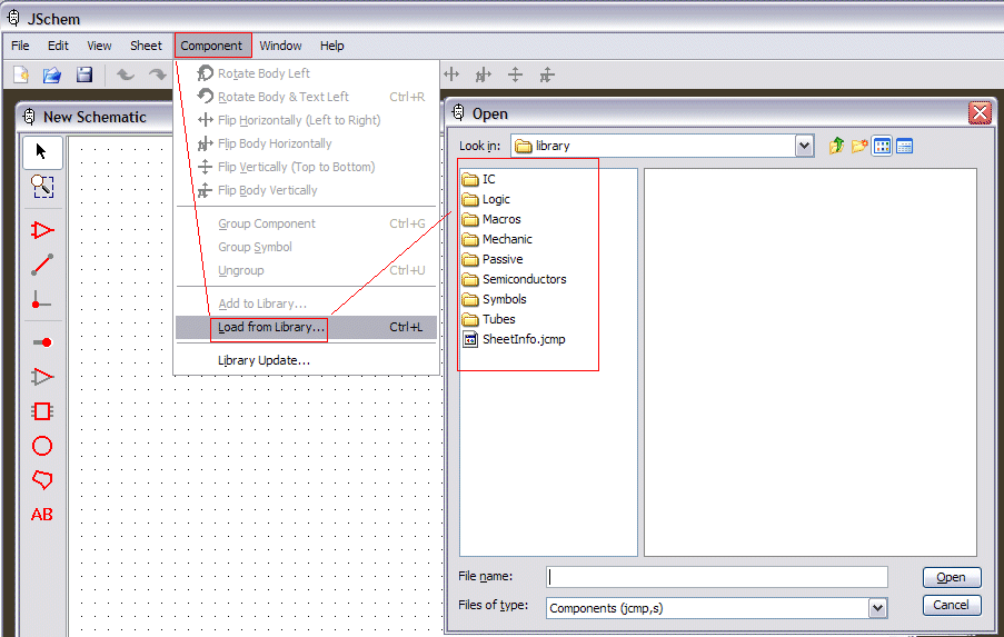

      [*]Activating the library tool (third button in left toolbar, with the red op-amp symbol) displays a combobox with the most recently inserted library components in the toolbar. Pick one from that box and place it in the schematic.
      I'm not getting a combo box. I can only place the last symbol.

      I am using OS X 10.4.10 with Java 1.5.0_07. This is what it looks like for me.
      You don't have that combobox?
      Is there a red flag in lower right corner? If yes, press it and send me the contents of the console window.

      Sorry Bernhard, now that you show me the picture, it is there. I was looking in the wrong place (or maybe the right place). In other programs, the menu would be adjacent to the button. Have a look at Photoshop and Illustrator. I don't know if this is possible in Java?

      « Reply #34 on: April 06, 2011, 02:46:37 pm »
      Hi Heinz
      Is there any way to import other components for the component library, once you are in the component library window? (I can figure out how to access other folders containing ExpressSCH component files from within the Component Library window - I just cant find where the .jschem folder is on my mac)
      Cheers
      Pete
      • Posts: 10672
      Re: JSchem can now import ExpressSCH files
      « Reply #35 on: April 07, 2011, 05:56:17 am »
      Component - Load from library - then browse
      « Last Edit: August 09, 2014, 12:04:17 pm by EL34 »
