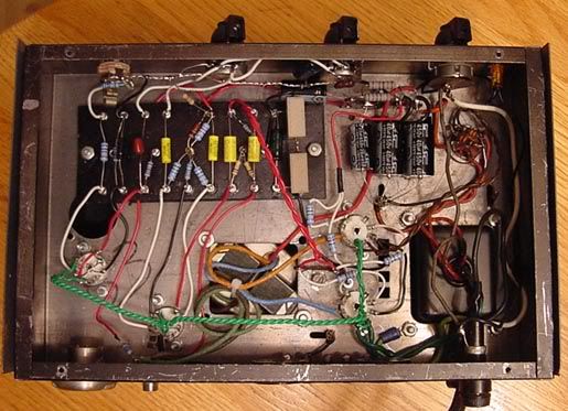

Well, my thread has already come to a fork in the road, so here's my old jalopy, a 1954 Rock-Ola jukebox amp. This project is completed, I think? Page 4 of this pdf shows the conversion schematic.

Yeah, really nice.
What have you got going with the pot and 2nd filter?  I couldn't figure out what "1540 with center tap" meant, either.
Weber was working on a field coil if you're interested, but that might take a while now.
So do you still think it might need 6SL7's?
You should start your own thread, by the way!
  • Posts: 5391
Re: Jalopy Amps.
« Reply #9 on: August 30, 2009, 03:24:15 pm »
It's not a pot. It's a 1540Ω power resistor with a fixed tap. Think of two 770Ω resistors connected in series. That's an original part. I decided to keep it. Here's a closer view.

« Reply #10 on: August 30, 2009, 05:08:32 pm »
Oh, yeah... I saw that in another pic.  I've got one like that in a radio I'm working on.  I should have remembered and recognized it on the schematic.

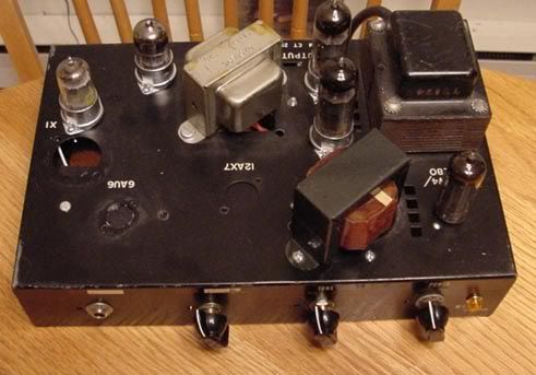

The Stromberg Carlson arrived.  It has a schematic.
http://www.sotxampco.com/Schematics/AU-57.pdf
Looks like the only existing Tom Foolery is the replacement of 1 volume pot and the mic jacks were changed to 1/4".  Interesting rectifiers.
The little RCA amp came in and it appears to be completely unmolested ..... yet.   :angel  I'm gonna reverse engineer it tonight.

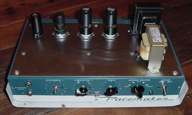

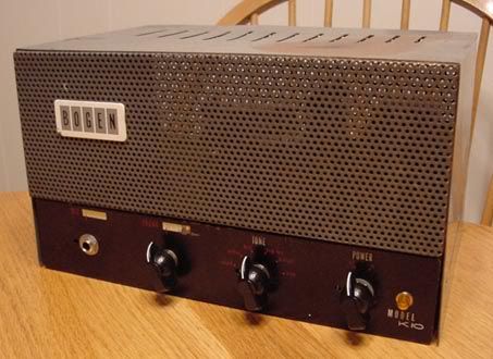

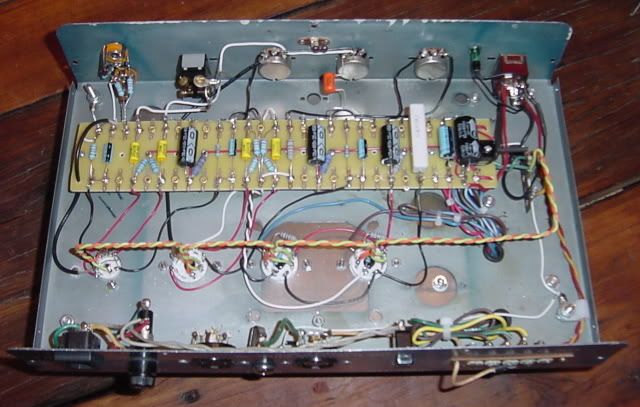

Here's a few that I've done..........
Bogen K10 flipped to a Matchless Spitfire>>>
Bell Sound "Pacemaker" flipped to a 5C3/5D3 hybrid type>>>

« Reply #22 on: September 05, 2009, 07:07:57 am »
geezer, you chopped up that k10 pretty good...  :laugh:  i just made changes as per PRR's recommendations and added tone stack & bastardized NFB . thought it sounded pretty good as mostly was.  :smiley:   very nice work.
your possesion of that amp brings up a question, do you still have the original OT? if yes, wanna sell it?  :angel
