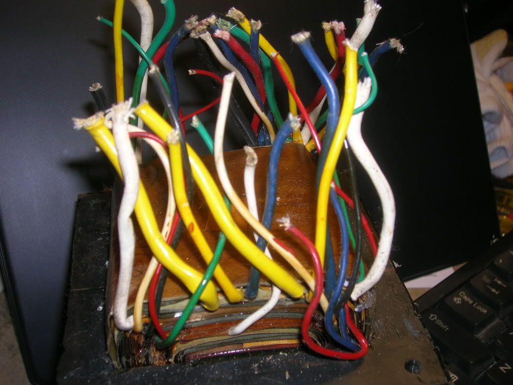

Re: Help Identifying Transformers
« Reply #14 on: October 03, 2010, 11:09:01 pm »
So dude, when you get the technique down, let me know when you're ready for this one....
 :laugh:
Offline stingray_65
  • Posts: 926
« Reply #15 on: October 03, 2010, 11:49:52 pm »
Now that's just silly!
It looks like Walt Disney drew a plat of spaghetti while trippin on acid  :icon_biggrin:
« Reply #16 on: October 04, 2010, 01:16:36 am »
Hahaha
It's a Tek 585 scope transformer. Fortunately, I knew this when I bought it, and the schematic is easily available on the net. However...the form factor for Tek transformers is usually all-enclosed, and all the wires would normally go to a mondo terminal plate where the terminals would be numbered per the dwg. Not so in this case, and, because the wires usually ARE enclosed & soldered to the terminal plate, there is NO PLACE where the color coding can be found.
However, you can see that the wire pairs enter the central winding at corresponding depths. In fact, all wire pairs do. And there aren't any goofy center taps on ANY winding. This wasn't really all that hard to figure out, though it would have been w/o the dwg. It took about 15 minutes to strip the ends of the wires, though, because they are double insulated with asbestos-weave on the inside, and of course I had to scrape off the formvar lacquer to make contact.
It has 8 (yes....eight!) 6.3 VAC windings. (16 wires)
It has a 15 V winding for a regulated heater supply and a 37 VAC winding for a fan (prob temp controlled) (4 wires)
It has 5 "B+" windings 110-150 volts each, some of which (when wired in the original scope...not here) are in series, some voltage doubled. (10 wires)
And of course a dual 120/240 primary (4 wires)
34 wires. No big deal, just another episode of "Married to my Workbench" from the "Time? What's That?" series of inspirational videos
