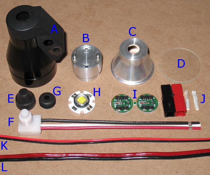

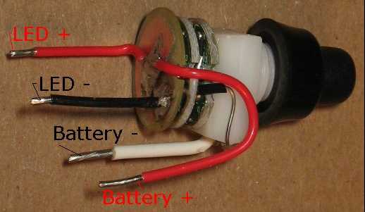

how does one dim a strip of LED's
Reduce the current, but I am not sure what components would be best to do that?
When I set up led's, I measure the current and set the current limit resistor so that I am running about 25ma per led
So a fixed resistor determines the brightness of my strips.
If you had a rheostat pot of the correct value and power rating, that would work in line with your fixed current limit resistor.
In my fancy bike lights, we use AMC7135 current limit chip boards
The AMC7135 chips have 3 legs and can control up to 350ma of current.
One leg controls the flow of current
The fancy driver boards use pulse width modulation to control the AMC7135 chip pin
So turing the chip on and off at different rates can create different current levels through the chip.
Some of the solid state guys may know of some other way to do this.
BTW, in my automobile LED lights I am operating 3.6 volt leds on 12 volts so you put 3 LEd's in series which is 10.8 volts
Then you just need to drop 12v - 10.8v = 1.2 volts across your current limit resistor which comes out to 48 ohms per set of 3 led's
