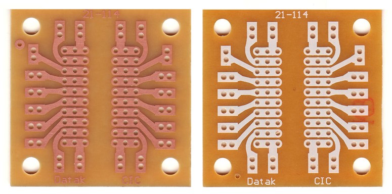

So obviously...working on a few projects at once. I have my 30 watt with reverb working great. But i am not happy with my build. The chassis is 17" x 10" x 3". So its huge. I found a 13.5' x 5" x 2" and I thought I might try and make it fit in their. My wire leads are too long in the current housing. I have a perf board with reverb components installed. Its messy. And its just bothering me way to much. You guys know ive been working on this design for many months so I cant leave something if it bugs me.
So what I would like to do is....consolidate my layout a bit. Now I dont know how I will do it yet because I cant put an IC socket on turrets (my reverb is solid state) but I do have a few ideas. And I hate perf board. So I want to put my reverb components on my circuit board. I will have my few and small power supply components on a separate board just under my original power supply (shown in photo). What I am still learning is (and Im paranoid about this) noise caused by lead dress and incorrect layout. I just want some opinions on this idea. If it could yield any noise where I plan to land the reverb. I do plan to send the +VCC and -VCC on the outside of the chassis and come in just under the reverb section of the board.
Which kind of IC do you refer ?
if you refer to 3 legs TO220 ...
For other IC you can use a PCB like this
http://www.smcelectronics.com/perf.htm

Hey thanks. Thats a cool idea. The IC I use is an 8 terminal TL072 or a 4560.

Those PCB can be a solution
but if you are able to build your own, you can add turret as wire connection points
like in Doug's Relays PCB
Offline hesamadman
