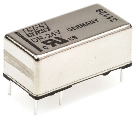

I do have another question; Can someone tell me if in the JSX, does K4 bypass diodes D1 & D2? Or does it bypass C63?
