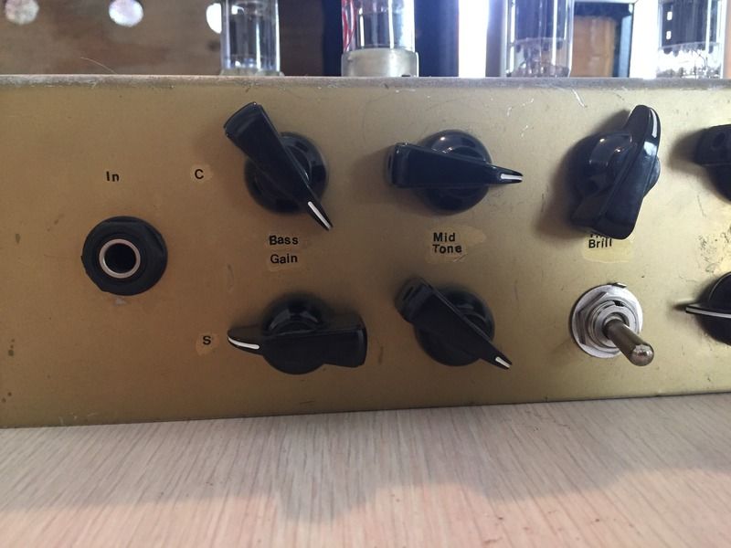

Tubenit,
Once more, my I ask for your assistance?
Today I fired up the amp.
I applied 5U4G rectifier. After that I've got 393VDC. I intend to stay with this voltage. I do not need the amp power beyond that voltage.
Second thing is next nodes voltages, which  are nod C approx.348V, nod D(after swapping res.for 1K) 345V and nod E 343V.
Then I have approx.197V on OD stage after the plates resistors and approx.135V pin 1 and 190V pin 6 on V1.
Do you thing I could stay with them or shall I change/lower the nod C resistor to increase voltage on the next ones?
The next issue is I think I should replace the OD pots of 250K for lower ones as you seggested.
At least Ratio pot supposed to be swapped.
What do you think about it?
Thank you in advance,

  • Posts: 10328
Re: Geezer's TMB-trim boost relay
« Reply #16 on: February 05, 2016, 06:04:02 pm »
I don't pay a lot of attention to the voltages on the plates of 12AX7's.  I want them somewhere between 160v and 200v overall.  I want higher voltages for a clean tone on V1.
To me the issue is how does the amp sound?  Do you like the tone?   If so, leave it alone.
I'd change trim pot to 100ka and leave the others as you have and play it for a while like 2 weeks and then see if you want to change anything.
With respect, tubenit
Offline adamG
  • Posts: 246
« Reply #17 on: February 05, 2016, 06:24:32 pm »
Yes,that's the main thing the sound.
I do not like the OD sound.It is fuzzy therefore funny.
The Ratio pot must stay on very low position to keep resonable amp volume balance between clean and OD stages.But then satisfactory gain is missing.
I feel that all of the three pots trim-drive-ratio must operate on same volume.Can you agree?
To increase V1 voltages, I'll swap its plates resistors.Is it a proper solution?
Thank you!
Adam

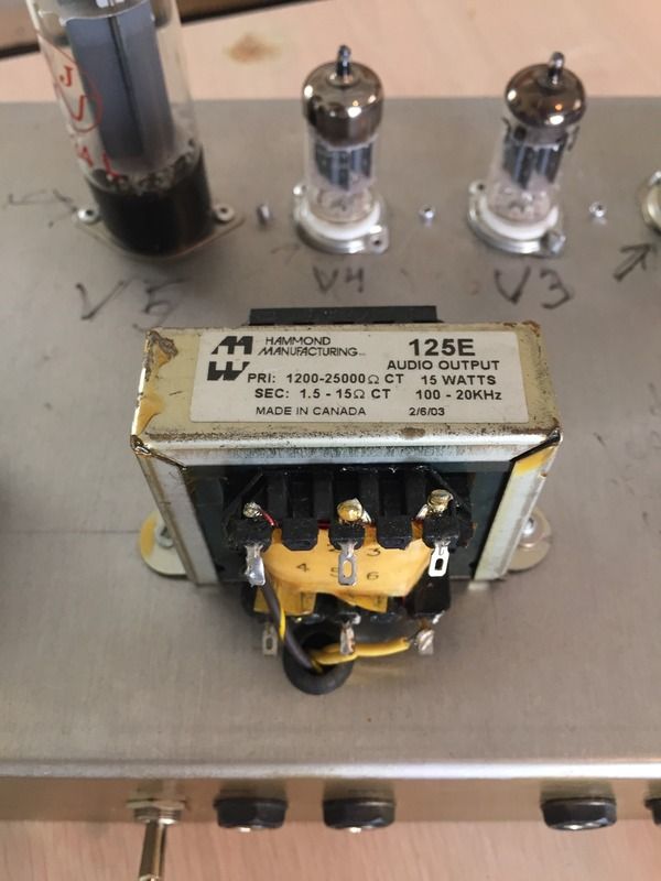

Offline adamG
  • Posts: 246
« Reply #18 on: February 05, 2016, 06:33:57 pm »
I also applied DPDT switch for Full/Half output power.
I've noticed hum on Half position. Fortunately,on Full position it is gone.
What would be the reason?
Maybe with cathode biasing it is not applicable?!
  • Posts: 10328
« Reply #19 on: February 05, 2016, 08:05:01 pm »
OK, I checked my Tweed BluezMeister.  I have around 180-190v range on preamp plates using 12AX7 tubes.  Using 5751 or 12AY7 tubes will give you much lower plate voltages.   Other then changing your trim pot to a 100ka, I think it's fine leaving the other pots alone.
Regarding getting a smooth OD tone.  Try a 12AY7 (or 5751) in V1 position which will allow for a nice clean tone and help cut down "grit/fuzz" on the OD channel.   Of course the type of caps you're using and the speaker make a difference also.  Lots of factors involved in getting a smooth overdrive.  The smoothing caps on the OD channel are important.
Be sure to use the "enhance cap" across the entrance plate on the LTPI. It helps a lot in cutting out the high end harshness and smoothing the high frequency without losing the high frequency.  (see the schematic I posted earlier of my TBM)
Most of the time I have a 12AY7 in V1 and a 5751 in V2 overdrive.  I have a 12AX7 in the LTPI and usually use 6L6's but also 6V6's.

Hi guys,
I returned to this thread after several month, because as Tubenit said:"leave this amp for a couple weeks"
So ,I did it for more than half of the year.
Today I know this amp ,with some tweaks meanwhile, is fucking great  :m11
I really do not know what happened to my ears previously ,but the amp is a kind of desire of every guitar player.
Thank you Geezer, thank you Tubenit!!!

adamG,
You did a FANTASTIC job with that amp!  What a beautiful build and waaaayyyyy neater then mine.  I am glad you are enjoying it.
 :thumbsup: :thumbsup: :thumbsup:
This is the only amp I've ever built that has gone yrs with NO tweaking at all.  I can't think of anything that I want changed on mine?
I appreciate your sharing the photos and giving us an update.  Very nice of you to do that!

You know I really like this forum. It is not as big ,famous as ampgarage, but I feel this place as my hobby home;)
With this amp I can put it on every speaker cabinet with proud.
I am proud ,because I made just everything, which is chassis, boards, tranies, cabinet, etc. Finally, It works fine. Usually, men judge that transformers must be made by profesional producers. I think ,they must not. Those two, November and Bluezmeister might be the evidence:)
Sluckey, you may believe me that this amp is not only nice looking amp, if so. It is great sounding one.
You remember, I built November 18 acc.to your schematic and layout. That amp is also great.
I think to myself, maybe I reap the fruits of labor ?! Anyway, things get better;)
