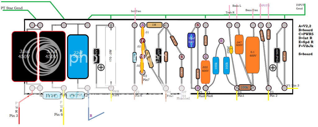

Here is a layout draft. Is the FX Loop implemented properly?

Which schematic did you wind up using?
It is always helpful if you post the schematic along side of your layout.
One other suggestion I would have would be to use the same colored wires throughout your layout to represent plate, grid and cathode connections, if possible.
It makes things easier to trace. Some of us carry out that same concept throughout our build and I tend to use red for plates, white for grids and black for grounds.
The actual colors don't matter but sometimes just the fact that things are colored in a uniform fashion makes finding a mistake easier.
Once we see the schematic we can then determine if your effects loop is implemented properly.
-Did you really intend to switch between a 10K or 12K cathode resistor on the second stage?
-Did you intend to connect the plate to the grid on the second preamp tube?
Im voice typing on my cell phone, so that's all Ive got for now but hopefully this will help you get some help.

Thanks for the reply. I used tubenit痴 schematic from above (Dirty Princeton Fx) with a couple of small mods. One of this is using a 12k bias resistor with a .68 bypass cap on the higher gain setting from the switch instead of 2.7k. The 12k with the cap still gives more gain than the 10k with no bypass cap. I did mean to connect the plate to grid on V2 as it is the cathode follower/tone stack driver. I believe that I followed the schematic correctly in my loop layout, but not 100%. Am also not sure about the switch to activate/deactivate the loop. I just used a simple SPDT switch. Would there need to be a mixing resistor involved between the loop and the LTPI?
Thanks!!

Ok, I scanned over your FX layout and it looks good. It has been brought to our attention recently that we might want to be using a 25K pot for the send so as to retain the low output impedance of the cathode follower, so there's that.
You're missing the 120P cap from grid to ground on the recovery....intentional mod?
The reason I asked about the connection of plate to grid on the second preamp tube (V2) was to get you to look at it harder. It's perfectly fine to make that connection, but the plate supply marked "X" shouldn't be going to your ground bus. See attached for where to move it.
I didn't have time to check the whole thing over, but I would still suggest modifying tubenit's schematic so that it matches your plan. This way, the guys won't have to guess what your thinking.
I like the plan.
I don't have time to review the FX switching but it doesn't look right to me. I have used the DPDT relay that Doug sells to perform this function and there is plenty of info on the boards about implementing a switchable loop. I'd go back over your idea.
There doesn't need to be a mixing resistor added to T's schematic, it works as shown. It is drawn so that (if you use a switch) it gets placed in series with the signal when it is switched in, and removed from the signal path when off.
So, you need to switch FX{open-closed}FX and FX2{open-closed}FX2....there could be another way, but that's the way I've done it.

For the V2 cathode follower hookup there is a simpler (very common) method of bringing the B+ supply over to the tube at pin 6 (X).
Then connect the 100K plate resistor right across the socket to pin 1 and tie that over to pin 7.

So, I was going back over this because I was going to suggest that you use at least one grid stopper and I noticed that you do show a 470K grid stopper on your layout (see attached).
The problem with that is that it doesn't match T's schematic and that is a big problem because it was designed to be a voltage divider in conjunction with the 470K that is going to ground. By moving the resistors around you have eliminated the voltage divider function.
All Resistors Matter.

You need a ground connection here:
Good call, yes it does eliminate the voltage dividing function. I will fix that. Nice catch. I should have noted the ground on that pair of 220k resistors.

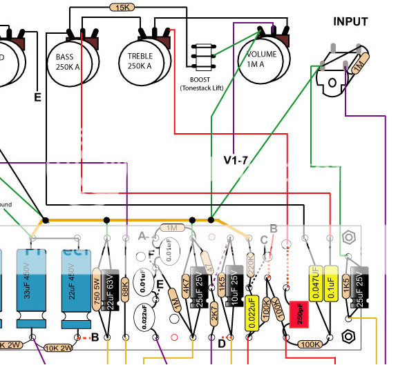

OK, I had five minutes to update the layout based on all of y'all's excellent feedback. Check it out if you want!

Here's a fixed-bias version (attempt). Notice any errors?
I also switched over to Cliff Jacks (I wanted to insulate the jacks).
