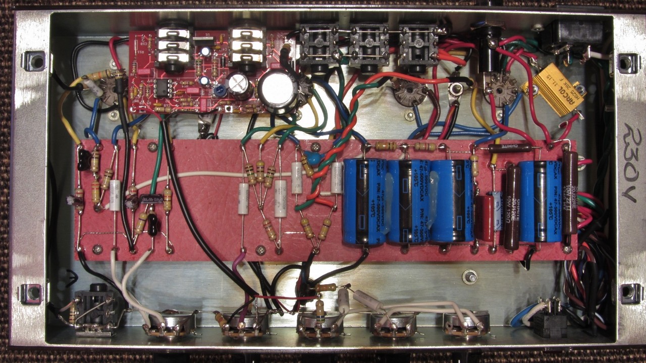

I recently built a Pink Taco, massive gain & super loud for a 2xEL84 amp. I did find a schematic and verified all I could from a bunch of pictures I found...
Any idea what the big gold chassis mount 20k 25W resistor is doing? https://www.musiker-board.de/media/pink-taco-pt20-guts-1-1280x719.24818/full
I think it lowers the voltage being supplied to the effects loop. ?

Thanks, that makes sense, given the opamp on the fx loop board  :icon_biggrin:
