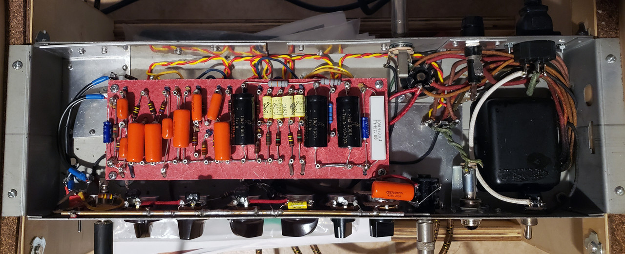

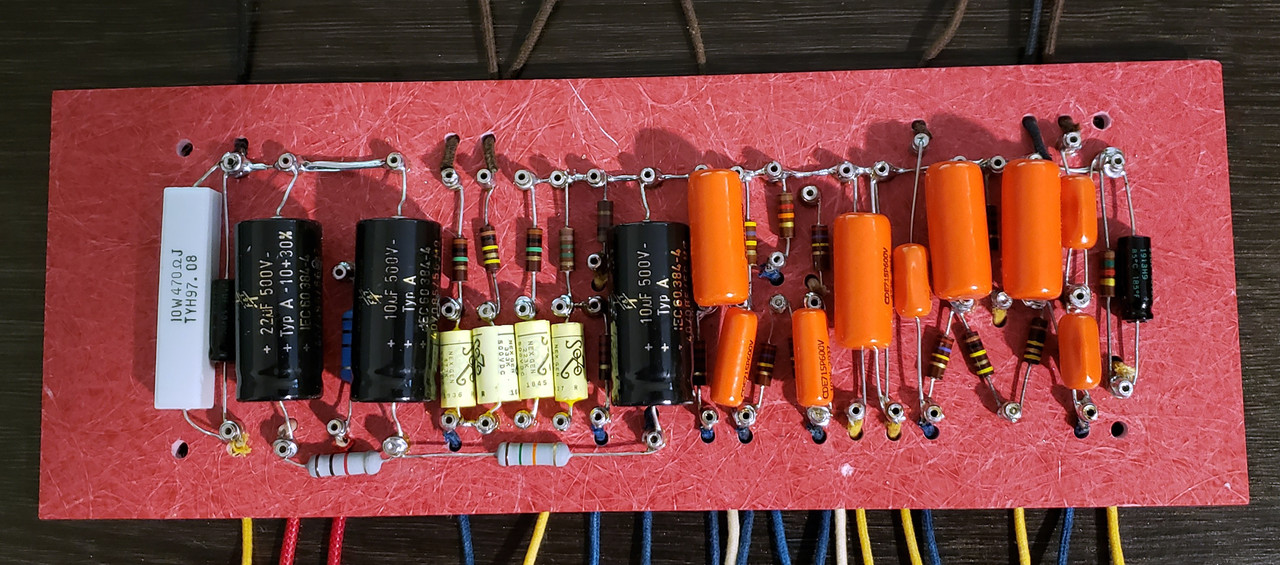

« Reply #7 on: January 25, 2021, 01:07:48 am »
I decided to build the amp exactly as per Steve's drawing. Adding a tube reverb might not be the best idea. I can always use an outboard reverb.
Anyway, I drilled and staked  the turrets and started populating the board. I'm waiting on parts at this point.
I'm using F&T and Sozo and Orange Drop caps and Carbon Comp for all the 1/2 watt resistors. I buy 10 or 20 at a time to find the closest ones to the values I need. I went with Alpha pots as it doesn't seen to matter on past builds. Steve's build documentation is excellent so I should be able to make this work.
Thanks Steve.

So far so good.
I used a Sprague Atom 35uf cap, is that OK or should I use 33uf? Does it matter?
It's a tight fit...
  • Posts: 5281
Re: Yet another 6424 build started
« Reply #9 on: January 27, 2021, 07:06:11 pm »
Supro used 35
« Reply #10 on: January 28, 2021, 12:11:17 am »
> Does it matter?
No.
Look at your other e-caps. -10%/+30%. So a "33" could really be 30u or 43u. Anyway I bet (without looking) that anything over 25u is all the same here.

« Reply #11 on: February 05, 2021, 09:53:59 pm »
I put fire in the bottles tonight.
The good, she started right up and both channels are operational.
Issues...
1. My voltages are high. A=368v, B=357v & C=303v. About 18v higher than on the docs. Pin 9 on the 6973 reads 363v.
2. Both channels (middle position) do not come on. Only individually. I'm using an ON/ON/ON switch.
3. Tremolo only works if the intensity switch is on and a foot pedal is connected but the footpedal does turn it on an off. No tremolo if I disconnect the foot pedal.
4. The Tremolo channel sounds weaker, bassy and a bit distorted. The tone knob doesn't have the range of the other channel.
5. The 6973 tubes are running a tad hot. I'm not familiar with these tubes so I don't know how they should look when running.
Any Ideas?
The good...
1. The non-tremolo channel sounds fantastic. beautiful.
2. The tremolo sounds wonderful. With the Tremolo channel turned down low, it is marvelous. I couldn't be happier with how the tremolo is working.
  • Posts: 5281
« Reply #12 on: February 05, 2021, 11:15:21 pm »
Issues...
1. My voltages are high. A=368v, B=357v & C=303v. About 18v higher than on the docs. Pin 9 on the 6973 reads 363v. Not an issue. These voltages are fine.
2. Both channels (middle position) do not come on. Only individually. I'm using an ON/ON/ON switch. Not all ON-ON-ON switches are created equal. You must use a C&K 7211 and it must be wired like the schematic/layout.
3. Tremolo only works if the intensity switch is on and a foot pedal is connected but the footpedal does turn it on an off. No tremolo if I disconnect the foot pedal. Sounds exactly like you forgot the jumper between the sleeve and switch lugs on the FS jack.
4. The Tremolo channel sounds weaker, bassy and a bit distorted. The tone knob doesn't have the range of the other channel. It is a bit weaker. To fix the bass, replace the 35µF cathode cap with a smaller cap, 1µF to 5µF. The distortion is just the Jimmy Page effect.   :laugh:  Never noticed the tone control difference. May be normal. There is a slight circuit difference between the channels. Once you get the channel select switch sorted so you can run both channels, I bet you'll forget about these little issues.
5. The 6973 tubes are running a tad hot. I'm not familiar with these tubes so I don't know how they should look when running. Did you determine they are too hot just by looking at them? I didn't see anything odd. However, these tubes are made to run hot. My tubes were running at 24 watts which made me nervous since they are also expensive. I lowered the power to 18 watts with a resistor change. Look at the note on the schematic.
Offline AnalogDok
  • Posts: 83
« Reply #13 on: February 06, 2021, 10:13:26 am »
Thank you for the lightning fast response.
1. Yayyyy...v = OK
2. I ordered and installed a DiMarzio 3-Position On/On/On DPDT Mini Switch. I'll get a C&K 7211 and see how that works out. The wifey really liked my tremolo demo this morning....
3.I'm using a Cliff Jack so the wiring is different than your diagram. I'll play with it some more today. At least it works.
4. I'll test my tube to make sure it is working properly. I bought new Tung-Sol preamp tubes and failed to test them before installing. Sometimes one side is weak. I actually used a  33uF cathode cap but I have other values to change to. What about changing the .0033 Mallory cap on the tone pot to a lower value. I'll hook up jumpers and experiment with different values.
5. The 6973 tubes have a glowing orange center element. I did install the 470 ohm 10 watt resistor to match your circuit change. They are unfamiliar tubes for me so running a little warm is probably normal. I don't like to spend all my Social Security Retirement on tubes either....LOL
The documentation was outstanding. It made this build go very well. Other than my dyslexic layout reversals and backwards heater wiring that I corrected, it went smoothly. Thank you Brother.

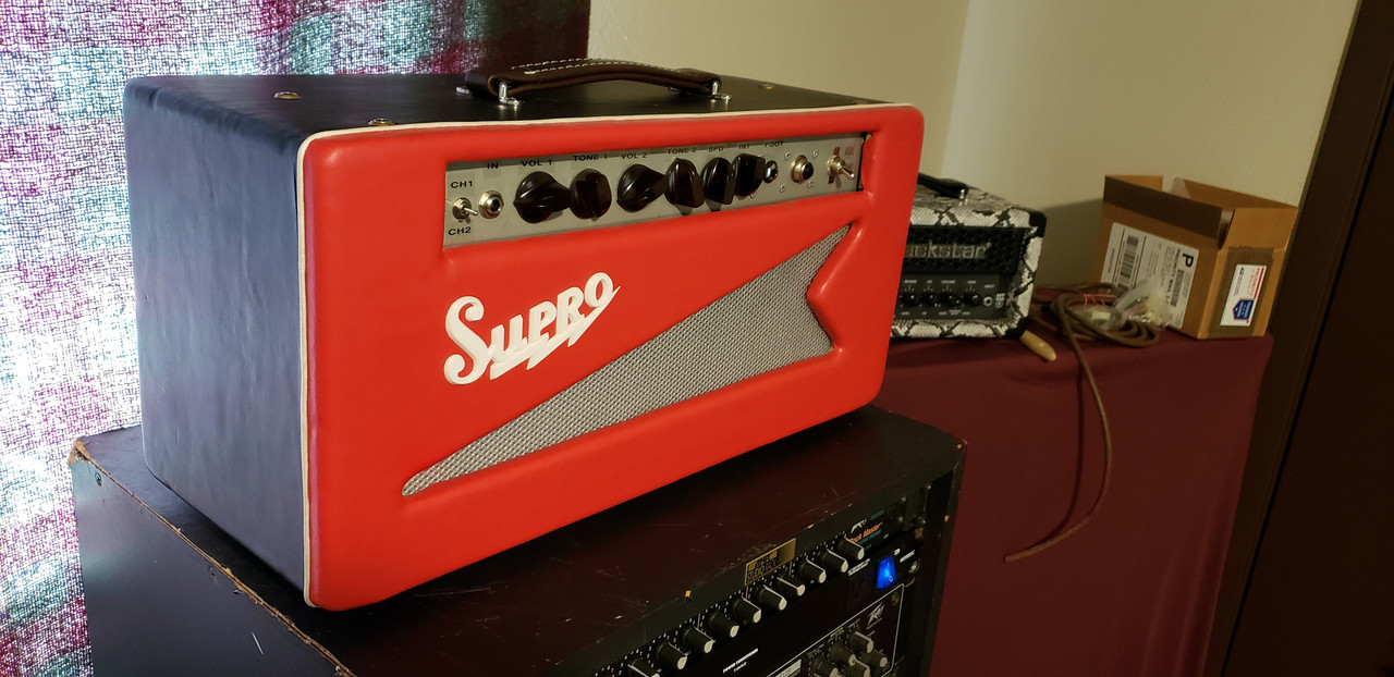

« Reply #17 on: April 29, 2021, 05:24:10 pm »
 I thought you would like to see the finished product. It plays great and I use it both as a standalone to play really swampy stuff or it works really well with a Peavey RockMaster preamp.
It's an upside down copy of the Supro Magick Head with pearl white leather piping and stainless mesh in the rear to keep the booger hooks out. Matching Bakelite knobs and a violet jewel.
« Last Edit: April 29, 2021, 05:26:44 pm by AnalogDok »
