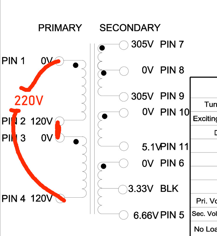

hello!
Hope you can help me with the following problem:
The primary fuse (1.5A) breaks every time I connect, how could I know which winding is bad? I measure but they all have low resistance values. In the primary there is 15 ohms. In the output winding 300V 246 Ohm. The transformer is a Hammond 290PX
Thank you

I have done the tests with secondaries WITHOUT load. But I understand that if any of the secondaries were short-circuited, they would blow the primary fuse by asking for too much current consumption.

That is an easy transformer to wire incorrectly.
Show us how you have yours wired and what input voltage you are using.
Did it ever work?

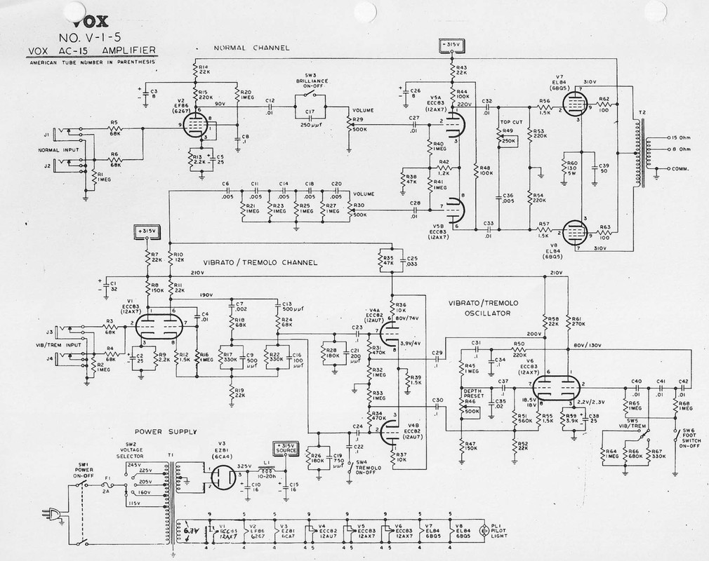

« Reply #7 on: July 19, 2022, 12:32:17 pm »
I think it should have managed an AC15; assuming you did, how did you use the EZ81 rectifier though?

« Reply #8 on: July 19, 2022, 12:44:26 pm »
Exactly as it comes in that schematic

« Reply #10 on: July 19, 2022, 01:08:57 pm »
I'm still concerned about how you wired the primary side of that transformer.
You need to energize both of those 120V windings for proper operation. (even if you're not running 230V input - or are you? - that's still not clear to me)
None of those posted schematics addresses this.
Show us how YOU actually wired the primary side of the transformer.

« Reply #11 on: July 19, 2022, 01:13:07 pm »
That’s not really good practice though, puts very high stress on the rectifier’s heater cathode insulation. With modern valves especially, you may be pushing your luck.
If it shorts, there will be a hard short across the DC HT. Hopefully that would blow the mains fuse quickly, but perhaps not quickly enough to protect the PT from damage?
HT fusing would be a significant improvement, could be fast acting types if that nasty hot switching standby was eliminated (or rearranged to be non hot switching).

How else would I connect the EZ81?
A PT with a separate, dedicated 6.3 winding for it would be best.

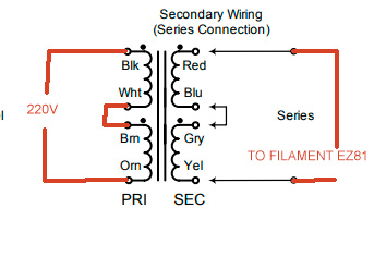

« Reply #24 on: July 24, 2022, 05:44:23 am »
The 266J6 connection would be like the one in the image?
What is meant by NOT CONNECTING chassis to ground, can't I screw this transformer to the same chassis as the rest of the screwed elements (transformers, connectors, etc)?

Re: Fault in the power transformer of a tube amplifier
« Reply #25 on: July 24, 2022, 06:06:41 am »
yes
I did not say that. Read my reply again.

« Reply #26 on: July 24, 2022, 12:48:20 pm »
yes
and I was referring to this:
"Don't connect the secondary to chassis ground."
The secondary I understand is connected to the filament of the EZ81 only. Is that so?

« Reply #27 on: July 24, 2022, 12:51:04 pm »
YES

Offline rafaelctt
  • Posts: 199
« Reply #35 on: July 26, 2022, 06:47:10 am »
Should I do it like this?
Thank you
