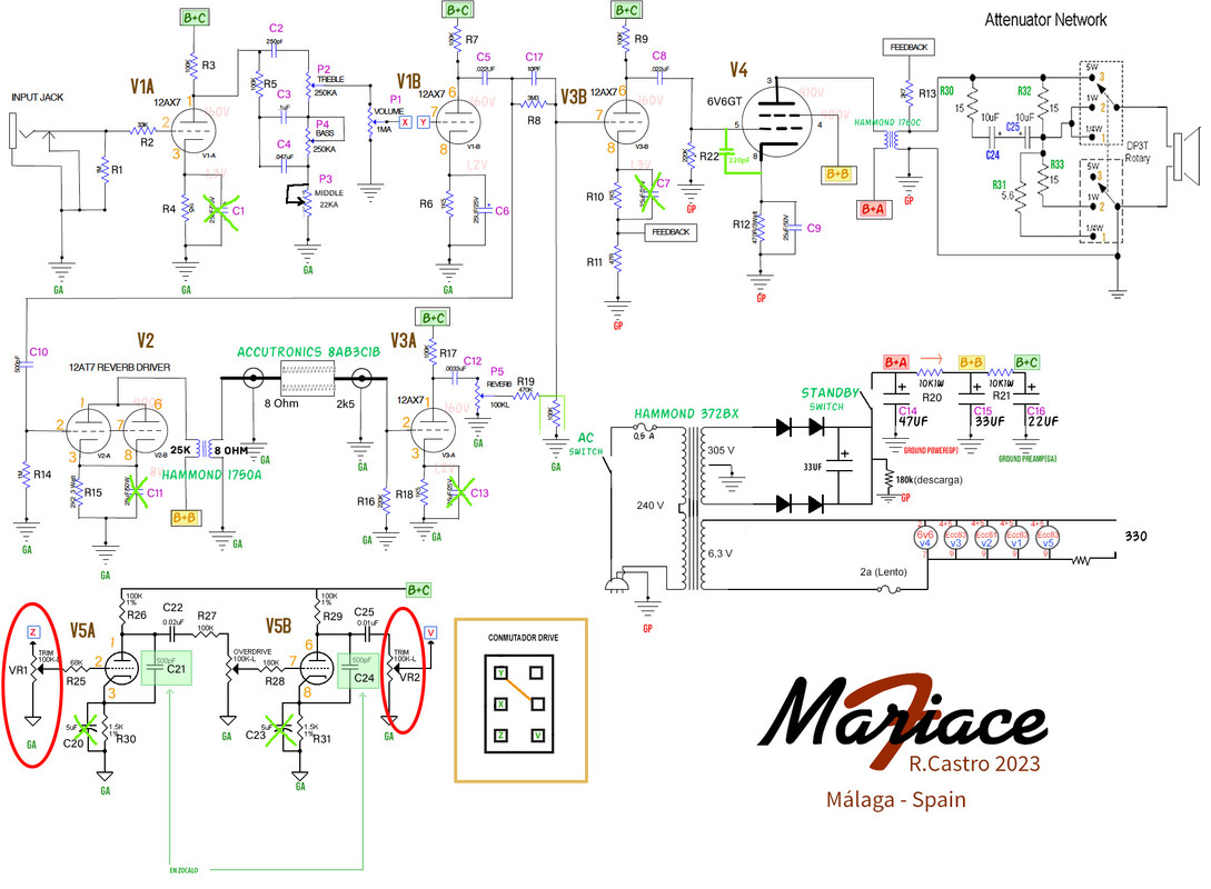

is there a trainwreck mod for the normal channel or some other gain mod? I dont mind adding a triode if there is a good mod that can get me a good crunch with dynamics and controllable feedback

Look at some trainwreck schematics. The express basically just adds one more triode.

If you'd like to try something a little stupid you can just run a clip on jumper from the wiper of the volume pot to the grid as pictured in red below. Keep the Volume low and ease it in.
Yes, it's stupid because you wind up with two tone stacks, but, you'll never hear how it sounds if you don't do it.
I tried it once and the signal needs some attenuation to make it "right", and I just never got back to it.
Sometimes dumb stuff makes you learn things.

i did the TW mod for the normal channel. added a triode. it seems to work good but of course i have to crank it to get any break up as the TW circuit has no master volume. Now i have the last .1uf coupling cap (from the cold clipper triode) feeding the mixing resistors. not sure if this is correct but not hearing any issues. I may have to add a master vol to this amp

Ok well i have an issue with the tonestack. Only the Treble pot works. the middle and bass pots dont do anything. Ideas? What's weird is the middle pot has no input on the diagram. This tonestack is wired differently than what i'm used to

Take a look at my AA864/Trainwreck Express preamp. It has an MV. I've built two and starting on a third.
This one shares more with the Express than the AA864 Bassman.
