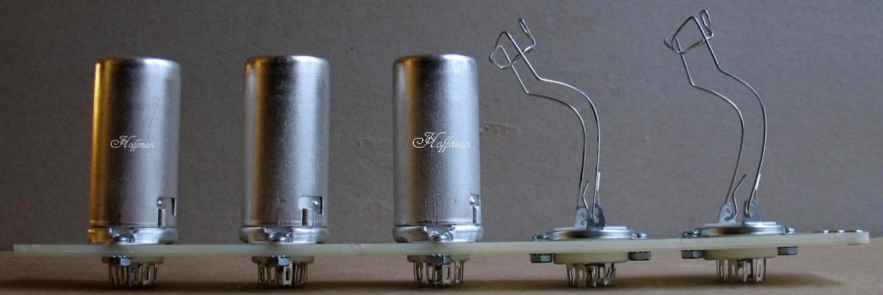

The DR has 16µF caps in the PSU and either a GZ34 or a 5U4GB.  I believe the 5U4GB drops more voltage.
Here is a link to the schematic for the DRII.  Its not 100% accurate but close enough.
https://el34world.com/charts/Schematics/files/Fender/Fender_deluxereverb_ii.pdf
I have modified the clean channel preamp to AB763 REVERB.  The reverb mixer is 3.3Megs, so I may look into raising that, but I don’t think that is my issue.
The PI is modified to AB763 DR.
The PSU is stock.  It has a full wave bridge recitifier.  I imagine this is superior to even the GZ34, but is it the cause of my issue?
The Power supply filtering is much larger than a DR.  I think this needs to change for sure.
I am trying to get not only the SOUND of the DR, which I almost have, but also the FEEL.  The amp is VERY strident.  I do not want to gut it which would simply things greatly, because I would like to retain the channel switching.  I will play with the lead channel later.  Now I just want to get the clean channel to sound like a 1967 DR I played and fell in love with and regretfully didn’t buy back in 2014.  I would honestly like to make the lead channel more Tweed or Marshall or Boogie and I may try all of the above to get where I want with that, but I want the clean to be stock DR.  The transformers are the same as far as I can tell so there is no reason I shouldn’t be able to get it there.  There is even an unused triode so I could get some shananigans going later, on the lead channel.  It actually has everything necessary just in the lead channel to be a basic Dumble, missing some features, but I’m not sure I want to go that far.
Looking at the schematic, should I swap out all that filtering to stock DR values, and will that soften the attack?  Any thoughts on a SAG resister set up, and how I would impliment that to aproximate the 5U4GB’s effect on the voltages?  Would that also help?  Should I just scrap the bridge rectifier, cut a hole and install a tube rectifier?  I am not sure if the transformer has the rectifier leads or if they are cut off, or if they are omitted from that one, which I think has a single letter difference in the part number.  I’ll have to get into the amp to find out, IF I were thinking of ditching the SS rectifier.  I feel like there should be a way to get the sag without doing that.  Not sure if the time constance of a resister, which is pretty linear, would match a tube though.
The last thing I may do is at the Intensity pot 50K load and see how that compares to the no load.  I prefer the no load on my Twin Reverb.

Doug has 50 Ohm 10W.  Based on your suggestion of 100Ohm, I was thinking a pair of those in series would work.  I could put together a clamp made of aluminum plates and put some heatsink schmoo between the resisters and the plates, then use the bottom plate to secure it to existing mounting points.
When I ordered the replacement cap can for this amp in 2020, I was looking to get it up to par with leaving the factory.  Did not occur to me that all that filtering would not only reduce the hum, but also make it very stiff.  No hum is number one for me, but if I can’t get the amp to soften up, I won’t play it.  It honestly feels stiffer than my Twin.
Should I expect the reduced capacitance in the PSU to raise the hum level?
Where in the circuit would you put the SAG resister?  Right after the bridge and before the first filter cap?
Does anyone know what the smal caps across the diode do?  I’m assuming some kind of RFI filtering but I have never seen this before.
Edit,...Looks like if I cut the 80µF out, that gets the first stage to 40µF, so closer to 32, and the others are 20µF so closer to the 16.  That at least would be an easy way to see if it will take me in the right direction before I roll my own cap board.  Thoughts?
