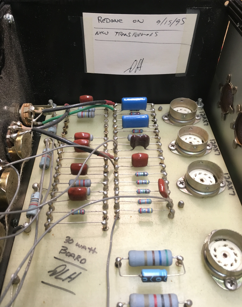

Hello,
First time poster here.   And still getting my feet wet when it comes to a lot of this stuff..
Recently I acquired a Fender Bassman 50 head (72 silverface).   I've gone through and recapped it, replaced a few components that had drifted far out of spec.   Replaced power cord etc.   Working great, now I'd like to do a little tweaking to it.   Most of which I feel pretty comfortable with but I had a questions regarding using th existing ground switch which isnt currently doing anything as a switch for removing the NFB, having the 47k stock resistor value, and putting an 820R in as is seen in the BF circuits etc.
The ground switch however has the fuse, standby switch and power switches between it and the speaker outputs.   I have an open eyelet on the board in a perfect location for a second resistor and wire from the switch to go and meet up with the 47k.  Anyways my concern is that I'm just going to be asking for noise running a wire from the output over all that power and then also the proximity to the power tubes.    Would rg174 be the solution for this?   where would be the best place to attach the shield to ground (or does it really matter)?   I'd have to do a run of one wire from the speaker output jacks to the switch,   and then two wires from the switch back to the middleish of the eyelet board.   With the coax cable do I need to worry about routing?
Thank you for your time

The Bassman 50 NFB circuit is quite different from an AB763 (blackface) circuit, so don't switch a 820Ω resistor with a 47K resistor. I suggest switching a 100K instead. Shielded cable is not necessary.
Of course, you can always convert that power amp circuit to an AB763 circuit, but it's more involved and may not be worth the effort.

Oh wow you are very right that is quite a bit different now that I look at it again.
My thought was I wanted more clean head room, and increasing the resistor would get me there?   With the difference do I need to be concerned with having the loop completely listed in the "off" position of the switch?
This is the schematic of my amp.

So I kind of held off on doing any mods  yet.   But I really would like to find an option to have a bit more headroom with this amp but keep the normal channel as is.
Obviously I could “blackface” the power amp section.    I’m somewhat curious if in the bass channel I bypassed the gain stage between the tone stack and the power amp.   I’m assuming I’d lose a little volume but would also get a bit cleaner.

This is where I’m a bit confused.   I’ve heard that.   And then I questioned if there was an issue.
Digging around I think this particular model the bassman 50 is a bit different than just about all others.
https://el34world.com/charts/Schematics/files/Fender/Fender_bassman50.pdf

Well I take it back.
I think there is a bad power tube.   Removing the triad and leaving the rca in amp works exactly as it has.   Removing the rca and leaving the triad in.   No sound.

Yes in either position the rca works, in either the triad does not.
I guess I should’ve looked at the easier options first for getting more the sound I was expecting.
So does this appear to be red plating?
Hard to tell through the getter for my untrained eye from the images I tried to compare it to online.  Since I was getting sound and it was lighting up I guess naively thought that was good.
Sounds like if I do want to have lower volume break up it’s ok to just run it off one power tube as well for playing around the house ?

It looks to be ‘red heatering’ to me?
  • Posts: 3226
Re: Using Ground switch on SF Bassman 50 for NFB switch
« Reply #22 on: February 03, 2024, 08:50:18 am »
That is not red plating. The plates will glow orangish red.

Just a minor update.
Some yea my problems weren’t to be fixed by mods it was I just needed to get the amp correct.
The one power tube was bad.   Lots of very loud clean head room especially now that it is running at 4 ohms through a 2x12.   No reason I could see myself turning it up past 3 at this point.   Thanks all.
