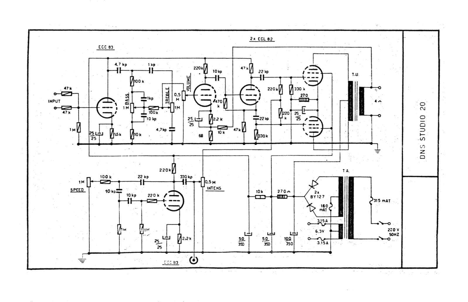

Hey everyone,
I stumped with this one repair on a Fender Twin Amp '57 Reissue... Schematics is there ->https://schematicheaven.net/fenderamps/57_twin_amp.pdf
It makes a "pop" every now and then, not often but often enough to drive its owner (and myself) crazy.
I'm only working with my own test tubes right now, so unfortunately the usual suspects are not guilty here...
Here's the thing:
- "pop" is nice and loud with only V3, V4 and the power tubes in, so VOL control has no incidence on it.
- the treble control changes the tone of the "pop" (brighter or darker)
- get this: with only V4 and the power tubes, you can STILL hear a faint(er) "pop"  AND its tone changes with the treble control (which is upstream of the signal chain...)
I'm thinking of a defective component in the power supply, I changed the first 10k dropping resistor (r44 on the schematics), still the same issue.
I NEVER trust silvermicas (c7 and C8 are on the tone stack) so I changed them for HV ceramics, still the same issue.
Next thing in my crosshair is the filter caps but they're F+Ts, not that they never fail, but they are the lowest for me on the list of things that can go wrong.
The thing that baffles me really is with V3 out, the treble control still influences the tone of the "pop"
What do you folks think?
Thank you so much

Could be a bad tube, possibly a bad output tube.

Check R25 for a bad solder joint, broken internal connection, or just replace it outright.
Inspect the V3 socket for signs of arcing.
Check C15 for a bad lead or solder joint.
Make sure the treble pot is tight and clean.
It's getting into the treble pot somehow. If those suggestions don't pan out, isolate that section entirely by strategically disconnecting then reconnecting the outer lugs of the treble pot. If that doesn't work, lift the 10M feedback resistor and repeat.

somehow I was also thinking of R25, so I'm going to replace it and see, however, with V3 out, I cannot see how it would still be the culprit, but at this point I'll believe in voodoo
« Last Edit: August 10, 2025, 06:41:13 am by Sansteeth »
  • Posts: 3146
Re: "popping" Fender Twin Amp '57
« Reply #4 on: August 10, 2025, 08:44:01 am »
V4,5,6 are all in the nfb loop.
How about if the loop is opened?
To eliminate the power supply caps, just connect a good cap (smaller uF, at least as good V rating) across each in turn.
The treble control puts a 10nF cap bypassing V3 pin2 grid, so it seems reasonable that it would still affect things.
I'm not sure I understand what you mean?
  • Posts: 3146
« Reply #6 on: August 10, 2025, 09:11:14 am »
If the nfb loop was intact, and eg V4 anode was popping somehow, the loop would feed the pop back to V3 pin3 cathode, which from the perspective of the feedback signal acts as a common grid stage. My understanding is that an AC bypass at the grid of a common grid stage will tend to raise the stage gain, as well as decoupling any resistor noise at the grid caused by residual grid current.

A possible iffy connection might be at one of the valve sockets, ie if one of the valve pins wasn't being gripped sufficiently tightly.

At the start of the signal path the treble control fades in and out the effect of C2 on V3s grid, changing the tone of the noise. It could be C2 is leaky, try temporarily disconnecting it. Even with V3 removed, the treble control is still connected to the negative feedback loop. The louder pop with V3 installed sounds to me like a global noise that is louder because it has one more gain stage and either comes from C2 or the power supply. IMO once I've opened an amp up I just go ahead and replace the power supply caps unless they're obviously of recent vintage. If there's gunk on the board, use a qtip and alcohol and scrub it clean. DC can leak through gunge stuck on ancient flux residue. It also never hurts to just go up and down the board and re-flow every solder joint. These things were assembled by people of all stripes and abilities to minimal standards.

I just got back from some needed holidays, thank you so much for your help and all your responses, as many have guessed before, it was a dodgy solder joint, I reflowed a whole bunch of solder joints and the "pop" never came back...
I though the chopstick method would easily show issues of bad connections/cold solder joints, and it usually does, but I realize it can be too subtle and go under the radar.
