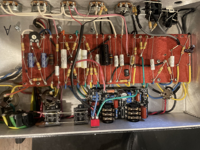

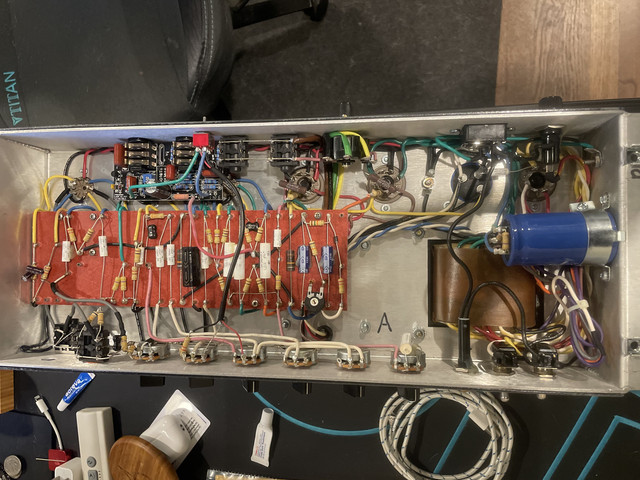

Trying to service a 60's GA-30. This particular amp has V1 and V2 as 12ax7. V3 is a 12au7 (Phase Inverter)
I don't like the harshness of the gain. When I put a nice sinewave in at the input, I am seeing a very sharp almost sawtooth at the output of v2b when I add any volume over 25% of the vol pot. All the tubes are good.
This circuit has the "tone expander" as well.  NFB off the output transformer.
If I turn the tone pot down almost all the way, I lose gain, but the output waveform starts looking more like a sinewave again.
Do you think the issue is in the tone circuit?
My guess is that's due to a positive feedback loop forming via the shared V3 cathodes.
Fully bypassing it might help with that.
Amplitude and frequency?
Just to note that 25% on a linear pot is well over halfway on an audio taper pot.
It looks like a bass boost?
It's another linear track, all the change happens between 0-33% rotation.
With the volume settings you're using, the tone control is causing a treble boost unless it's turned pretty low, eg 10% rotation.
I suspect the issue is with the paraphase splitter.

Turns out it was the 220k resistors prior to the phase inverter. One was open and the other was reading extremely high. In total there was 8 resistors that were way out of tolerance. I replaced all of those. One note, I changed V1 to a 12at7. That actually made the amp much more usable. No clean headroom after 2,3 on the volume until I did that.
