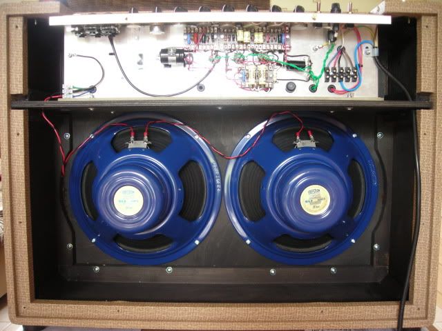

here's a photobucket link to the chassis i'm going to use. it's an old marshall chassis that got butchered and then given to me. i've moved the transformers and preamp tubes and i'm putting in more turret boards.
BORING ALERT: the following is a description of how i think the layout is going to work...
-the PT is all the way on the left with a rectifier tube just to the right. i had to put on a 5v filament transformer for the rectifier.
-the inputs are on the far top right.
-below the rectifier socket are the first main filter caps.
-the red board in the middle will be the bias circuit and the next set of mains filter caps. right above that board are the red and black wires coming from the choke.
-the long red board down the middle will be all the filter caps for the preamp stages with a heater reference voltage cap right after the driver supply. i'm using little axial caps with the positive leg towards the preamp tubes and plate resisters from the caps to the pins.
-the board at the top is from the first version of the amp i play now and still has some junk on it that didn't get transfered over. i'm going to run short wires from the preamp tube pins to that board to coupling caps, cathode bypass stuff, anything signal related. i was thinking about hanging the tone caps and slope resister right on the tone control pots, bad idea?
- i'm using KT88's so they're spaced out. the board between them is for the .1 caps that get the signal from the driver, and the grid stoppers, bias trim pots and 1ohm cathode resisters to check the bias draw.
-the OT is all the way on the right. the laminations for both the PT and OT are pointed up and down. i think that is the right way to keep they're magnetic fields pointed away from any of the tubes. so like a side with a bell is pointed towards where the tubes are. i placed both the OT and the 5v filament transformer using "the headphone trick" so they're not hearing the PT.
-the heater wires run are down the middle of the amp under the long red board laying flat against the chassis.
- i have the main ground to the chassis over by the plug where the house voltage comes in. there is a short buss under the main filters where i was going to bring all the ground wires to before sending them to the chassis ground. i sort of imagine a lot of ground wires right now. i'm not sure where to run them. i could also make the bottom edge of the long red strip into a ground bus.
-the signal wires from the driver tube have to pass by or over the mains supply. i thought maybe i'd shield them? it's not far to go just straight down to the yellow board.
is there an audible way to tell if a wire is throwing noise? like waving around the end of a chord plugged into an amplifier and wrapped with electric tape.

> the impression that it could be a quieter circuit if i filtered the crap out of it's plate voltage and possibly did dc heaters for it.
Do NOT say "noise"or "quiet".
Say hiss, hum, buzz.
In (non-audio) applications the Cascode may be lower HISS than alternatives. It can still hum as bad as any, and will buzz like a bee if your B+ has buzz or you have buzzy leads near its HIGh-impedance node.
For low hiss, the standard Fender first stage is as good as guitar needs. (Weed-out hissy tubes.)
For low heater-supply hum, twisted pair run well away from all audio points has been shown to be really darn good; however if you add too much gain for too-much distortion (or used PCB), you may need DC heat (and good DC, not single-cap filter).
Low B+ hum/buzz is trivial in this day of cheap electrolytics.
Yes, a cascode can be overloaded easier and with different flavor than a simple triode.
