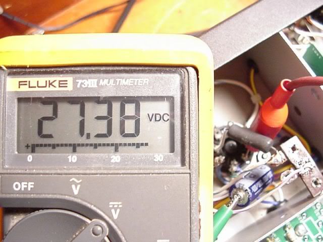

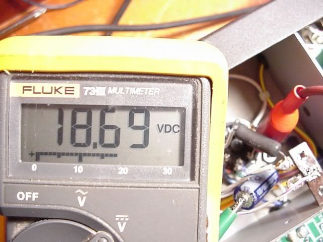

335VDC High and 257 VDC Low. Roughly 78 volts difference. I am getting .004 voltage pin 8. This is one of the first things i checked when i removed the bottom plate. When i said earlier that i had no grid bias voltage what i ment was there is no voltage on the resistor/cap combo to pin 8 the cathode.  Then i discovered the KT88 to be dead and put in a TAD 6L6GC tube. Still no voltage on pin 8 that would calculate to the plate voltage of the power tube (335VDC). Does not look right to me. I have built single ended amps before and got the cathode voltage with no problem.

I would check the cathode resistor and the cap and maybe try it without the cap. Secondly I would check that ground wire from those cathode components, looking at the pictures it looks like it is not going anywhere.
Re: THD Univalve No B+ To Attenuator. UPDATE: Finished Not?
« Reply #8 on: August 08, 2010, 04:53:14 pm »
Lifted cap from resistor and ground: Appears to be a bad cap. It wont bleed down on my analog Micronta
If i remember i dont need the cap but it can set the bass response (Tone to a degree) Dont know if thats the case here just yet
I put an alligator clip on the neg cap and as soon as i connected it to the ground side the voltage would dissapear
I only have a 330uf/16V cap and a 250uf/35V cap on hand. Have to play it and hear it first.  Thanks for the tip. There is a White/Green wire that goes from the top terminal strip Resistor & -Cap to chassis ground

« Reply #9 on: August 09, 2010, 04:59:36 am »
According to Merlin, if you want to maximise output power and input sensitivity, then you need that cap:
http://www.freewebs.com/valvewizard1/se.html
That 35V is pretty close to that 27.38V. I would probably use at least a 50V part here, something like 100uF should be enough.
