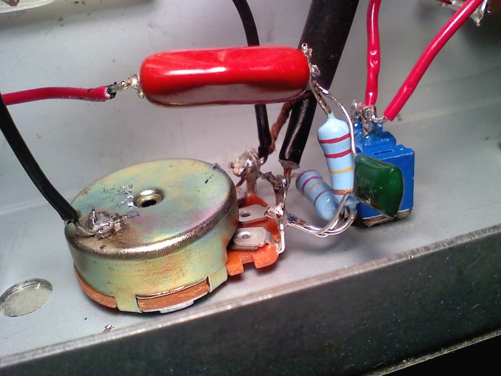

After much head banging, come to find out the cap was not passing DC.  New cap, same problem.  There is a few volts from the CHASSIS to the wiper.  NOT from the star ground to the wiper.  I had not grounded the back of the pots, and after doing that, the problem has mostly gone away- probably need a better solder joint though.

After messing around some more last night, I can't quite figure how grounding the back of the pot to the star helped, but if anyone knows why, or has a method/logic for grounding pot housings, I'm all ears.
CHAD
Offline ThermionicEngine
  • Posts: 53
  • ooops- Should have cut the blue wire first
Re: Master Volume help please
« Reply #9 on: March 18, 2011, 09:30:43 pm »
CHAD
FWIW I run a ground buss wire along the back of the pots and ground it to my central grounding point on the chassis.  Make sure the pot covers will take solder, sometimes they have to be brushed or sanded to make a good solder joint.  I also run grounds from the board to the buss wire so mostly everything ends up at one ground point.  Usually this procedure eliminates ground loops and sometimes mystery oscillations.  Cheers, Larry

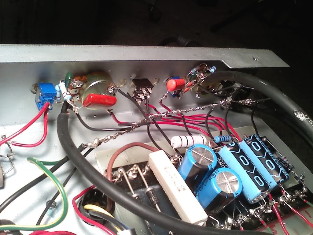

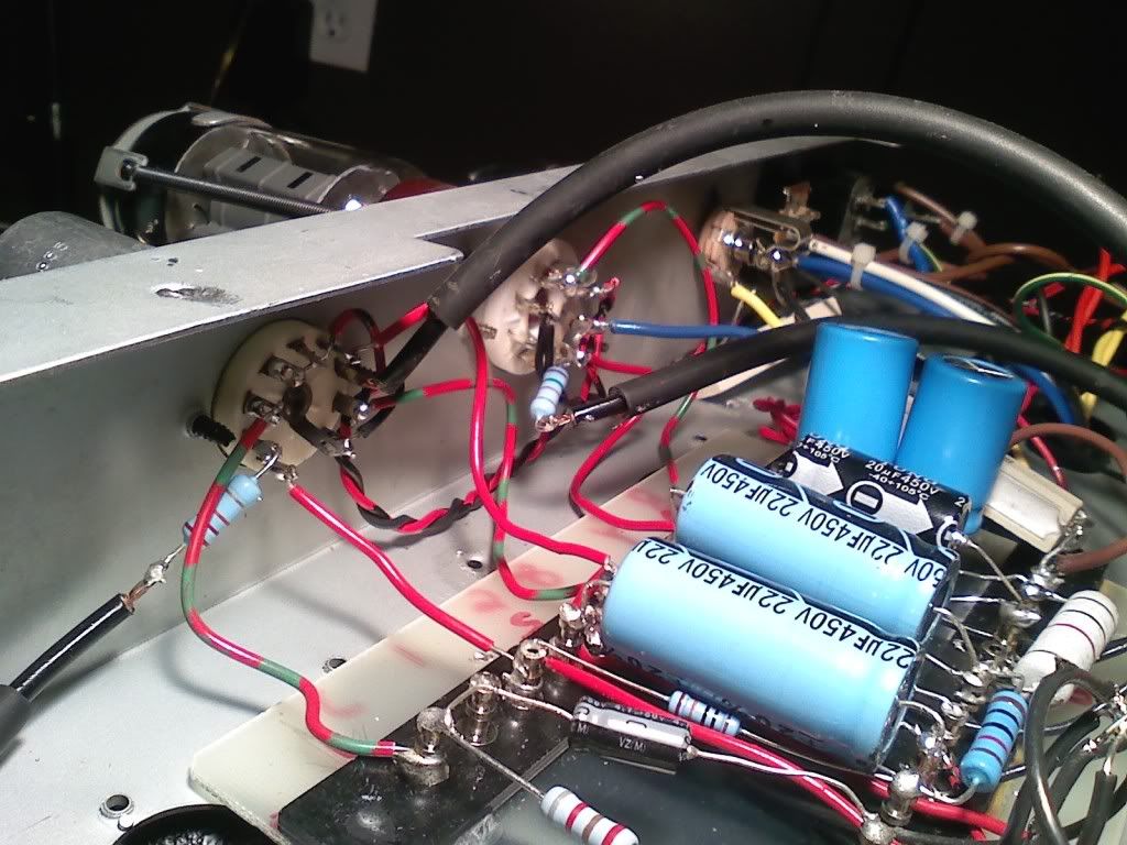

I'm still trying to figure out this volume problem.  To restate, MV works fine up to 9.5, but in the last fraction of a turn the amp gets a buzz like when the cord is plugged in with no guitar.  Here are gut shots.  I realize I have housekeeping to do to secure coupling caps and wires, etc, but I need to get this last annoyance fixed first.  If you have time to invest, please make suggestions, and I'll try them and get back with results.
Left to right in the first shot are:
Power/Standby
Lamp
Low Power switch experiment (two 40K 10W in parallel switched in the HT)
MASTER VOLUME!!!
Boost (grounds preamp bypass caps)
Tone bypass cap selector
Gain
Input
Close-ups of master volume
I tried a different shielded cable from MV to 6L6 screen and that didn't help.  1M MV pot has been replaced.  Re-flowed joints...
CHAD

With one end of a test lead clipped to the cable shield, the trouble clears.  The other end of the test lead is not terminated.  I'll just have to bury that in the chassis somewhere...?
