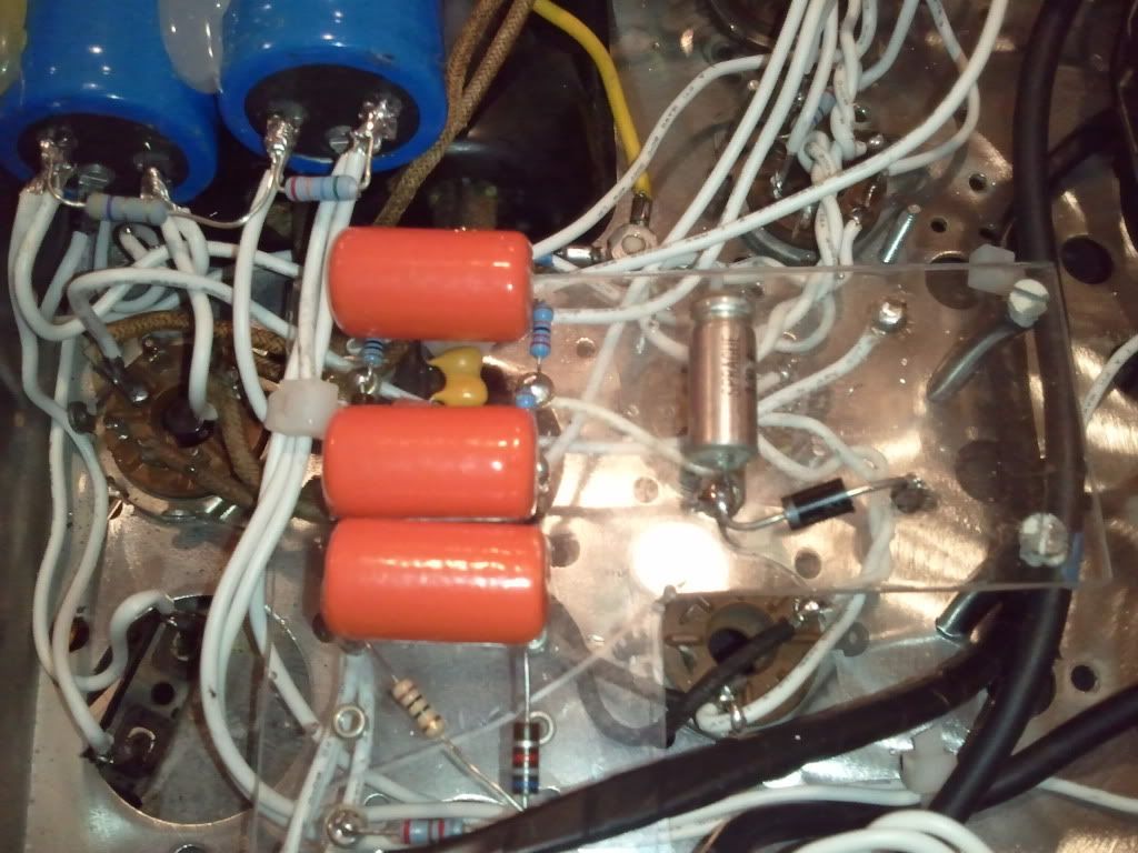

Here is the built before I tested it:
Here is the bias circuit currently.  The resistor isnt in it because I need to know what value it needs to be.  These is a resistor under the cap:
The outside:

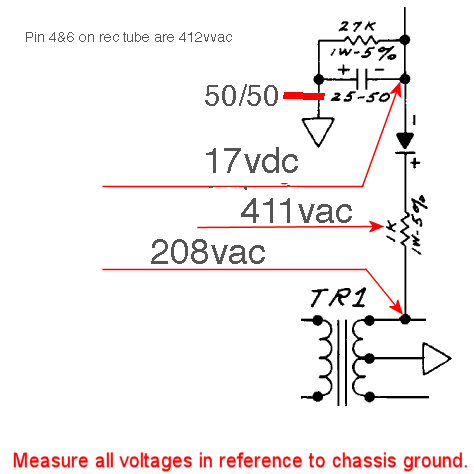

« Reply #74 on: October 11, 2011, 10:07:30 pm »
Will the bias voltage change when I put the 6V6 tubes back in and my B+ drops?
No. Not if it's wired IAW your schematic.
What am I doing wrong here?
I don't know yet, but I suspect something is not wired correctly. Look at the attached simplified schematic and make the two voltage measurements indicated. One meter lead needs to be on chassis ground. Be sure to use a 100K resistor. The Princeton Reverb uses this exact circuit and feeds 340VAC to the 100K and puts out -34V on the bias cap. The circuit is a proven one. I didn't just make up that 100K value. The 100K should not get hot.
While you're checking the AC voltage, also check the AC voltage on the 5Y3... pin 4 to chassis and then pin 6 to chassis. Report back with the readings. There are only 4 components involved. There's gotta be something simple amiss. If you can post some high rez pics we may be able to spot something.
PS... For anyone that has trouble looking at the bright green schematic, look at this one instead. The green schematic is a 6G6-B Bassman without the normal channel and the rectifier is replaced with a 5Y3.

Your diode is currently installed backwards. The banded end connects to the "100K" resistor and the black end connects to the negative end of the bias cap.

« Reply #78 on: October 11, 2011, 10:52:05 pm »
OK Diode is correct now.
Here are the voltages:
Pin 4 & 6 on 5Y3 = 412vac
100k to diode = 222vac
Diode to cap = -43vdc
Pin 5 on 6V6 = -35  !!!!!!!!   SWEET!!!
Those two voltage readings should be the same!

> Is that a problem?
Yes.

I am using a Fluke T5-600 voltage, continuity, and current tester.
I am using a 50-50 cap instead of the 25-50 that is in the schematic.  Could that have anything to do with it?
No. But mentioning that cap reminded me of something I forgot to mention... All the experimenting with all those resistors has severely stressed thatr bias cap. E-caps don't like reverse polarity voltages. Even if the cap seems OK now, I'd still replace it just because I know it's been stressed. This bias circuit is such a simple circuit that it's easy to think that it's not very important. But if that cap fails you risk losing your output tubes and maybe even some transformers. Replacing that cap is real cheap insurance.

But what about the difference in voltage?
The only thing between the diode and the tube grid is a 220K resistor. No current flows thru the 220K, so no voltage can be dropped across it, therefore the voltage would be the same.
Your tester is the cause of the difference. Your tester has a 1meg input resistance. When you connect the tester to pin 5 now you create a voltage divider and current can now flow thru the 220K causing a voltage to be dropped. You basically have a 220K in series with a 1meg (your tester) across a 43 volt source. Doing a little math yields 35v dropped across your meter.
So, don't be concerned about the difference. It's legit with your tester. You may want to get a meter that is more appropriate for this type work.
Your next big challenge should be to get the B+ lowered to a safe value. You are risking blowing those big blue filter caps.
