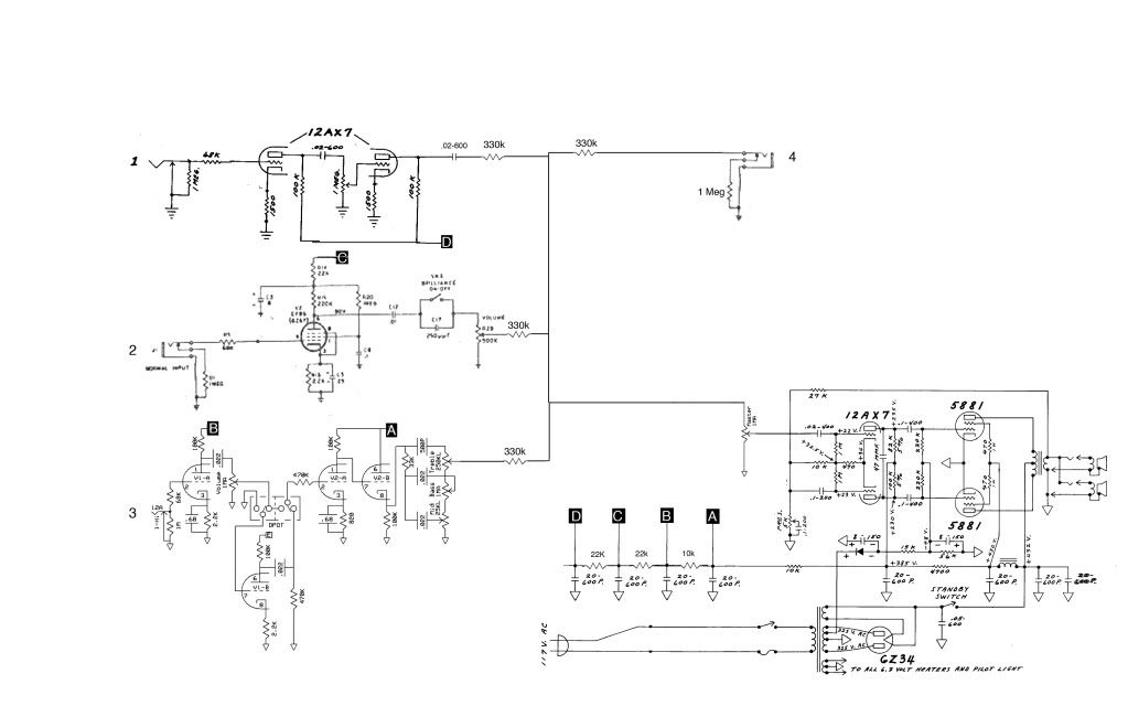

Here is a schematic I am working on for this.  Can someone help me with the cap and resistor values for the power rail?
Thanks!!
Re: My Next Build
« Reply #11 on: November 20, 2011, 05:35:06 pm »
you forgot a plate load resistor and power to the plate load of channel one, second triode.
--DL
Offline blown240
  • Posts: 409
Re: My Next Build
« Reply #12 on: November 20, 2011, 05:59:50 pm »
Good Call!   Fixed.

So should I use 20/600 caps for the entire power rail?  And how what value should the resistors be between them?
Or is there a general rule for setting the rail up?  I have never done an amp with this many filter caps.
  • Posts: 5401
Re: My Next Build
« Reply #14 on: November 21, 2011, 08:39:57 am »
20µF caps would be fine. As for resistors, just start with values you saw in the original schematics and adjust up/down to get the voltages you want.

So Do I need to have a cap on each channel to block the DC from the pots?  Or just on the champ channel since its the only one that doesnt have a pot last.
Thats why I had the cap before the master volume.  Would it be better to caps on both sides of the master volume?
« Last Edit: November 21, 2011, 07:47:00 pm by blown240 »
  • Posts: 5401
Re: My Next Build
« Reply #16 on: November 21, 2011, 08:20:27 pm »
Yes. However, channels 2 and 3 already have caps that block the dc from the pots. Channel 1 did not have a cap.
No need for a cap on the top side of the MV. But you must have a cap between the MV and the PI. Not so much to keep dc off the MV pot but mostly to keep the MV pot from interfering with the dc bias voltage on the PI grid. Did you notice that the PI grids have about 22vdc on them?

« Reply #17 on: November 21, 2011, 08:22:29 pm »
No I didnt notice that.  Good looking out Steve.  Once Again, I appreciate it!
Here's where I am at.
