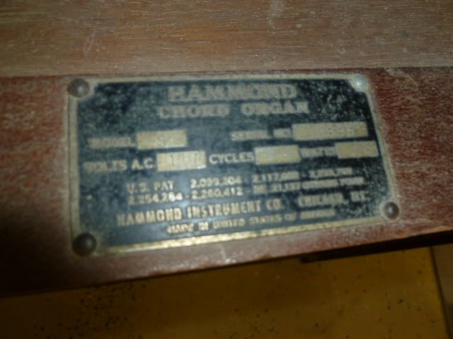

Right place at the right time.  I drove by a house where a lady was getting rid of old "junk" and this organ was part of the junk!  She said I could have it, if I hauled it off.  So I loaded it up into my Prius (Shocked it fit).
I got it home and it WORKS!!!!!!!!   Oh yeah and its a Hammond!!
Its got a vibrato hum, but everything seems to work.
Now I need to see what its worth, because I may clean it up and sell it.  Or if I can convince the wife that its awesome, it will end up in the living room.
Here are pics:

I have a friend who loves old Hammond Chord organs.  You're gonna discover that only the A, B, C 3's have any collector's value.  Well there's a few others but everybody wants a B3.  I restored a M-103 and I can't give the damn thing away.  That is a cool one, very unique.  Nice find.

I think this one is an S.   but I will have to verify that.

it is a "S" model - take a closer look at the photo you posted.

That's an S6 Chord organ. IT was designed for the "make music quickly in your home" market.  Those buttons make various chords then you can play a melody on the keys, and the foot pedal plays the Root and fifth notes of the chord you have selected. Play along with Lawrence Welk!   :icon_biggrin:
They're neat however not of much value to the "Hammond" crowd as it's an oscillator (all tube though) model and not a Tonewheel model.
me thinks it's just a plain S model as the badge in the photo shows.
it seems that s-6 used 9pin (12AU7/12BH7/12AX7)tubes. this one has all octal tubes. - likely 6SN7/6SL7, etc..
 http://users.rcn.com/clonk/ChordOrgan/Schematics/Figure6.gif
I am sure this one is a plain S model.  It has 6SN7 and 6SL7 preamp tubes with a pair of 6V6 output tubes.  I dont know what the rectifier is yet, but its got a cool shape and is pretty big.
from the pics - looks like a 5U4G - maybe even a 82 or 83. (83 is predecessor to 5U4 w/ diff. base) 82 is an 83 w/ 2.5V heater.
pull it - if the base is octal, then it's likely a 5u4G, based on the number of tubes it's powering.
