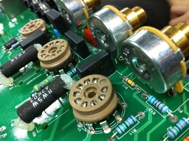

replacing those caps will most likely void his warranty (if he has one) from what I understand ...Ampegs have a great warranty.....so even though it only costs him 100 dollars ...if a tranny goes or anything else he's on his own .....
Rafe

I don't know who made them but they look cheap. I bet they don't sound very good.
I'm concerned about that brown one.

Ampeg may offer very good warranty in USA. But it is another story in hong kong.
And I see this photo in Hk forum. But I don't sure this caps is fake or real.

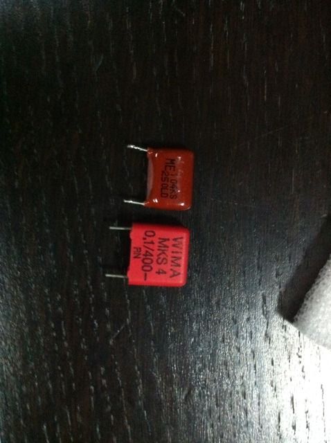

The blue caps is very cheap . I will use wima if I use this size caps. But I decide to use mustard to replace it.
As the brown cap , it is $0.3 usd for one here. I will use wima to replace it.
Or other suggestion?

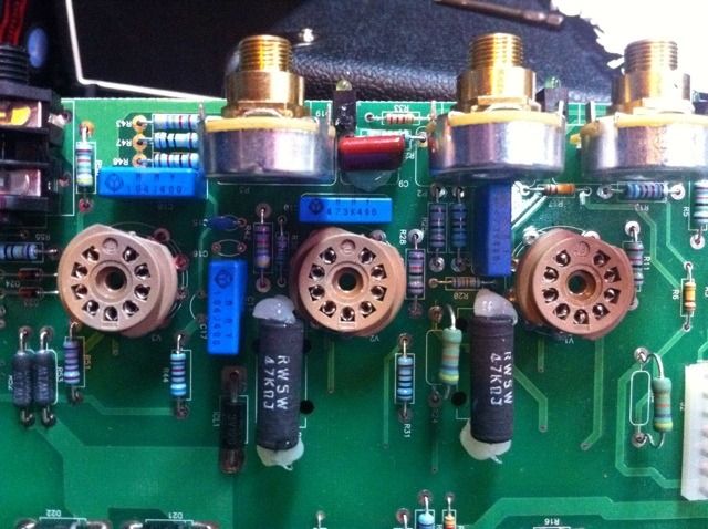

do you know what brand of blue color cap?
The blue cap is an MMY cap , says so right on it. Metalized Polyester film. Made by Yuchang Electronics Co. Ltd.

« Reply #55 on: May 08, 2012, 12:24:42 pm »
Thank you for your information.
Btw, is it good?
And I use wima all the way if I need small size mpf.
I see ampeg use wima in few year ago amp. But it seem to use more cheap caps in this year amp

The mmy caps are made by yu chang electronics co a Korean Company
I did a search mmy capacitor

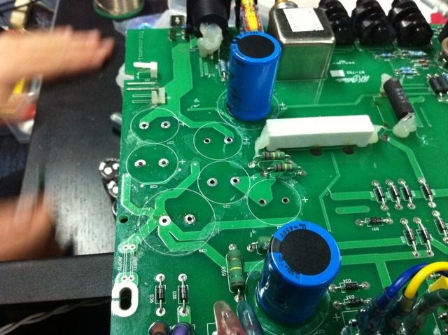

Re: My friend feel very upset of New Ampeg SVT VR

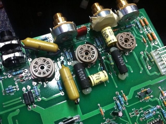

« Reply #58 on: May 09, 2012, 01:23:24 pm »
hi
i try to remove the the blue caps and change it to mustard.
but the result is not good. sound too hard, the bass is over, sound is overdrive little bit.
but i really don't understand why. because mustard caps good quality than that blue caps.
and vintage old SVT is also use the philips yellow caps.
and even i change the 3 preamp tube which for power tube section. this happen also, sound too hard, bass too much. i can't believe RCA tube bad than sovtek.
now, i guess will the problem come from the bias. because this amp have two bias led , but just one led is flash during playing
please advice me, in my guitar amp experience. good cap will not sound bad than bad cap. just different taste .
and i upload this parts schematic also. is the cap for the bias?

« Reply #62 on: May 09, 2012, 02:26:34 pm »
looks like the sozo is in the wrong place?

And I plan to use wima to try again.
But it is strange, even retune with RCA, sound strange too. But I don't think RCA bad than sovtek
Offline kwm488
  • Posts: 406
« Reply #64 on: May 11, 2012, 07:38:34 am »
I change the mustard caps to wima black box . It sound back to normal. Wima and blue cap are mmp also. But the black box is the hifi grade cap.

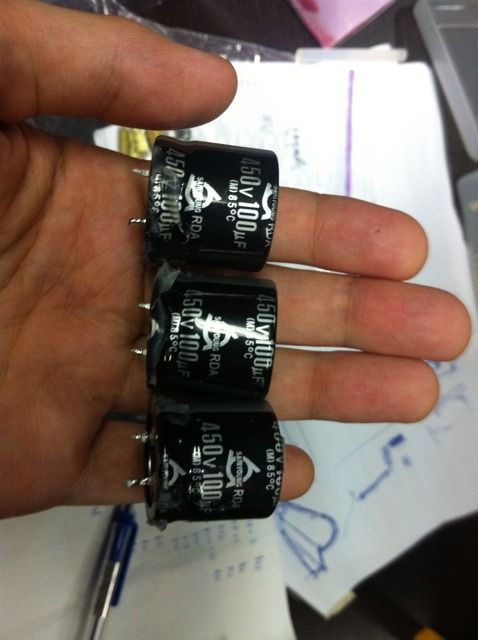

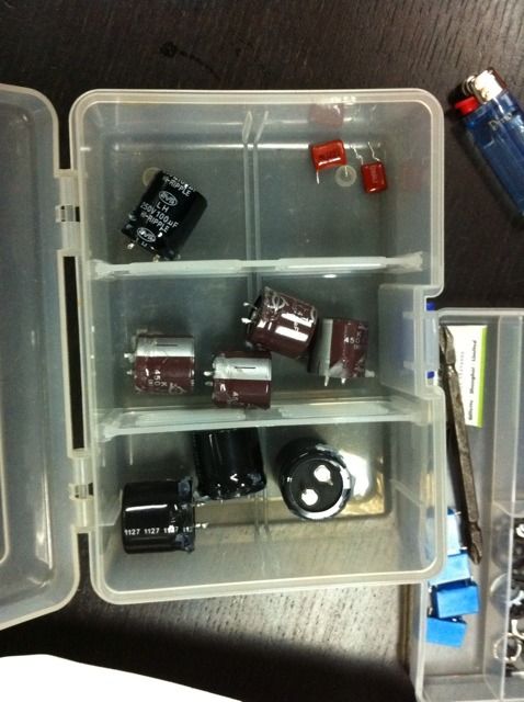

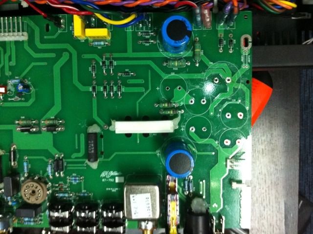

And I change three 100uf samyoung cap to BC caps. Sound more punch , treble more better, sound more power

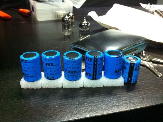

hi

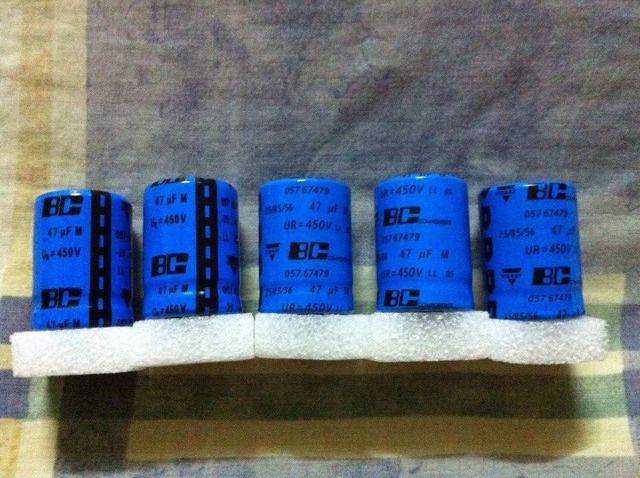

i understand speaker is very important. my friend will make his own cab and buy weber 10FL bass speaker.
anyways, he want to change the caps first. it is cost $100 totally for all caps.
follow are philips caps, will install on friday, i will take a videos about before and after

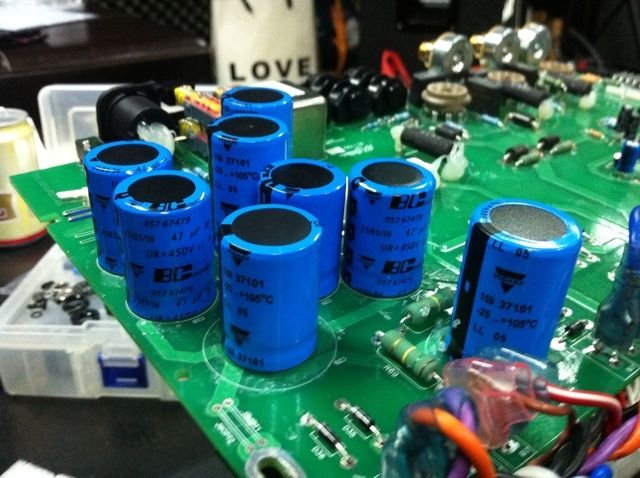

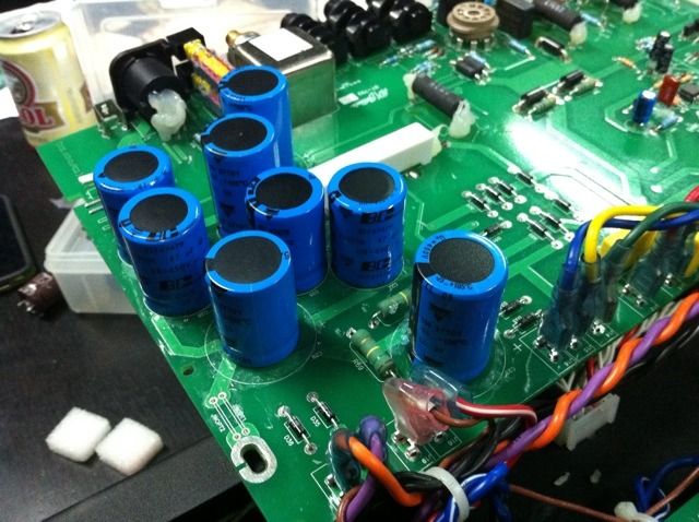

« Reply #67 on: May 18, 2012, 11:54:14 am »

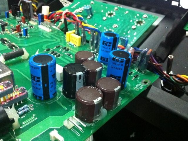

i install all BC cap to my friend SVT VR today. it sound better definitely. sound more fat, more detail, more power , more punch, more layer , smooth the treble and mid. i believe good filter cap can give the amp enough power.
i higher recommend to change the bad filter cap to better brand filter cap.
