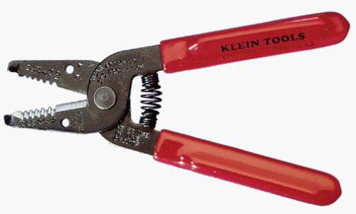

It takes a double half circle cutter to cleanly cut completely around Teflon insulation. You must have a dedicated pair of half circles for every size wire you will strip. And they must be sharp! Here's what I use. I give them to my electrician brother about every two years and get a new pair. I'm sure they would last almost forever in the hands of a "real tech" if only stripping plastic.    :icon_biggrin:

Yeah, I have a few pairs of that style
I find that you have to rotate them a bit sometimes to get a clean cut all the way around the jacket
The nice thing about the ones I use is you can stick them down into tight spots and strip wires
No sideways action or spinning is required
Good thing I don't have to strip allot of Teflon wire
Then again, the cloth wire is the easiest and I am lazy
Just snip and push back the cloth
