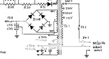

Looking over these designs I see something new to me:
The PT secondary HV centre tap connects to the middle +/- of the first filter cap node.  I am thinking this raises the B+ voltage higher than with just the 360-0-360 Pt specs?
This could be where the higher than typical B+ comes from, correct?

« Reply #22 on: March 15, 2015, 09:02:05 pm »
The DC voltage at the transformer centre tap is exactly 50% of B+, so this circuit is a simple way to provide a reference for the junction of the series filter caps. In amplifier designs where the screen voltage is required to be 50% of the plate voltage, this centre tap arrangement is a very effective way of generating the screen supply.
The diode bridge in the above drawing is incorrect - the bridge needs to be rotated 90 degrees counter clockwise.

« Reply #23 on: March 15, 2015, 09:25:44 pm »
Makes sense with the CT. Learned something new.  Seems obvious now.
Yes i saw the rectifier was incorrect.  This was pointed out in another forum as well, which may be where i found it.

The long overdue project continues….
This project gets put on the shelf when I have requests to build for others.  It's been a while now but I finally have a weekend free of other's amp work so onto this project for a few days.
My goal this weekend is to get the metal chassis drilled and primed and possibly the first coat of paint completed.  My idea is to paint the outside and inside of the chassis with a hemi orange enamel spray paint.
I have been working on the chassis layout and this is what i have come up with.  I need to ask some opinions on the orientation of the output transformer.  Which way would you face the OT laminations? vertical or horizontal? Or would it even make a difference?
My thinking is to mount the OT with the laminations going horizontally because I think there may be less "magnetic flux" or force-fields going directly into the preamp tube area (top right of the pic), if it were to be mounted with the laminations going vertical.  Horizontal concerns me because they are in the same direction of the PT. Or are they far enough apart  that it won't matter?
 :w2:

Here is the chassis inside layout so far
  • Posts: 5332
Re: Orange Project
« Reply #48 on: November 07, 2015, 05:35:04 pm »
Your layout resembles a Sunn. Maybe this will give you some ideas. I can post a gut shot too if this looks interesting...
