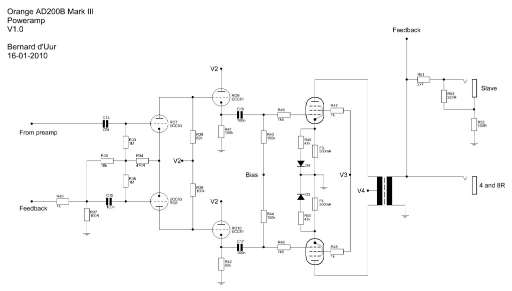

So I've been wanting to make a solid bass amp, and a friend of mine owned an AD200 that he loved. The 200W is a little much for my needs so I was wanting to make a 100w version, with only 2 6550's. Going off the spec sheet for the 6550, that means I need to shoot for 600V plate voltage and 300v screen voltage. A schem I found for the AD200 says that plate is 660 and screen supply is 375 before the dropping resistors at the screen pins.
The schem has the Screen supply coming off a separate secondary tap of the transformer. I can't find any transformers wired like this (other than the Mercury Mag drop ins that are for the 200W AD200 and 400$ per, yikes!)

Or is it necessary to have a separate screen supply? Or can it just be had off the main HT, assuming a current capable transformer? The AD200 seems like a very simple amp, just 2 Ecc83, (preamp and phase inverter) and an ECC81 as a cathode follower between the PI and power tubes? the biggest problem so far is the transformer issue, finding a suitable OT seems easy, but the PT is the toughy. Any recommendations are  greatly appreciated.
http://www.prowessamplifiers.com/schematics/images/AD200BMarkIIIPI.jpg
http://www.prowessamplifiers.com/schematics/images/AD200BMarkIIIPreamp.jpg

If your target voltages are 600 for plate and 300 for screen, then a 424VAC CT, AKA, 212-0-212VAC would easily give you both using the attached circuit. Go to Hammond's website and see if anything  with 300mA to 400mA current capacity comes close.

The whole point of the 600V/300V condition on the very large tubes is to use the split-voltage power supply scheme that Sluckey showed you.
Yes, 210V-230V AC each side will rectify-out to about 300V DC (that 350V transformer will give 495V or 990V DC!)
One 240V winding can be used in a voltage-doubler affair to give about 670V DC and a half-tap for screens.
The target voltage in the Suggested Conditions is 600V full-load; there will be considerable sag in any PT you would want to lift. The rated Max voltage on 6550 is 660V Ab Max; however this is routinely violated (say 700V, not 990V!).
