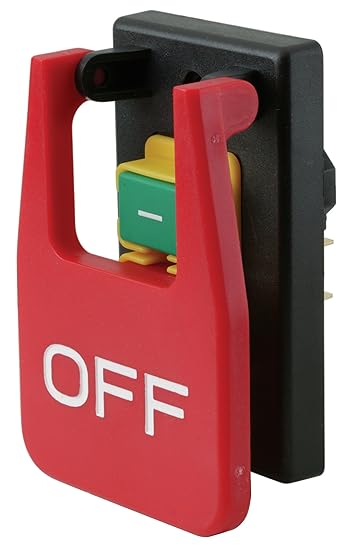

> Double pole light switch and the Ryobi table saw
Too late; but I really like this for table saws:
https://www.amazon.com/gp/product/B005W17HYY
I think the BIG stop paddle could be a hand-saver.
This version has magnetic latch. If the power fails, it goes to off. That way when power is restored, the saw will not run unexpectedly. That's a fairly common thing on large power equipment.
I use a non-latching switch on my furnace. If flames are shooting out of the cellar, I want it to be easy to kill. But if power goes out, then back on, I'm OK with the furnace re-starting. This might also be attractive on a punk amplifier.
https://www.amazon.com/gp/product/B005W17FRS

Never to late to replace plugging and unplugging :wink:
It took a long time to become the ditch digger my mom always said I'd be.
          I once worked in a furniture factory , cutting parts for frames , nothing like a big bandsaw blade popping to get your attention.  The supervisor would say "can you do that faster?" Those end bore saws would work pretty fast. It's amazing I still have fingers.  :l2: When someone managed to cut off a finger the whole plant would roar with laughter  :rolleyes: Always wanted to run a Mangler.
I still need a switch so thanks for the link.
