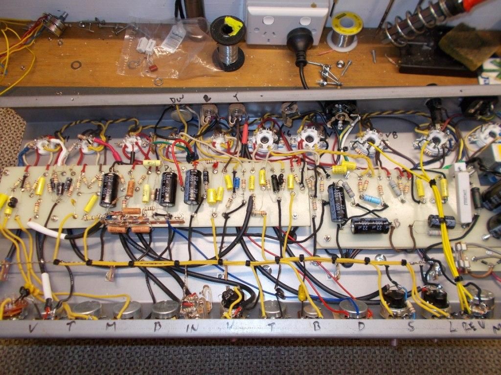

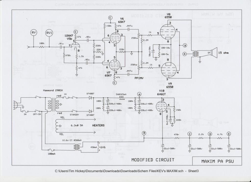

Hi guys, I thought I'd try again with this tremolo to minimise the ticking.
I had better success this time and the circuit is working well, no loud thumping. (last effort)
The ticking is just loud enough to be annoying. I have the feeling it is what it is.

I can't help you with the ticking, ut I like that you're modulating the screen of the pentode for trem.
Was that your idea, or have you seen it done before? I've been thinking about trying it myself.
  • Posts: 2936
Re: Another go at this Tremolo.....
« Reply #2 on: April 03, 2017, 01:07:48 am »
Hey Tony Bones, It's not my idea as this is a clone of a local made amp from some time ago.
If you look at the schematic there is some out of the box thinking with other parts of the circuit.
Here is another circuit that has a similar tremolo.
http://www.ozvalveamps.org/playmaster/pm102circuit20090624142858_00002dlch.jpg
Again, I'm not sure how well it works.

Hi guys, I think I have this sorted.
I simply added a .1 cap to pin 1 of the EF86.
The thump is completely gone with no loss in trem strength.
This cap usually appears on this pin in most circuits, so I guess it can be added. :dontknow:
Offline Tony Bones
  • Posts: 266
  • Thread Killer
« Reply #6 on: April 07, 2017, 01:03:54 pm »
I think of that cap as mainly a bypass cap much like the bypass cap around a cathode resistor. There are signal currents flowing through the screen.  Without that cap, the AC signal currents produce an AC voltage drop across the big dropping resistor and effectively modulate the screen voltage. This is exactly the same as AC signal currents through an unbypassed cathode resistor producing AC voltage at the cathode. In both cases it results in negative feedback.
The screen bypass capacitor can be so much smaller than the cathode bypass capacitor because the screen dropping resistor is so much larger than the cathode resistor. Do the math: the corner frequency of the high pass filter is f = 1/(2*pi*R*C)  (Really, the value that you should plug in for R is the parallel combination of the cathode resistor and the impedance looking up into the cathode, or the dropping resistor and the impedance looking into the screen AND the impedance looking into the trem circuit, all in parallel... yikes, this is getting too complicated.)
Anyway, I don't know why leaving that cap out would cause thumping, but if adding it fixed the problem and doesn't interfere with tremelo operation, then that's good, right?
  • Posts: 2936
« Reply #7 on: April 07, 2017, 03:48:59 pm »
Thanks Tony Bones, More complicated than I'll ever understand.

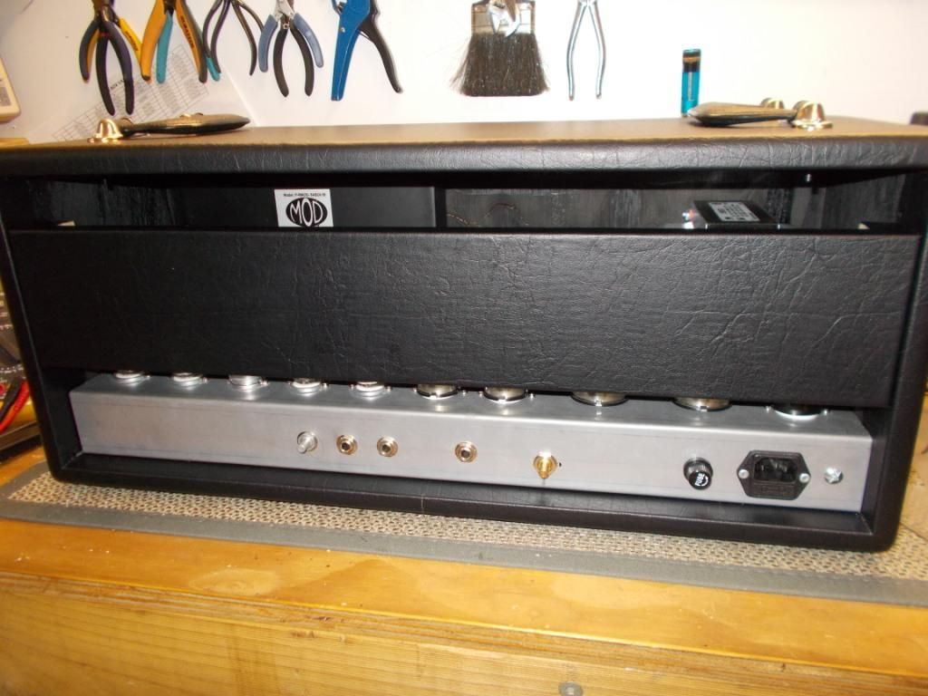

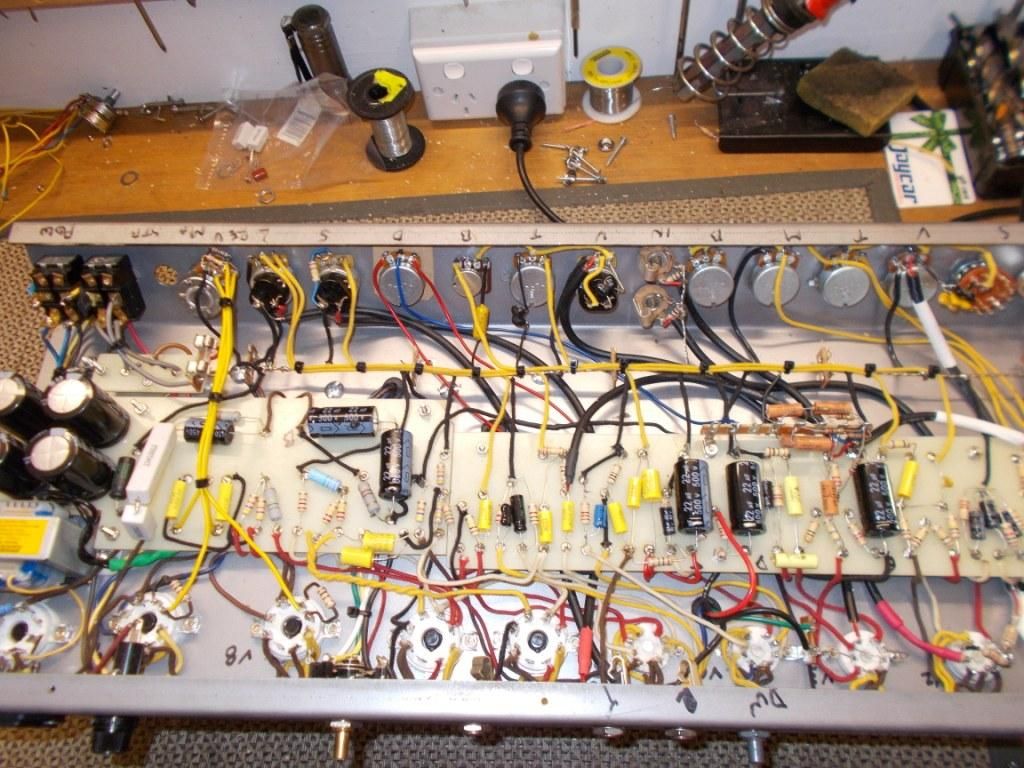

Hi guys, Some pics of the final product. (needs faceplate and knobs)
