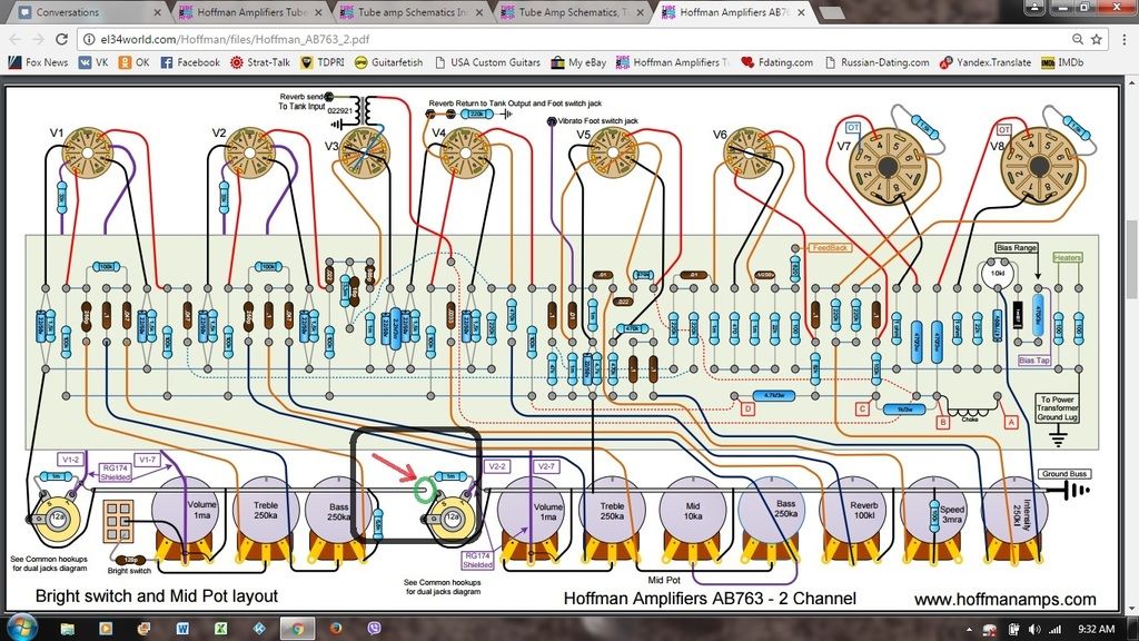

Re: Joe Walsh Mods
« Reply #17 on: August 08, 2017, 04:41:15 pm »
This is the amp that Original Formula was used in.
Mark,
I don't have a schematic do you? I may not need it? Can you confirm - after a quick look at that layout it appears to be a paralleled 12ax7 into a CF stage then LTPI into a quad of el84s?

Re: Joe Walsh Mods
« Reply #19 on: August 09, 2017, 12:34:54 am »
EF86 tube.
Note by Doc: The RX has a full EQ and a EF-86 as a recovery stage.  The 3 dB boost runs on the EF-86, added by-pass cap to the cathode, for a nice FS lead boost. It uses negative feedback which keeps the amp tight  great for humbuckers. Also it uses a split load cathode bias so two differant pairs of EL-84's can be installed.  Yes a simple series loop can be fitted.  The Master is a dual ganged PPI type, with very little if any tone change.  The Brake-Lite will work with the stock RX ES, it will get hot..... but it will be fine
Thanks again, however questions please (unless you have a schematic?):
1) I think he meant to say "the ef-86 'has' a recovery stage"?
2) The plate and screen on the ef86 is together so it's being operated in triode mode - is this how it's supposed to be?
3) What's with the 56k going to ground at the tone stack dropping resistor and 250pF point? Is that correct to the schematic? Never seen that before it is. That would put quite the load on the signal at that point losing a lot of gain especially with the recovery stage prior...thinking what would the point of that be (unless it's another way of dropping but unlike the two 220k's leaving from the ef86).
4) The recovery stage's cathode bypass cap goes to the switch then through a mislabeled 480r resistor? Something seems amiss there too?
  • Posts: 5838
Re: Joe Walsh Mods
« Reply #20 on: August 09, 2017, 01:37:59 am »
V2 in the image above is 12AX7 gain stage DC coupled to a CF. do y'all have a layout with EF86 as the recovery gain stage? also, that layout reads very "5F6-A bassman-ish" at least the preamp is.
footnote: missing 1M grid-leak at input jacks.
