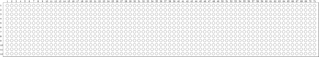

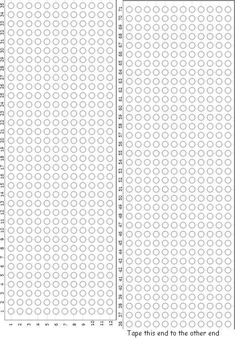

Here ya go
Take either one of these images and scale them to whatever scale you want
Printed at 100% scale, you should end up with a template that is 3.125 inches tall and 18 inches long
The grid is 0.25 inches square
This is the link to the full uncut 71 column image for the new program
http://hoffmanamps.com/php/TurretBoard/Images2/Template_71_Columns2.png
This is the link to the two piece 71 column image for the new program
http://hoffmanamps.com/php/TurretBoard/Images2/Template_71_Columns.png

Also, because it makes a finer grid and it's easier to find a hole that suits you when laying out parts
In a 18 inch x 3.125 inch template In now I have 71 columns and 12 rows
It was 60 columns and 10 rows
The new program is still being tested so the old program with 60 columns still is active

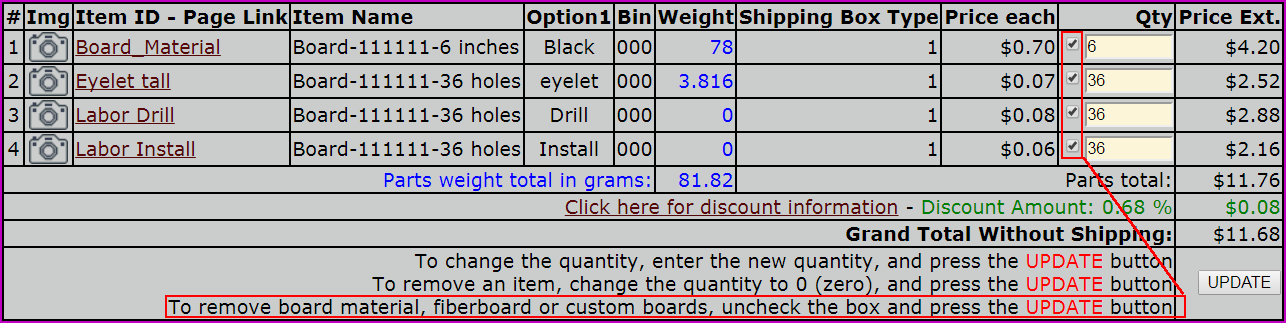

Here's another update to my on line custom board program
You can now add your custom board to my shopping cart
Go to this post for more info about that
http://el34world.com/Forum/index.php?topic=22787.msg243673#msg243673
