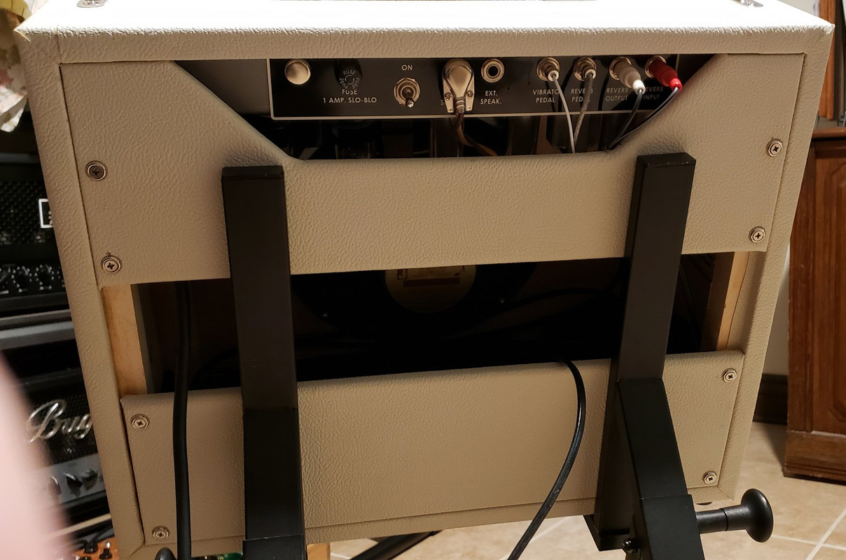

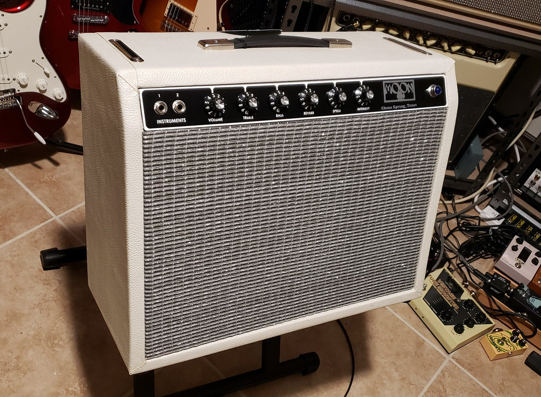

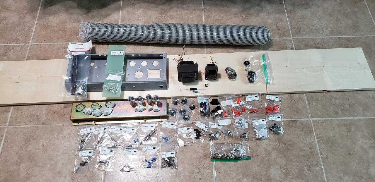

« Reply #10 on: July 19, 2021, 12:29:55 pm »
She came out real purdy.
I ordered the standard 2 spring tank as the 3 spring I'm using is too crazy reverb. Also some 90 degree RCA cables.
It started like this.
Finished
