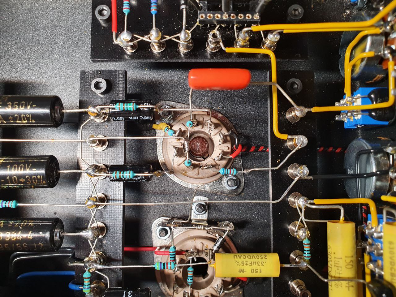

Hi, I'm a new member looking for help with my amp build. For my previous builds I have found a lot of usefull information on this board and I want to thank you for sharing this impressive knowledge to the world, helping others to advance in this hobby!
I attached the schematics of the amp I'm building. This is the first time I'm using 6SL7s. I've always worked with noval tubes and wanted to try something different this time. I almost completed the amp except for the negative feedback loop and its attached controls. At lower gain settings it's working fine, but higher gain settings result in squealing. At mid gain you can also hear the oscillation creep into the overtones, resulting in a somtimes unpleasant overdrive sound. So obviously something is not right here. I tried to narrow down, when and where the osciallation is occuring with a scope:
both gain controls behave the same way: oscillation sets in once a certain point on the pot is reached. The point is roughly the same for both pots. If you turn up the gain, the oscillation frequency goes down. All four bright caps increase the freqency.
both volume controls can adjust the oscillations volume but have no other influence.
Pulling V2 and V3 I could still observe the oscillation along the signal path up to R10 at high gain settings. I completly disconnected R12 and C6, no changes. Pulling any of the load resistors of V1 got rid of the oscillation. Therefore it seems to me, that both triodes of V1 are somehow interacting. I also removed the relay, removed the fuse for the relay power supply and hard wired the first pot to be the only gain control.
Here are my voltage readings on V1 (V2 and V3 are still pulled, all pots are set to 0):
1(grid1):0V
2(anode1): 196V
3(cathode1): 1.92V
4(grid2):0V
5(anode2): 184V
6(cathode2): 1.78V
7(heater1): 70V
8(heater2): 77V
I have elevated the heaters and use dc for V1 and V2. These voltages seem ok to me (heater voltage will drop to an acceptable level once the other tubes are reconnected).
What I've tried so far (schematics show the currrent state):
  • increase grid stopper from 10k to 68k on both V1 grids (oscillation is now stetting in later)
  • shielded wire form input jack to V1 (no changes)
  • decrease coupling cap C1 to 4n7 (no changes)
  • decouple B+ for both stages (no changes)
  • completly remove the volume pot and hard wire C1 with a 1M grid leak resistor to R7 (no changes)
  • unmount the input jack and move it around to see if it has any influence (no changes)
  • change tubes (I don't have a veryfied working tube, but I tried 4 different tubes from different brands - no changes)
  • run 470pf between cathode and anode of the first stage (oscillation stops but at full gain unpleasant overtones are still present. If I disconnect the guitar from the guitar cable, the amp squeals again. Increasing the capacitance muffles the tone too much)
Using the chopstick method, the only thing I could find was that the oscillation volume increases if i poke at the tube socket around pin 2 (second stage anode). Moving other components didn't have any impact.
here are some images of the socket of V1:
The wires near the input jack connect the front LEDs, front switch and relay to the footswitch jack and the power supply. In my current setup they are unused because I removed the fuse of the relay and LED power supply. The wire running underneath the input jack connects the volume pots to the passive effects loop. It's currently unused as well.
Honestly, I have no idea what to try next. I already started to wonder, if the tube socket can cause all this. But I think it's very unlikely. Any help would be greatly appreciated!

Without  complete gut shots, it’s difficult to form an opinion about cause of oscillation. You’ve obviously laboured to get such an exquisitely tidy build. However, without a complete picture of the layout it’s hard to see where unwanted coupling might be occurring. You seem to have runs of wire going from pots across tube sockets to other parts - could be emf from high-VAC terminals and leads coupling into low-current signal wires but hard to say.

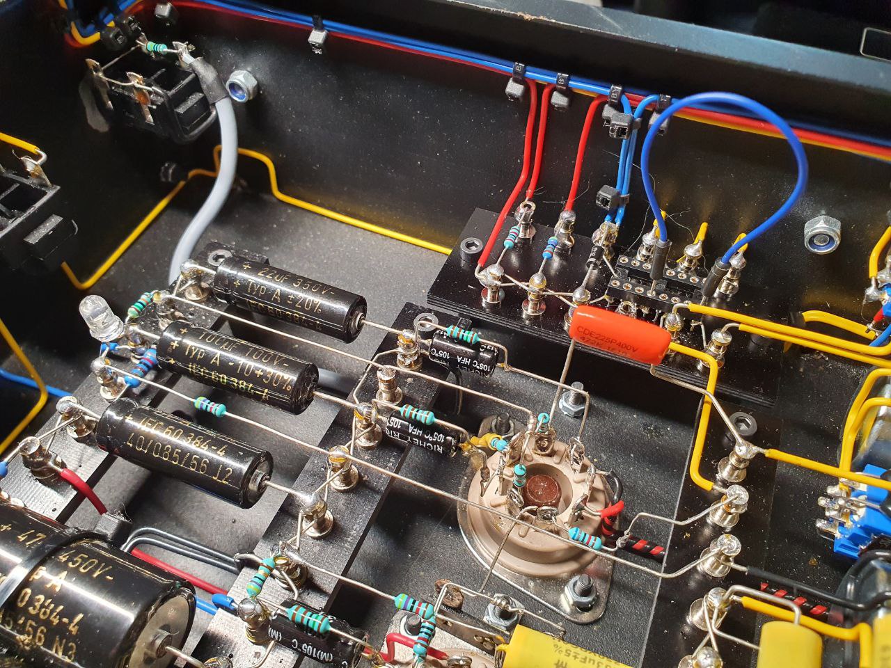

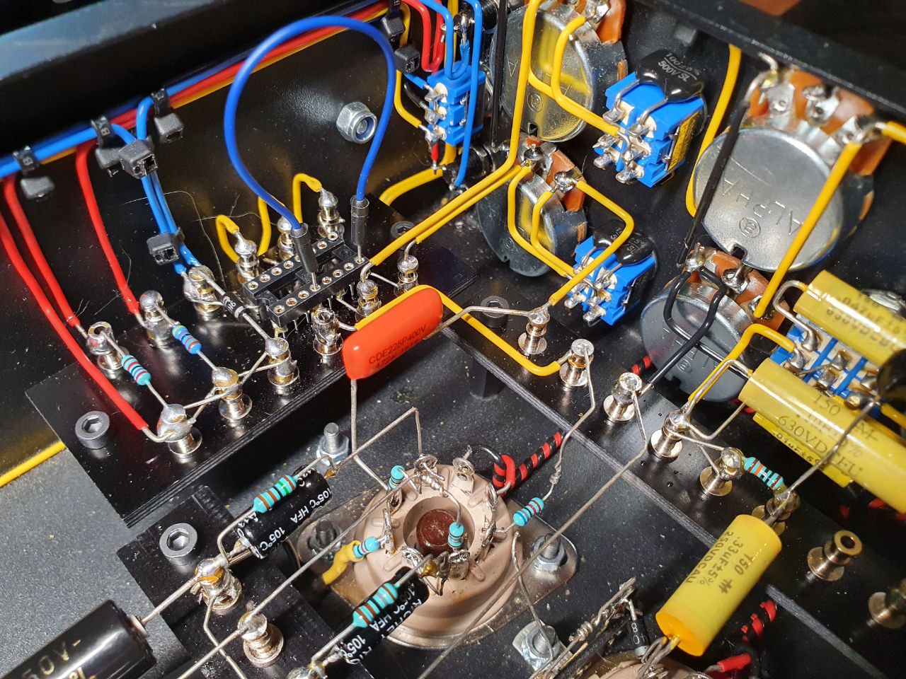

Thanks for your reply, tubeswell! Here are some pictures of the whole circuit. All the wires going from pots across the sockets are ground wires. I also scoped B+ to see if the power supply is part of the oscillation, but I only get some very minor ripple (about 20mV).

I am jumping in here, not with solutions but with questions. I note that Tubeswell is one of the experts here, but there are many others (I'm not one of them, just a confused hobbyist) that have not replied. I wonder if that is because they are thinking, like I am, that the workmanships is really nice, but man-o-man you sure have a lot going on in that amp. The more components and the more connections the more things can go wrong.
Random thoughts:
You say you can hear the oscillation up to R10 - does that mean you are using a listening amp? If not, I would suggest that so you can better identify where in the circuit noise develops. Removing components and testing gets tedious after the first 40 hrs, eh?
Are you sure you are not overdoing the gain in the amp? Off-hand, with 2 preamp tubes feeding one 6V6 I do not see much to attenuate the gain.
Is this a known circuit? Can you describe what you were going for?
My apologies if I am asking stupid questions, but I am trying to stir up some interest from the experts on the Forum. Good luck.
Mac

I'm using an oscilloscope to trace the oscillation. I have disconnected R12 from the second triode and removed V2 and V3. So the only active part in the signal path is currently from the input jack to the anode of the second gain stage. The rest is disconnected. I can observe the oscillation at both grids and anodes of V1. Disconnecting any one of the load resistors of V1 gets rid of the oscillation, so it seems to me that there is a positive feedback loop  within V1a and V1b. I can add a second schematic which shows the amp in it's current state, if that's helpful.
This isn't a known circuit, but I've already built almost the same amp with 12ax7s and a 6aq5 (that one doesn't have switchable gain and volume controls, lower B+, no gyrator and is cathode biased). You are right about the gain, it is too much for a 6V6. One goal of this build is a single ended power amp that can take a 6v6, 6L6GC or an EL34 because I wanted to see if I'm able to hear differences between them. My OT has a 5k primary tap which I use for the bigger tubes and a 10k tap which I use for the 6v6. The bigger tubes need more gain. So my plan was, to tame the gain down, once the amp is up and running, to find a good compromise for 6v6 and 6L6/EL34 operation. The power amp is already working. I've tested it by playing trough the effects return input when all the tubes were pluged in.

… I can observe the oscillation at both grids and anodes of V1. Disconnecting any one of the load resistors of V1 gets rid of the oscillation, so it seems to me that there is a positive feedback loop  within V1a and V1b…
I think you’ve answered your own question

This is the exact approach I took and I came up with this minimal circuit, which still produces the oscillation (see attached schematic). I've now removed the gain pot again, and changed it for a 470k grid leak right at the socket, simulating a dimed gain pot:
Still the oscillation remains. I can't see any faults on the wiring, chopstick poking and bending components around does't change anything.
I haven't tried to remove the cathode bypass, which might fix the oscillation but will also reduce the amount of distortion I can get from the preamp. If possible, I would like to avoid that.
