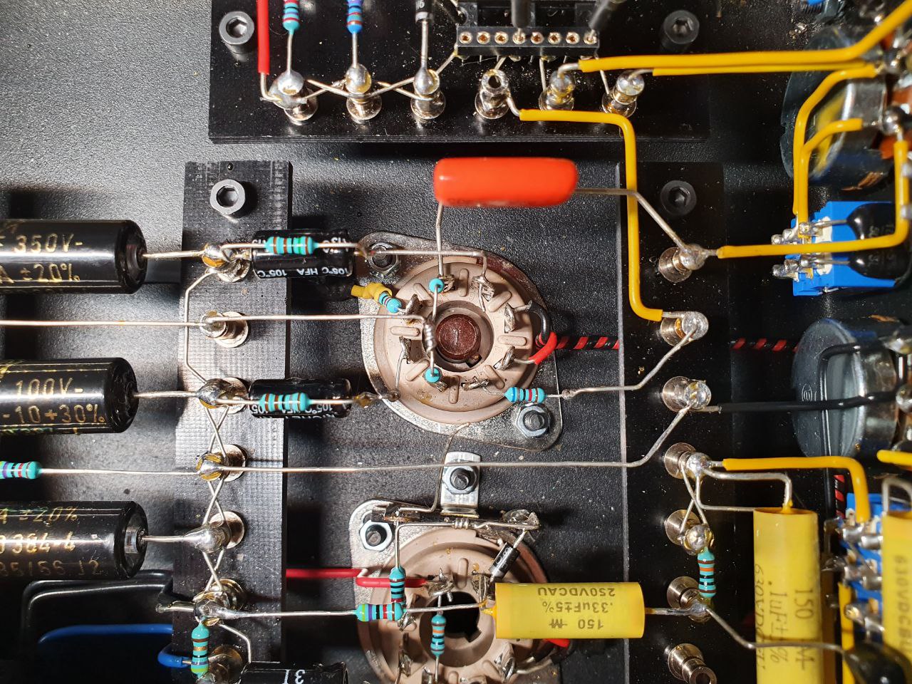

here are some images of the socket of V1:
The wires near the input jack connect the front LEDs, front switch and relay to the footswitch jack and the power supply. In my current setup they are unused because I removed the fuse of the relay and LED power supply. The wire running underneath the input jack connects the volume pots to the passive effects loop. It's currently unused as well.
Honestly, I have no idea what to try next. I already started to wonder, if the tube socket can cause all this. But I think it's very unlikely. Any help would be greatly appreciated!

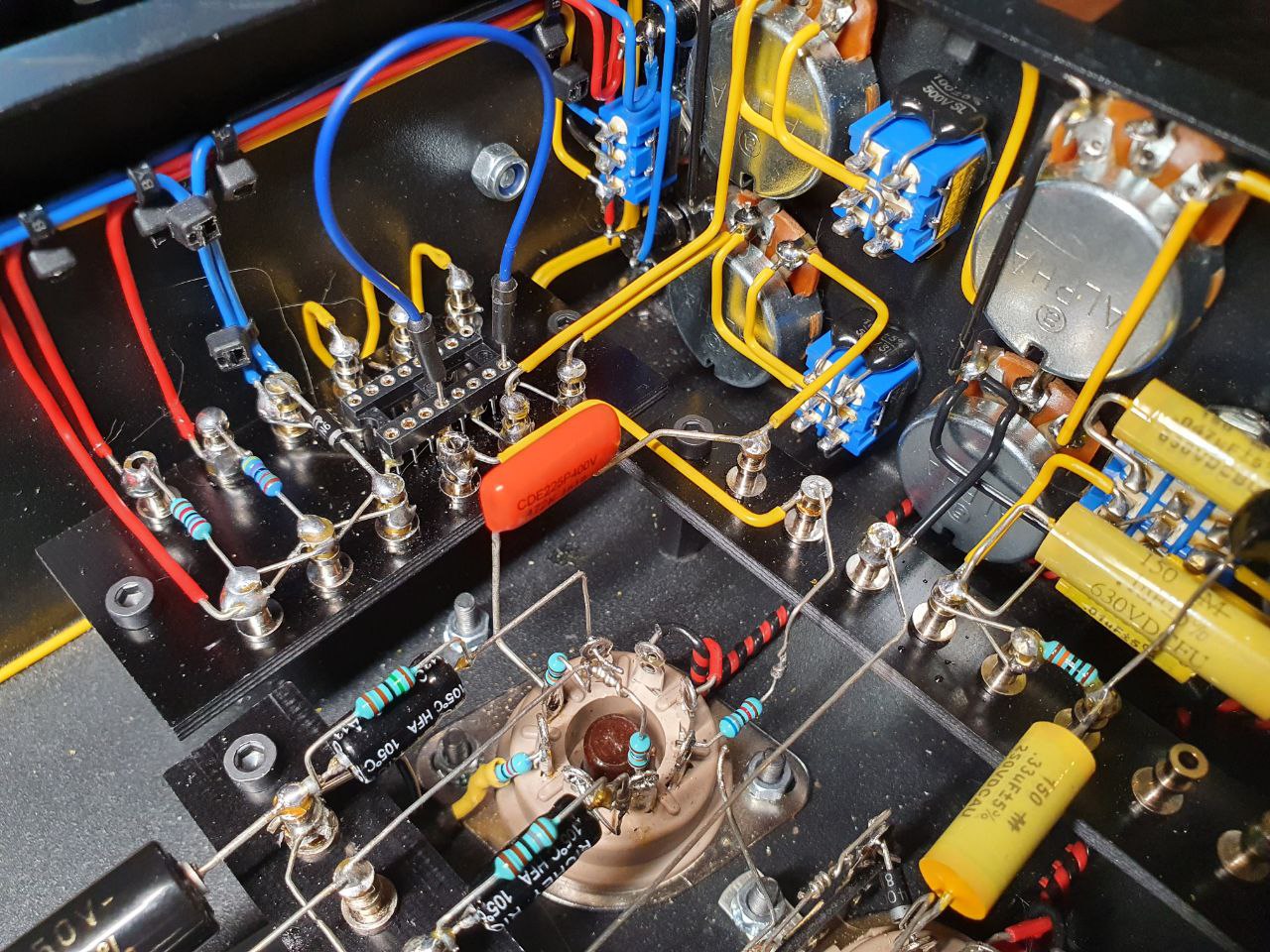

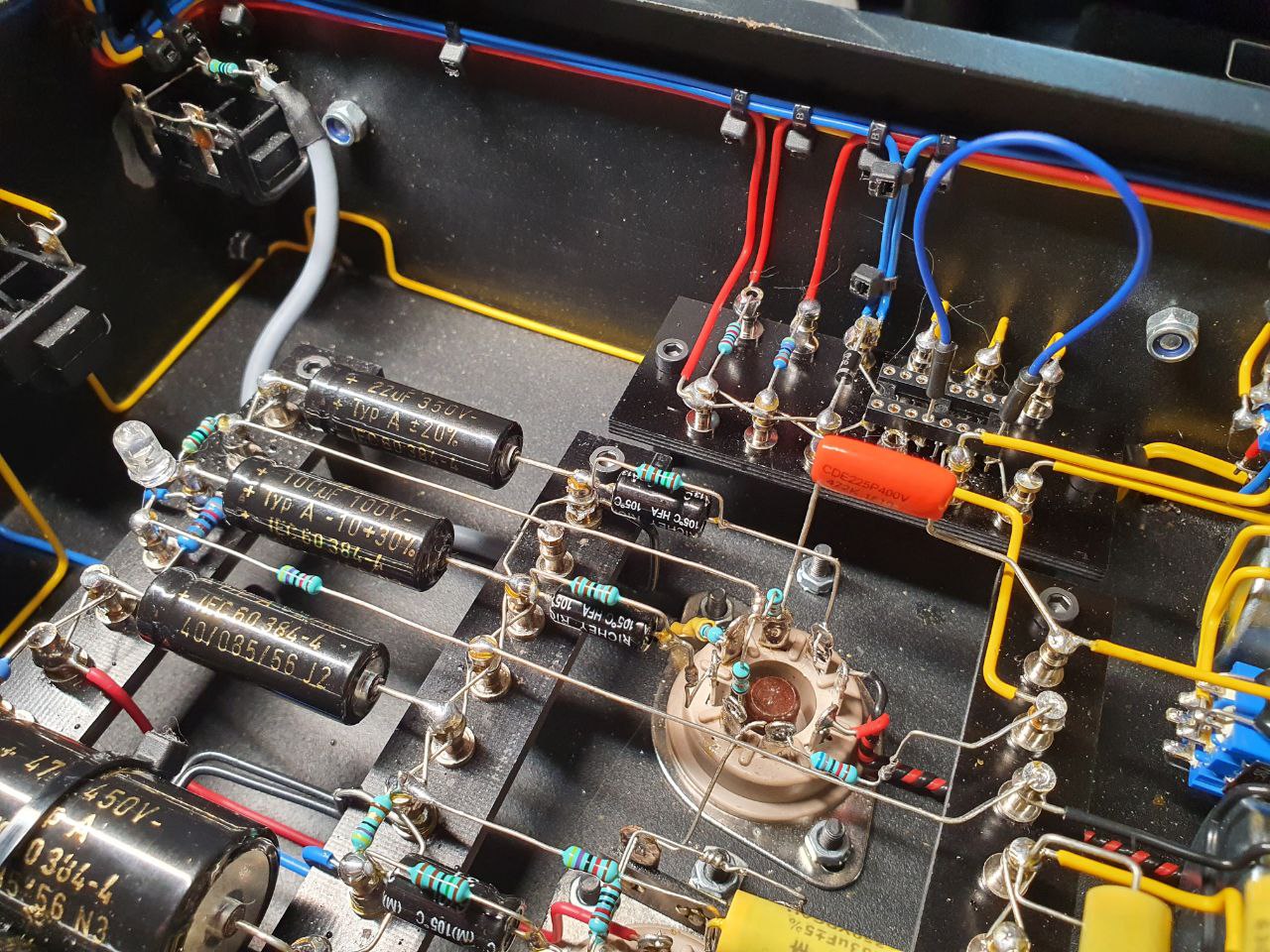

Without  complete gut shots, it’s difficult to form an opinion about cause of oscillation. You’ve obviously laboured to get such an exquisitely tidy build. However, without a complete picture of the layout it’s hard to see where unwanted coupling might be occurring. You seem to have runs of wire going from pots across tube sockets to other parts - could be emf from high-VAC terminals and leads coupling into low-current signal wires but hard to say.
Offline Molwam
  • Posts: 9
Re: Oscillating 6SL7 ptp preamp - am I missing the obvious?
« Reply #2 on: April 14, 2022, 09:34:21 pm »
Thanks for your reply, tubeswell! Here are some pictures of the whole circuit. All the wires going from pots across the sockets are ground wires. I also scoped B+ to see if the power supply is part of the oscillation, but I only get some very minor ripple (about 20mV).
