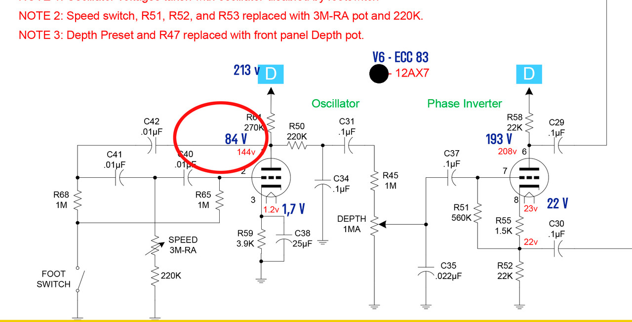

I've also been bothered by the positive voltage on pins 2 and 7. So, I put my amp on the bench, set the variac to exactly 120VAC, and warmed the amp for a few minutes. Here are the voltage readings for V4 on a properly working amp...
pin 1 = 73vdc
pin 2 = 0vdc
pin 3 = 3.3vdc
pin 6 = 74vdc
pin 7 = 0vdc
pin 8 = 3.3vdc
I'm beginning to think your board 'may' be conductive. What material is the turret board? Doesn't look like fiberglass. The board looks pretty dirty in that poor quality pic you posted. The turret column spacing is 1/4". That's pretty tight. A clean, high quality board is important.
What brand and model number is your meter?

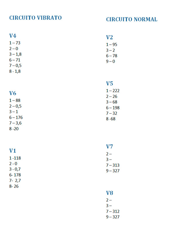

I have measured it with a multimeter in VDC. I will measure it with an oscilloscope
« Last Edit: June 08, 2022, 02:09:34 pm by rafaelctt »
Offline rafaelctt
  • Posts: 199
Re: Vox Ac 15 vibrato problem
« Reply #52 on: June 08, 2022, 02:04:17 pm »
Are you sure that’s a VDC (average) measurement, eg rather than instantaneous?
One grid looks to be -2V, the other +2V.
« Last Edit: June 08, 2022, 02:08:57 pm by rafaelctt »

When you measure 2vdc on pin 2 or pin 7 is it possible that your scopemeter is really displaying 2mV and you are mistakenly interpreting that as 2V?
We've eliminated all the logical paths for 2vdc to get on the grids. Time to look at some illogical paths such as conductive board. Try this. Connect one meter probe to chassis ground. Now use the other probe to poke the board near the turrets that the V4 components are connected to. You should not measure any voltage on the board at any point.
Tomorrow I will do the measurements again with an oscilloscope. Should I do it in VDC or VDC+AC? For these measurements, do I disconnect C24 and C23 or is it not necessary?
I understand that I should get 0V on pin2 and pin7.
I have bought all the components that surround V4 and if I don't get those measurements I will simulate it externally. I'll do it with a 12AX7. I imagine I must also get 0V on those pins.

VDC only. No need to disconnect anything.

The oscillator does not oscillate. I measure it with the oscilloscope and find no oscillation. n the simulator (Proteus) if it oscillates and I have the same component values
  • Posts: 5401
« Reply #71 on: June 12, 2022, 11:30:28 am »
You told me in a PM that you measured 30V on the board, meaning the board is conductive. You are wasting your time doing any further checks. Replace the board with a high quality G-10 fiberglass board and start over.
I understand and sympathize with you since Hoffman won't sell you the board due to the crazy VAT laws. You probably would not pay the price even if Hoffman would sell to you. So, you will have to make your own board again with a better quality board. I know you said you could not find a blank board that's long enough, but you still have options. The board is laid out such that there are several logical places where you could split the board and use two shorter boards. Or, you could cut your losses and use the parts to build another amp that uses a shorter board, such as a Marshall 18W or my Dual Lite.

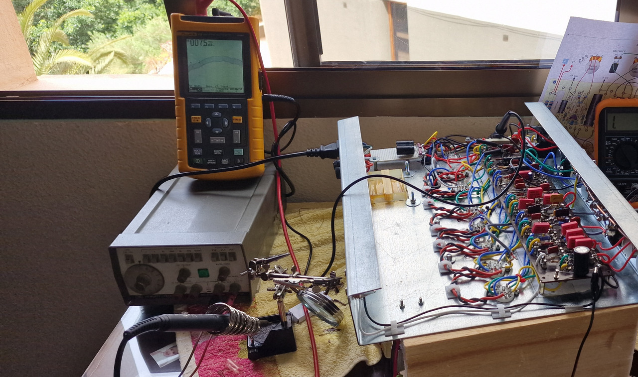

Tomorrow I'll start building the circuit around the V6 on a separate board as a prototype. I'll go step by step. The clean circuit works very well and so does the vibrato preamp stage. So I will focus on the V6. Thank you very much. I will inform you.

Hello!! I have already built a simulation of the circuit around V6(oscillator). How can I check with the oscilloscope that it is oscillating? At what frequency and with what voltage does it oscillate and on which pin can I measure it?
Thank you

The oscillator signal is a big sinewave. Frequency is between 3 and 10Hz, depending on the speed pot setting. I suggest setting the speed pot about midrange and set the intensity pot to zero.
Connect your scope to the ungrounded lug of the intensity pot to view the waveform.

Another way to tell if the oscillator is working is to measure the DCV on V6 pin 1. If the voltage is steady, it ain't working. If the voltage is constantly changing or erratic it is working. The bar graph on your meter should be moving at the speed of the tremolo.

Well, it seems that everything has gone well.
I have built it off the board and it has worked perfectly.
With which I only have to implement it on the circuit.
  • Posts: 5401
« Reply #79 on: June 18, 2022, 03:52:51 pm »
Does this mean you have built the ENTIRE AMP off board? Could we see pictures?
Offline rafaelctt
  • Posts: 199
« Reply #80 on: June 19, 2022, 11:09:19 am »
No, I have built the vibrato circuit (V6) off the board. the rest the same

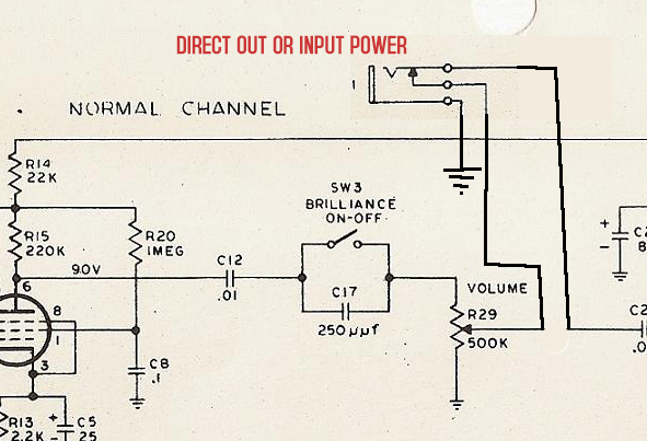

Good morning, a question. I could have a direct output or use the power zone (EL84) with an external jack if I interrupt the central volume contact (R29)?
« Last Edit: June 21, 2022, 02:07:59 am by rafaelctt »
  • Posts: 3147
« Reply #82 on: June 21, 2022, 03:41:46 am »
That will work as a power amp input.
As drawn, the signal from that preamp will be disabled when a plug is inserted.
Is that how you want it to work?
  • Posts: 5401
« Reply #83 on: June 21, 2022, 09:32:40 am »
You need two jacks if you want a preamp output ***AND*** power amp input available. Notice this does not apply to the VIBRATO channel!

Yes, I had thought of that or a jack and switch to use it as a direct out or power amplifier. It could even be used to daisy chain an external effect. Of course it would only work on the clean channel.
