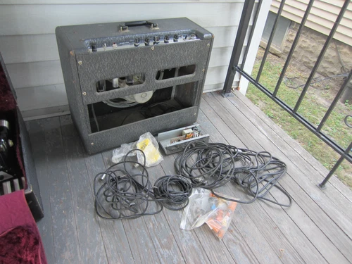

I picked up an Epiphone century today it is missing the tremolo tube, the schematic calls for an 6sq7 but this is wrong as the amp never had an octal socket (anyone know the tube they used?) or the equivalent Gibson model? It has a 15" Jensen alnico with a "7" year date, but I believe it's a newer replacement. I think the amp is an early 60ish It has had the electrolytic's redone at some point.... and a 3prong that is iffy at best .....I am going to redo that. the polarity is still wired in the circuit, and the death cap is on it (Not Good) I'll bypass that switch ....Thanks for the tube info in advance , It's actually a different preamp tube line up than the schematic 6eu7's and a 5879....i think it might want a 6eu7 for the tremolo?
6EU7 is a 9 PIN wired NOT like 12XX7
Besides the heaters pins 1&2; only 4,5,& 6 are wired .....1/2 of a 6eu7 would only make sense

This is the only schematic I can find of the epiphone century, the tube lineup is not the same as my amp. The one with the ? mark is missing the two crossed out are 6eu7's in mine ....I am pretty confident the missing tube is going to be a 6eu7,but I'm not 100% sure.....The socket is wired indicating the same pin wiring as 1/2 of a 6eu7.....The next question would be can I trust the rest of the schematic
I have repaired several Gibson and Epiphone amps from that era and I think you are right about the 6eu7. They are found throughout both lines of that era.

I sorted out the 3 prong cord leaving the polarity switch unused (for now) Both the 6v6's are 1961 Gibson branded Raytheon's I, I found a G. Brit. 6eu7 and put that in the first position and moved the tube it replaced to the tremolo. It's funny how I decided not to fire it up until I fixed the 3-prong set up ....Which was totally insane. One of the speaker wires was connected by 1 yes One strand .....PO said it worked (One Strand ???) any way I discovered it when I needed to remove the chassis. Yes, the mahogany footswitch is with it and connected. The 9 pin sockets had rubber grommets that are pretty well gone....I will address them at a later date. I left it in the shop as the only thing needed is to resecure it in the chassis (Need extra hands and or patience to do that) and re-solder speaker.....This is my start on revisions on schematic

1961 Epiphone EA-25T Century | The Music Emporium
Mr. Resistor post this article and it cleared everything up. They made tube changes to the century amp ....I'm pretty confident that the schematic I posted is correct or at least very close with possible  value differences. Yes the sockets are riveted and will need to be addressed further on down the road .....I put it back together and I think this is the best amp I own. Dead quiet and two distinct channels ....vibrato on the second channel  eewwwww it's good. ....This is  a GA-20 in it's best form IMHO

All original except the electrolytics Spragues) and the burlap grill cloth ....I had to put new feet on it too
