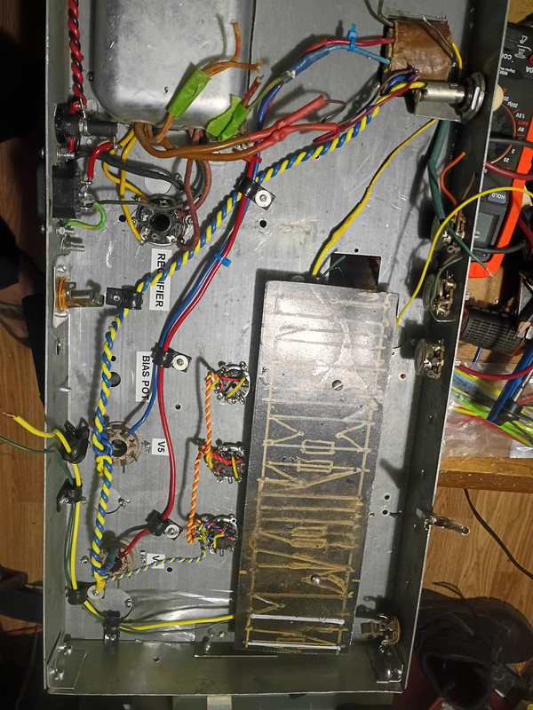

Hey guys, I do have a question here, The way the Heater twisted pairs are running, and the Blue and red from the Output tranny, with that as it is will the wires to the speaker jacks be ok were they are? in general will all the wiring be ok how it is run?? Thank you!!
Offline acheld
  • Posts: 1401
Re: First amp build
« Reply #3 on: May 29, 2026, 10:22:01 am »
Your heater wires are nicely twisted.  The priority is to keep your signal wires away from your AC (heater and mains) wires -- that's where you will have real problems.
Avoid running your output wiring in parallel with AC.  If you need to run output wires across heaters, which most designs will do, cross at or near 90 degrees and separate in the Z dimension, just like Leo did back in the day.

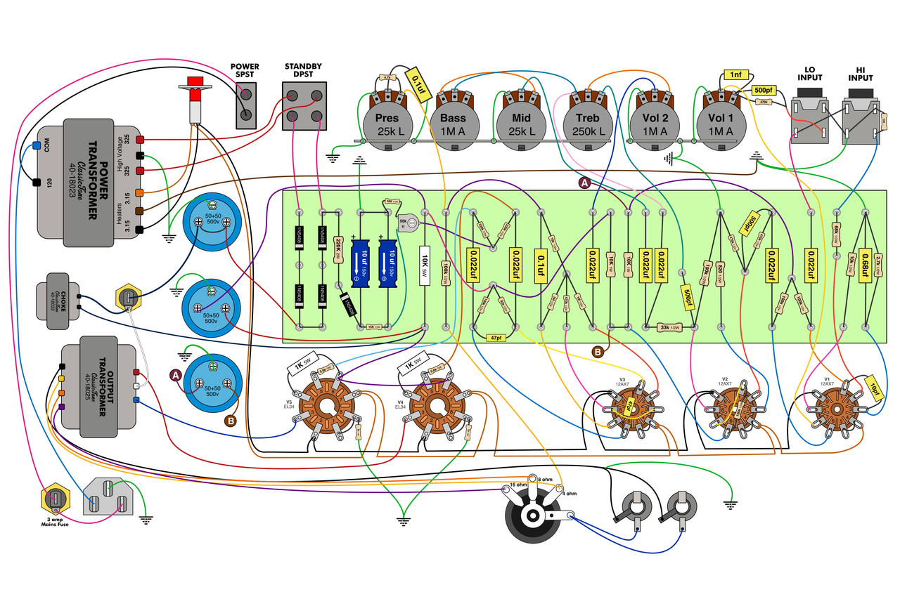

Don't get stuck on the wiring at this stage.   Do understand that this is a learning process, and have fun with it.
You should have a plan drawn out.  Much easier to erase pencil lines than desolder wires and re-drill holes!
For a first amp, I always favor Doug Hoffman's plans -- go to https://hoffmanamps.com/MyStore/perlshop.cgi?ACTION=enter&thispage=PartsListIndex.htm&ORDER_ID=!ORDERID!#google_vignette to find an amp similar to your design, and then check out the project links on the right, which will give you some ideas.

If this was my project, I'd relocate the output transformer closer to the middle of the chassis, so that the wires could be run in more of a straight line to the power tubes and output jacks. That hole you have near V2 and V3 would be where I'd put it.
By the way, what amp model are you aiming to build? Looks like a push-pull of some sort. Knowing that would help people give you advice.
  • Posts: 5377
Re: First amp build
« Reply #5 on: May 29, 2026, 11:20:07 am »
I believe your OT is wired wrong. That OT has three primary wires. Blue and Brown should go to the output tube plates and red (center tap) should go to B+.
I agree with dogburn. That OT is located in a bad place. I suggest putting it between the rectifier socket and the output sockets. That will simplify those long wiring runs and the problems they may cause.

acheld and Dogburn, and sluckey, Thank you for the reply's!
What I was hoping to build is a JCM 800 type 50w circuit, I don't know yet if the transformer is the proper voltage, The circuit I'm looking at is posted below,
I have been debating on moving the output transformer, so now Ill do that, and the signal wire advice will be taken acheld!
and sluckey, thank you for noticing that, I will correct that, mentioning the rectifier socket, using the diagram below, should I use the tube rectifier, or go with a Solid state rectifier here? I have already ordered a components kit with all the smaller resisters and caps, diodes, so whichever I should use would be fine with me!
 The turret board I'm using is 10" long so its a little cramped but should work, will there be a problem running anything under it given enough clearance?
I installed the proper fuse holder next to the power inlet, I have another on the way for the H.T. Thanks again guys!

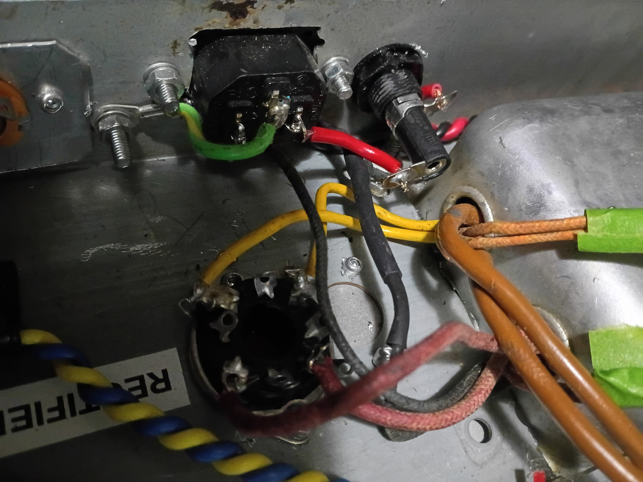

Offline Mongrel714
  • Posts: 74
Re: First amp build
« Reply #7 on: May 29, 2026, 11:42:59 pm »
From the output Tranny green and yellow wires to the speaker jacks, will the center tap (Black wire) go to ground?
THX!
Phones dead, Ill post the pic tomorrow!

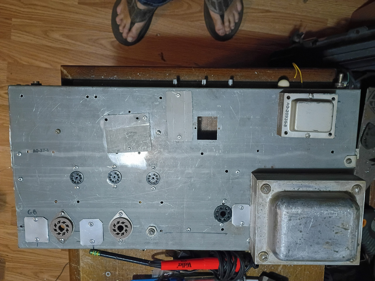

Are you planning on a set of EL34's in there?
I think those Hammond AO 20936-5 output transformers are for a pair of 6V6, not sure if one of the green and yellow wires may be for a specific feedback loop for that type of organ it came from [see this post on Hammond S6 from this forum]
https://el34world.com/Forum/index.php?topic=28335.0
The output transformers secondary wiring should be black to ground and green to hot on the output jack socket for 8 ohms, then the yellow is for a loop
I would recommend doing a JCM800 with 6V6 pair, 15w is plenty for home playing, I'm rocking a 2w JCM micro at the moment and its awesome!

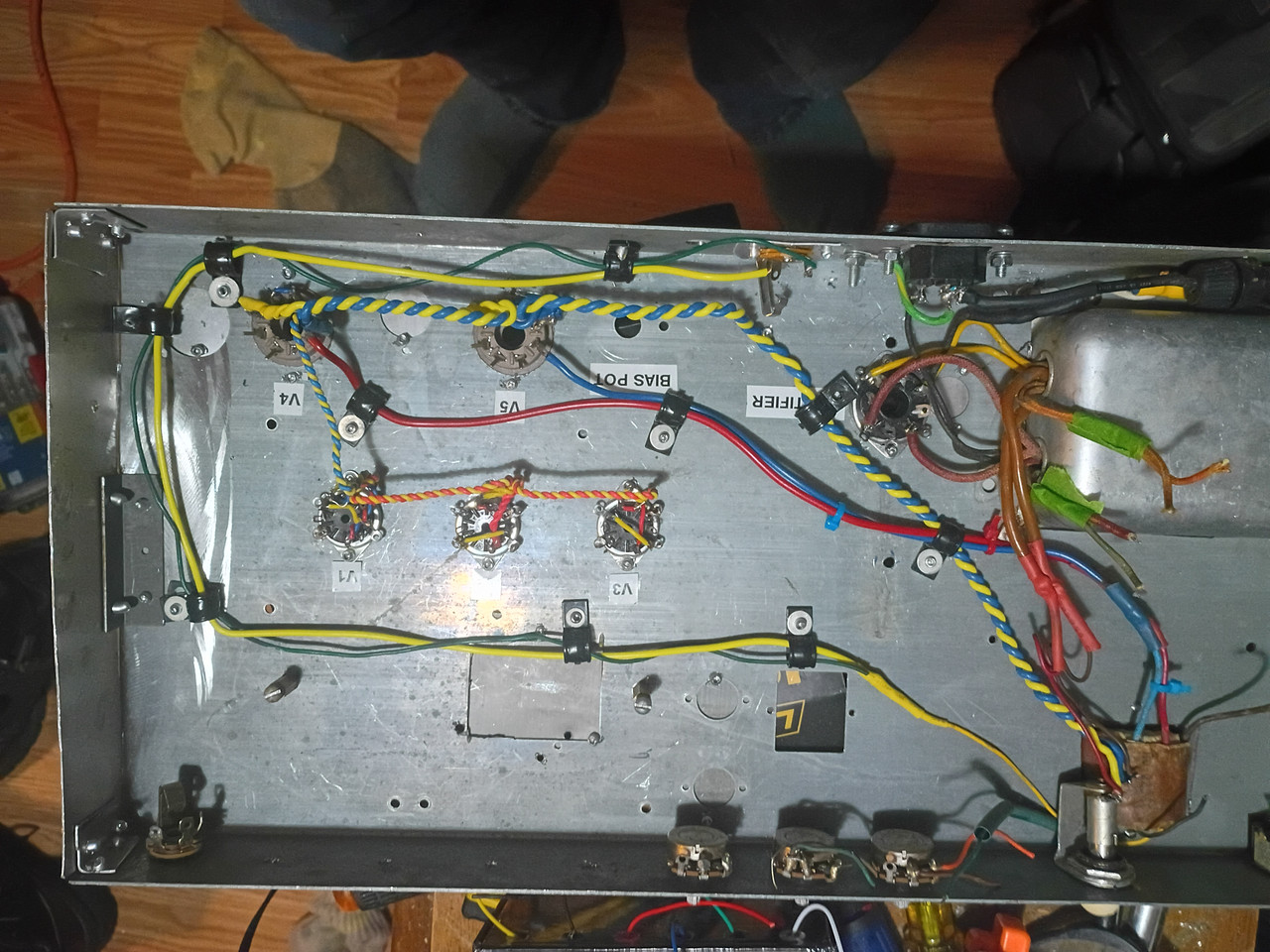

And by the way, I did move the OT guys,

This confirms my earlier comment that the OT was wired wrong. Do not connect the red wire to a output tube socket!
Another thing... Those transformers are designed for 6BQ5s or 6V6s. They will not be happy trying to work with EL34s!
And one more thing... The JCM800 2204 is a high gain amp. It will be very picky about layout. Your layout is far from optimized for a 2204.
BTW, the new location for the OT is much better.

I did a search to check the AO-37's original setup, saw your reply on 18watt forum, so was this amp from a F100 Extravoice Organ?
With this schematic? [page 24 for Power Supply and Power Amp] - https://archive.org/details/HammondOrganF-100ExtravoiceServiceManual/page/n24/mode/1up
I was just wondering what those other taps on the power transformer were for

The PT was in a separate small enclosure on the bottom with a terminal strip on the outside.
This is that strip, on the prior pic it runs top to bottom, switch end at top. It also had a separate socket maybe a test plug socket?

That's got to be a pretty massive PT, and it will certainly have the current to run all the tubes you have planned. Since it used a 5U4, the 5V tap should be rated for at least 3A.
Looking back at your photos, it looks like the amp model is AO-27, not 37.

Thanks for the input JPK, I have totally shelved that mess, I have a new chassis built and starting to assemble, Taking my time with it, Wanting this to be closer to JCM 800 2204 style, please keep the comments and help coming, I need it!

Will this work? if not which way should I go??

'"Im not crazy about the bias power supply switching off with the Standby switch. Should be powered in Standby like the heaters. There are better layouts out there as was mentioned. I attached the last 50 watt I assembled. Bias power is not switched off in Standby."
Ok I have studied these all day and I do see what you mean, In the fuse page I was sent too it said better to fuse on the AC side than the DC side, After diodes is DC?? is that correct? and it talks about fusing both leads, I have not seen one schematic with that fusing, I see the positive about it, but is it really a must or is it ok to just use the HT fuse already on the amp? the way you and others have it wired up? Thanks guys!

You keep quoting my posts about the standby switch wiring asking about fusing, but it was Rontone that made the fuse comment. I'll defer to him to answer the fusing questions.
I was away for a few days then,
Yes, good to fuse the HT on the AC side, the diodes are the point where the AC is rectified to DC, in the case of the two layouts from further up the page, the rectifier is a two phase type,
Some manufacturers put the HT fuse in the centre tap of the HT winding, I have a few old amps with that fusing and never had a problem, and some Marshalls do it after the rectifier, so you will see two fuse holders on the rear, one for Primary and one for Secondary, but as mentioned on Merlin's Valvewizard site there are some faults which can still leave current flowing even if that centre tap fuse blows, so ideally on a "two phase" rectifier two fuses, one for each leg of the HT, just help protect the transformer a bit more...
Has the "Triode Electronics" layout above been edited, it looks like the two HT fuses have been added, along with another after the rectifier, so there is 4 altogether, also I cannot see the component legs on the board, feels like I'm going colour blind, are the component legs just a slightly darker shade of red :w2:
If the amp is well built, setup and running well you would be fine with the "old" style or the two fuse way, as long as you don't put bacofoil in those fuse holders ever again :icon_biggrin:
[I bought an old Sound City once, poor thing used to run so hot, 6x EL34's in there so I just assumed it was that at first, but then I found a Kitkat wrapper in the fuse holder, there was so much jammed in there I bet it would have done more than 10 amps through it before it burned out, it was like solid metal in the holder...]
