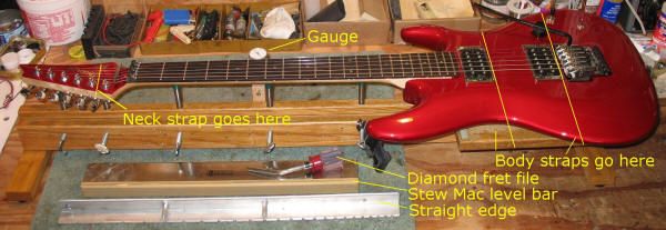

Recently my Ibanez JS1200CA starting fretting out in a couple places when doing bends.
The fret tops got flat and wide to the point that notes just died when doing bends.
Some notes were just not ringing out because the next fret up the neck was higher than the flatter fret below it.
I dreaded the thought of shipping the guitar to a qualified Luthier.
There's no one I know of around here.
And so I started looking into doing a fret level and re-crown myself.
There's tons of info out there on other forums and some cool video's on You-tube.
Looked like I just need some good tools and a bit of skill to get the job done.
After looking around the Stew-Mac web site I spotted the main tools I would need.
Although you can go crazy and get way more tools, I settled on these tools I would need.

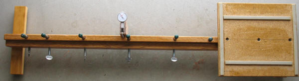

A neck jig to hold the neck perfectly flat while leveling the frets.
A notched straight edge so you can tell when the fretboard is perfectly flat.
A long precision ground fret leveling bar with some 320 grit Stik-it paper
A diamond fret file.
$370 for the Stew-Mac neck jig??? - I can make that for $30
Not counting the dial indicator, I already owned that tool.
$72 for a notched straight edge??? - I can make that for free on my CNC machine
I sprang for the diamond fret file because I don't have anything that can come close to doing that job.
I sprang for the 16" fret leveling tool and stik-it paper because this tool is fairly critical in gettting nice level fret tops and it was not too expensive.
The big heavy fret level tool was really nice, I am glad I purchased it.
I didn't buy a radius block because I was real careful not change the radius of the frets.
I can make other tools on my CNC machine like radius gauges, etc that you use for setups.
I practiced on my heavy caster first to get the feel of how the whole fret level thing should work.
Then I did my Ibanez
All I can is WOW, my Ibanez plays and feels even better than when it was new.
The notes all ring out loud and clear now and it play like a million bucks.
I set up a web page with some big pictures and more info here
The neck jig tool and the other tools are shown on this page.
http://www.el34world.com/Misc/Music/Guitar1.htm

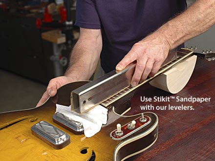

« Reply #5 on: April 05, 2010, 03:14:43 pm »
I think he meant the picture of, what might be, Dan Erlewine trying to sell us StikIt pads.  :wink:
  • Posts: 10672
Re: My Neck jig - fret and fretboard leveling tool
« Reply #6 on: April 05, 2010, 03:19:45 pm »
Ah, ok,
Forgot I had posted that pic from the Stew-Mac site.
That pic shows the leveling bar I bought.
I also had to buy the Stik-it for $23, which kind of sucked.
You only need a 18" long piece and it last forever.
I think the roll I had to buy was 25 feet or something crazy.
I looked around the web, but could not find a smaller, cheaper roll.
It's way nicer than just plain ole sandpaper and it has the adhesive backing

Yeah, well maybe for you, but I had no way to keep the neck flat as I worked on it.
I lowered the middle rods and left the headstock rod in place.
Then I laid the leveling bar on the neck.
The high frets pushed the neck down out of the flat position way beyond flat.
It worked awesome for me with only .0015 flex in the neck as I worked and so I am sticking with it.
I see tons of those jigs being used by shops everywhere so they can't be useless to everyone out there.
Use whatever works for you.
I suppose a long flat leveling bar is useless also?
maybe use one that covers just 3 or 4 frets?  :laugh:

I saw plenty of techs that used a roller block to hold the neck.
That's probably good enough.
I also saw lots of people that were using straight edges that sat on top of the frets to try and get the neck flat.
I liked the idea of a straight edge that fit down over the frets and sat right on the fingerboard and it was easy for me to make on the CNC
I am sure you can do a good job with whatever you use.

For the frets themselves?  Yeah.  We use a couple 12" long flat files we mounted on handles about 38 years ago.  We use a 24" level for leveling fingerboards when the frets are out, but those are seeing less use now because THESE work so much faster.  (Not better, mind you , but certainly faster, and time is money!)
I honestly don't see the point behind the fret jigs.  You set the truss rod as straight as you can get it, and then level the frets from there.  What more do you want?  I mean, at least half the point behind a fret dress is to bring the high frets down to level, and frequently you need to correct a small amount of twist or bow.  Forcing that bow out of the neck is not a good idea - you are trying to correct that geometry problem in the frets.
The tools that are absolutely required, though, are pretty simple.  A really nice 24" straight edge, a truss rod tool, a way to level the frets (we like our files, but Frank Ford uses a nice flat plane body with sandpaper, and if you want to use a level go for it), a big 8" mill bastard file with the edges ground smooth to recrown the frets (those fret files are nice for shaping the ends of the frets, but are useless for recrowning the frets - they leave the wrong shape!  A big flat file is faster and does a better job), something to protect the fingerboard (our favorites are New York City subway passes!), a bunch of sandpaper, some OOOO steel wool, and some mineral or linseed oil.

I forgot to mention that I also sanded the edges of the fretboard between each fret with some fine paper
This softens the edges of the fretboard and makes the guitar feel like it has been played for a long time.
« Last Edit: April 19, 2010, 08:57:46 pm by EL34 »
