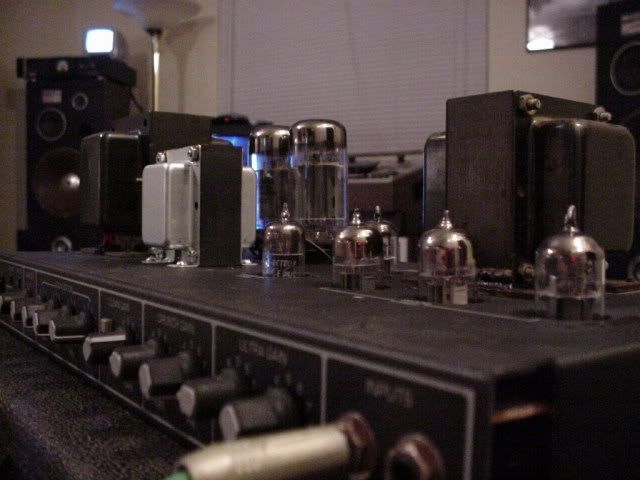

I picked this Peavey Triumph 60 head yesterday for cheap. I did the mod to allow the EQ to function in the Crunch and Ultra channels. Also shorted C1 & C2 diodes to remove the premature clipping in the preamp. Amp is much more open now and sounds pretty decent. The clean channel is very good i think.  Reverb is smooth and not overbearing. Question:
How can i determine if the PT in this amplifier can handel EL34 power tubes? I have no PT spec's

You could put some in after you modify the socket wiring,and check the before and after heater voltages.If they drop too much then the PT is being taxed too much on the heater winding.
  It may have a stout PT in it but I would leave nothing to chance.

« Reply #6 on: May 31, 2010, 09:45:44 pm »
I have one of this myself and have done those mods as well , mine sounds pretty good too , however , if you add the choke let us know how it works out. :grin:

« Reply #7 on: June 02, 2010, 08:50:21 pm »
The changes i just made really make this amp a jewel to keep
The Fuzz / Buzz is gone and the amps Crunch and Ultra channels have a very nice and smooth growl to them
Each channel as well is totally different sounding than the other. Before the changes both the C & U channels sounded almost identical with no noticable difference between them so to speak
I changed the 220K 12AT7 plate from 220K to 100K. I changed the plate of V1B from 150K to 100K. V1A stayed the same at 150K
I changed the PI to the standard Mashall / Fender LT PI using .022 coupling caps
I used a  Classic Tone 5 henry choke in place of the 400 ohm resistor / What a huge diff in overdrive quality
The grid bias resistor was 68K and now is 27K. The grid is -51.00 VDC / It calls for -56 VDC but it sound good enough to me
The Clean channel is very excellent as it was before making any changes / My job is done. It really has character and is a smoothie
Im finding that Classic Tone transformers are pretty darn good sounding and look well made / There prices are dirt cheap
This is the 4th  transformer i have used from them. A JCM 800,Peavey Delta Blues,Mig 60 and now this choke from them

« Reply #9 on: June 03, 2010, 12:15:39 pm »
I am using a pair of Sovtek 6L6GWB tubes for now. The amp board did not follow the schematic 100%. There were many different resistor values other than what shows on the schematic. They are factory installed /
I changed some more parts:
I removed C7 .015, Removed and bussed R9. Changed R6 100K slope to 33K. Changed V2B from .47 to .68
It continues to get better. These are the final touches. I am using EL34 power tubes now
I can hear a more hollow and woody tone using them over the Sovtek 5881/6L6GWGC tubes
I am pleased with the results so far. Much better than stock
Just changed R86 V2B grid divider from 220K to 470K. Even smoother now. Compression is  insane but smoother and well defined
If you make any changes to this amplifier be sure to use the schematic. The preamp tubes are scattered throughout the amp and not wired as you might think starting with V1A on down the line
In other words each tube has two halves to it but they are not wired parallel to one another or even operating the same channel
