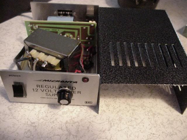

I want to build a regulated heavy duty 9 volt power supply for all my pedals. Sick of batteries and expensive alternatives
I have an old Radio Shack 13 VDC 2.5 amp regulated power supply to work with. Do i change the voltage chip value to get 9 VDC out?
The transformer secondary is 4 VAC to rectifier
I tried just using a pot in between the transformer and board to control the voltage but that does not work under load
I found a schematic online to build one and then i thought of my old CB power supply that i found new in the box at Goodwill 3 months ago
What to do? Where to start? There are (2) chips on the Radio Shack board and to heatsink.

Do you have a schematic for that PS? If so, it's probably as simple as changing two or three simple components. If no schematic, throw the pcb away and build this simple regulated PS. I'm using this and a wall-wart to power 8 Boss pedals plus a '70s Crybaby. I wouldn't hesitate to hang a few more low current pedals on it.
The regulator chip is a TO-3 style and needs a heatsink. Chassis works, but you gotta isolate the chip case from chassis with a mica washer and appropriate mounting hardware.

Thanks Steve, I always appreciate your help.  I have looked high and low but no go on a schematic for this. Too bad it isnt under the cover like in the good old days
You say adjust without a load / Wont 4-5 pedals draw it down a bit? Im not thinking clearly. It is regulated im forgetting so the 9 volts will be solid
( you gotta isolate the chip case from chassis with a mica washer and appropriate mounting hardware) I will remeber that!

The Micronta PS board is too simple. I think i have it figured out. I dont need a schematic to figure this one out. I will just remove it and use that board to build from the schematic you provided.  Early in the post i was spending too much time looking online for a schematic for the Micronta and not enough time looking at the board itself

You could go with a 7809 regulator.  It has a wide input voltage range, is non adjustable and rated for 1A.  It makes for a few less componenets in the circuit.  You can power several pedals with one amp.  There are other regulators out there that would work well also.  Building a supply for pedals is pretty simple.  Transformer-rectifier-smoothing cap-regulator.

I ordered (2) regulators. One  7809 and one LM123K. I will figure out which direction to go when they get here
Also Steve the TO chips on the chassis mounted heatsink are isolated and have the rubber piece under the chip to the heatsink and a nylon screw and nut
The 7809 is good for 1 amp. The LM123K is good for 3 amps. More amps means more pedals from a single regulator.
I believe those chips are really transistors, TIP31 and 2N3055.
3 amps is the way to go. I ordered the other one just to have one if i need it later for some thing else

That LM350K is adjustable 1.2-37V at 3A. It should work fine for the LM123K circuit I drew above, but just to be sure, look at some data sheets for the 350. The data sheets often include several application circuits too. Mouser thinks the LM123K is obsolete, but that ain't so, at least for FAA and DOD. BTW, that exact circuit is used in one of my radar systems, except the pot was adjusted for 10v rather than 9v.
I suggest a TO-3 mounting socket and mica washer and heat sink grease if you will be operating near rated current. The socket will simplify mounting since it has the shoulder washers built into the socket.

Yes. I just mounted mine on the chassis without a dedicated heatsink.
If you don't think you'll exceed 1 amp, just use a Fairchild LM7809, 40 cents at Mouser. Very simple, bridge, 2 caps, chip.

Got the power supply almost finished. (2) small caps i ordered were not in the order i recieved this week. I went to Radio Shack and picked up the LM 123K. I was surprised they even had one.  Almost there.
