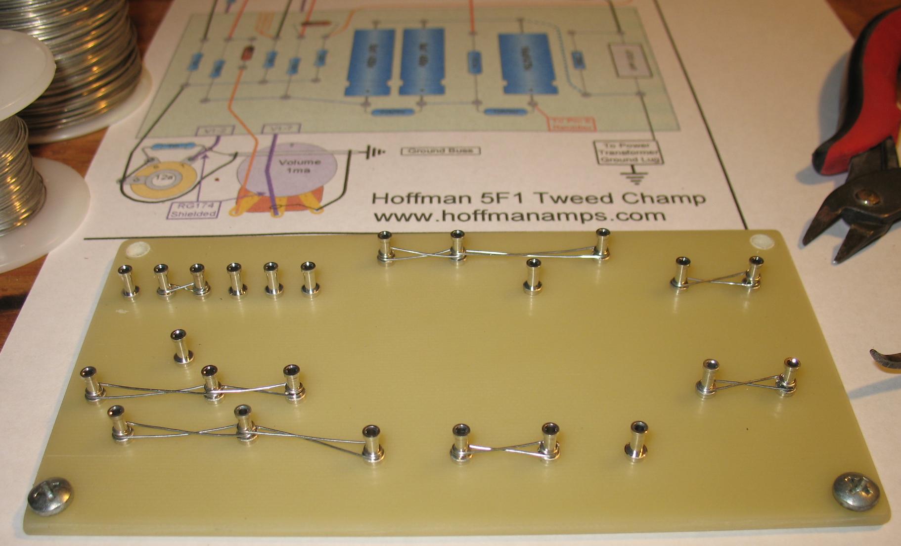

Left: I have installed the turret lugs and screwed the board down to my work bench so I can lace up the jumpers on the board
Right: I have laced the lugs. (Creating jumpers between the lugs)

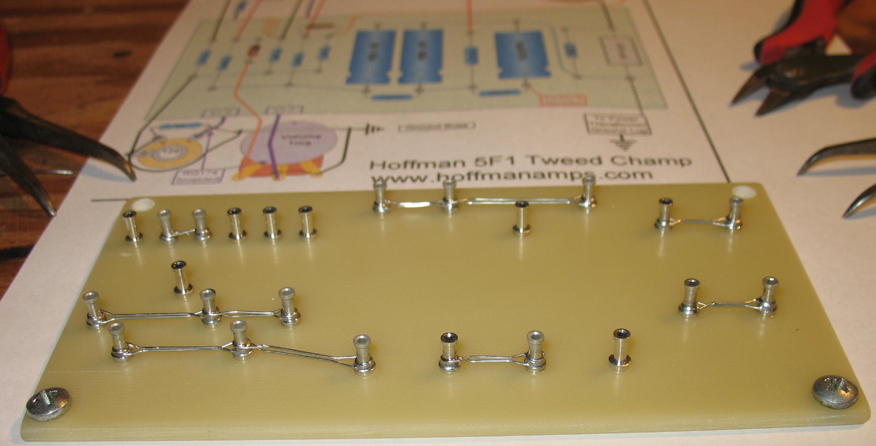

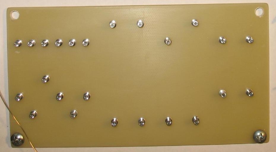

Left: I soldered the lacings down at the base of the lugs

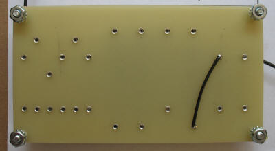

Right: There is one jumper wire on the back of the board

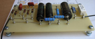

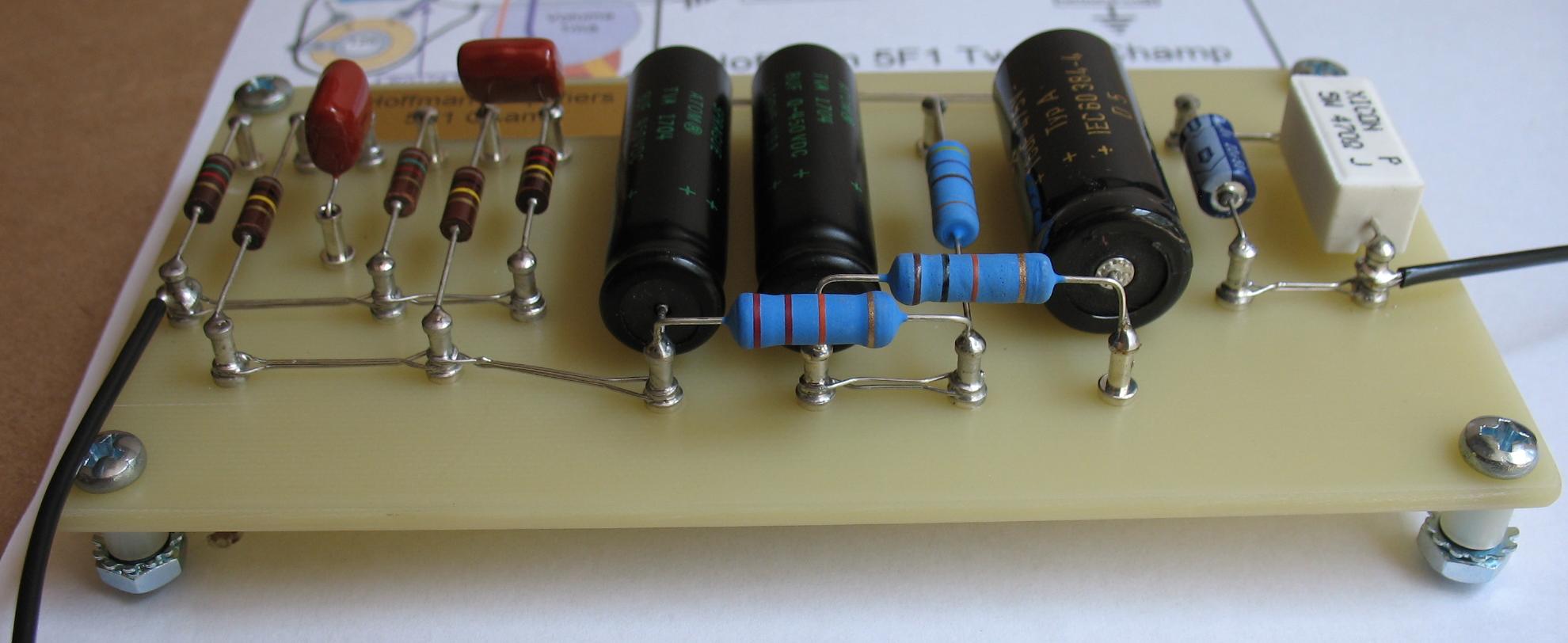

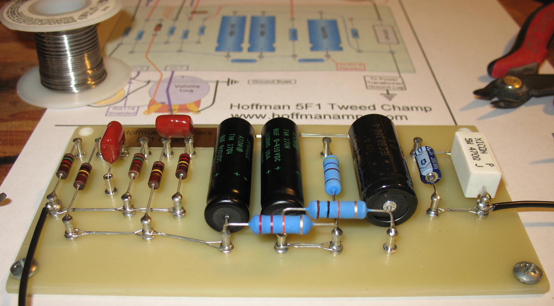

 The parts have been installed and soldered to the top of the lugs
The two ground wires have been installed

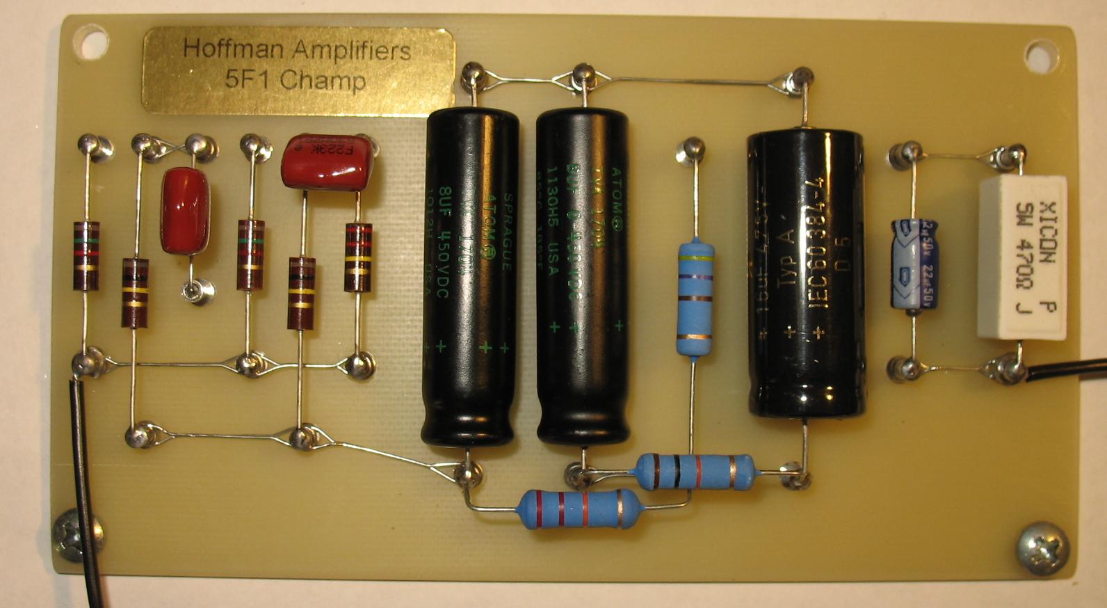

Hoffman 5F1 Champ Board
The mounting hardware has been installed and the board is ready to be mounted in a chassis
