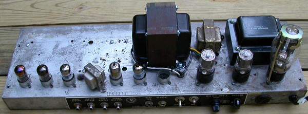

The old Deluxe Reverb chassis I started with came out a pile of junked Fenders I purchased
This amp only has the reverb channel and so there is an extra tube socket that is not being used.

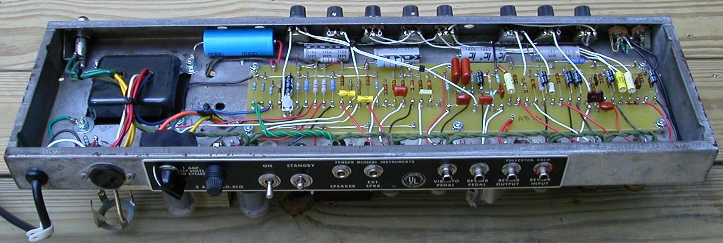

This was the first Hoffman AB763 board I made
If you look at the transformer hole you can see it was hacked out by a caveman
Someone had installed a very large Twin Reverb power transformer in the chassis
I installed a 022798 Super Reverb power transformer
I had to use some fender washers to get a grip on the over sized chassis hole

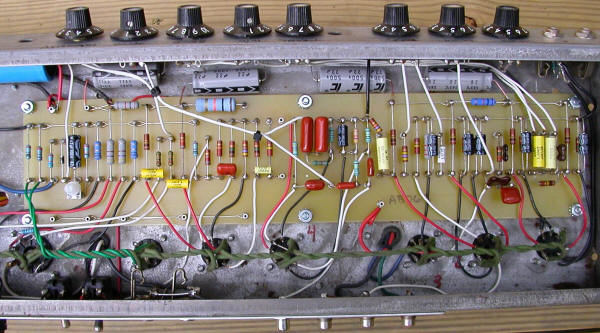

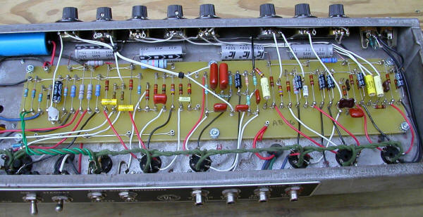

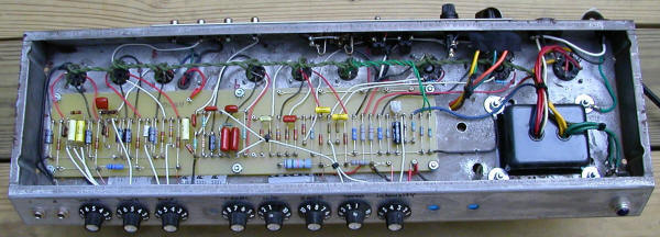

Here's a good shot of how I ran the filter caps along the front edge of the amp
I did not use a cap board and cap can.

Hoffman AB763 One Channel
Another shot of the Hoffman AB763 board and filter caps

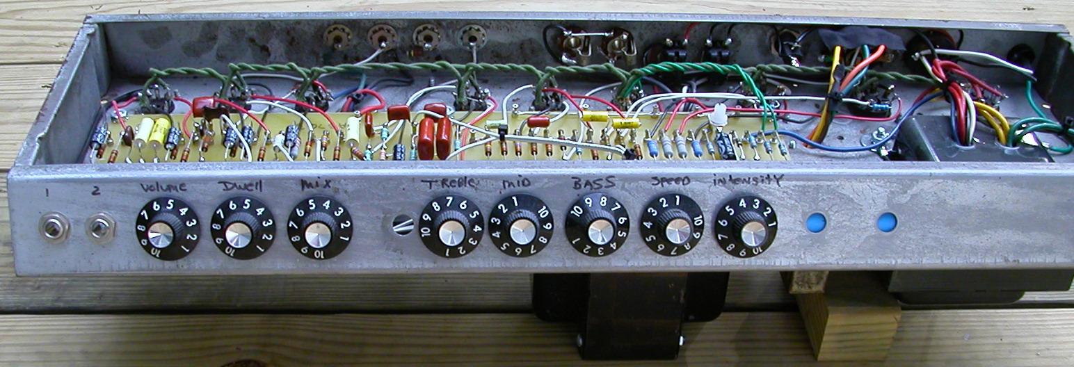

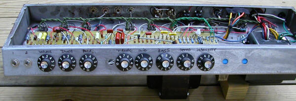

A front panel shot before I installed the custom face plate
I added a dwell control to the reverb section and I am using a 3 spring 9AB3C1B reverb tank

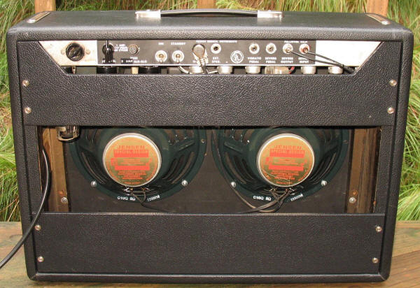

I sent the cabinet to Mojo to have it recovered.
I made the 2 x 10 baffle board and installed some Jensen Speakers

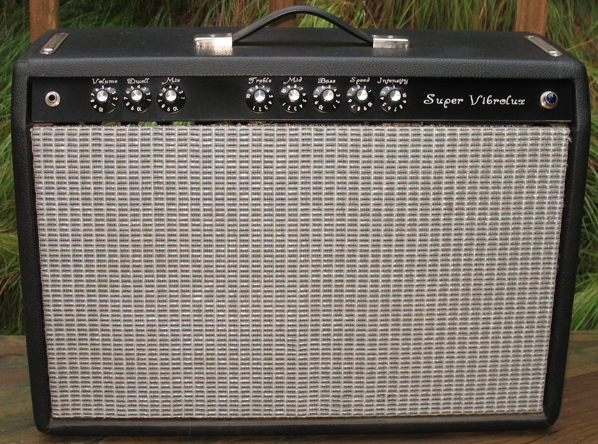

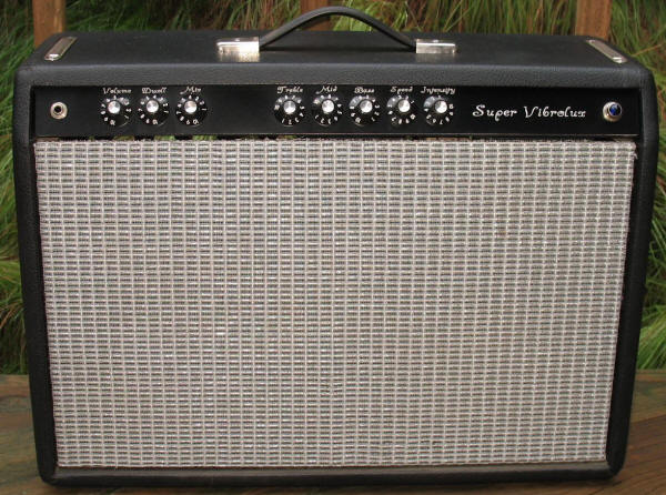

Front shot with the custom face plate
 This used to be a 1966 Deluxe Reverb chassis. I purchased the chassis and cabinet as part of a large Fender junk pile deal.
The chassis had a Twin Reverb power transformer in it when I bought it and it was pretty hacked up.
The cabinet was bare wood. I made a new 2 x 10 baffle board because I like the sound of 10 inch speakers in Fender type amps.
 I installed a Hoffman AB763 reverb combo circuit board in the chassis.
I added a dwell control to the reverb and it has the normal reverb mix control found on all Fender AB763 combo's.
It has power tube tremolo, not opto tremolo.
 I deleted channel one from the AB763 circuit board. Who uses channel one? Then I moved all the controls to the left.
The controls starting from the left are ( Volume, Dwell, Mix --- Treble, Mid, Bass, Speed, Intensity )
 The baffle is a 2 x 10 speaker arrangement so this amp is now closer to a Vibrolux Reverb than a Deluxe reverb.
It has a 022798 power transformer, which is the Super Reverb/Pro reverb power transformer so it has more power than a Vibrolux Reverb.
It is Probably around 40 something watts.
  The output transformer is a Hoffman H50WO, that I had laying around so I decided to put it to good use.
I have a rotary impedance selector on the back so I can use different cabinets or two cabinets at once.
The filter caps are all inside along the front edge, there is no cap can.

 I had Mojo re-cover the cabinet and add grille cloth to the custom 2 x 10 baffle board.
The speakers are new Jensen C10Q's.
