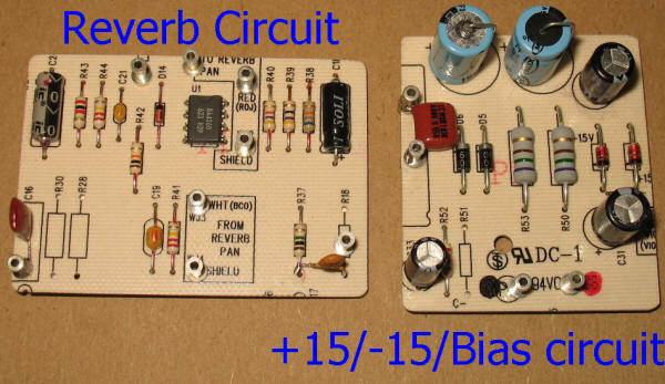

My original intent was to cut out the reverb circuit and power supply from the original PCB board
This plan did not work out
There is just not enough room on the turret board to add all the parts for the solid state reverb circuit
The original solid state reverb with the tiny reverb tank is not all that great anyway
Note: I have made some changes to the Blues junior Turret Board shown below after doing this build
I added the bias circuit to the new board layout
I removed the parts that had to do with the reverb circuit

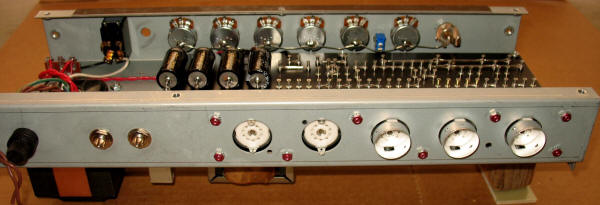

Here's the stripped out guts of a Blues Junior
You do not need to remove the power transformer and the output transformer

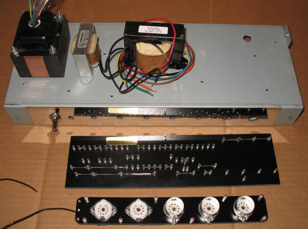

Here's the parts I will be installing
The customer sent me an Allen TP24 power transformer and a Mercury Magnetics choke
The Output transformer is a Heyboer 18 watt output, which I stock
The main board is a Hoffman Turret board
The separate tube board assembly is shown on this page
See the links at the top of this page for the catalog pages and the parts list
Note: Look at the input jack hole in the photo
It is larger than a 12A Switchcraft jack hole size.
The fiber washer in the parts list fit perfectly in the hole so you can mount the 12A jack
The fiber washer is not there to isolate the jack from the chassis

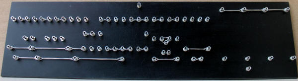

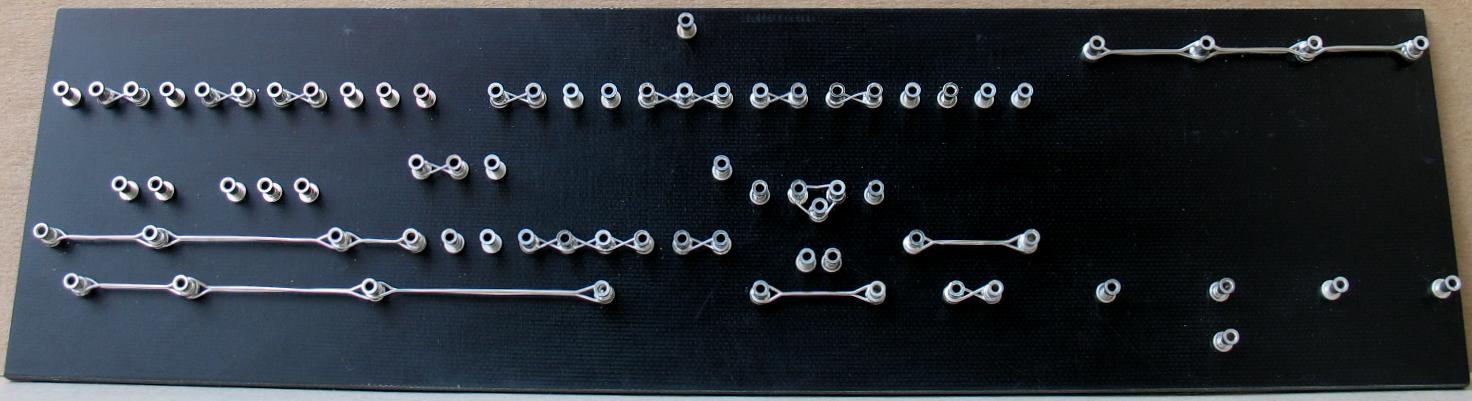

Hoffman Blues Junior Conversion
Here's the main board with the lugs installed and laced together
Note that the newest turret board version now has the bias circuit on the board

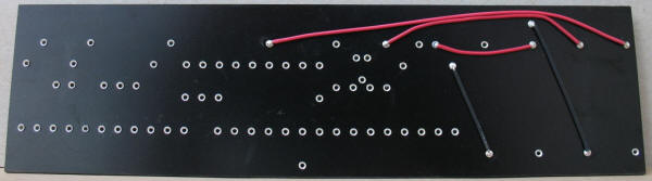

The back side of the board with the jumpers

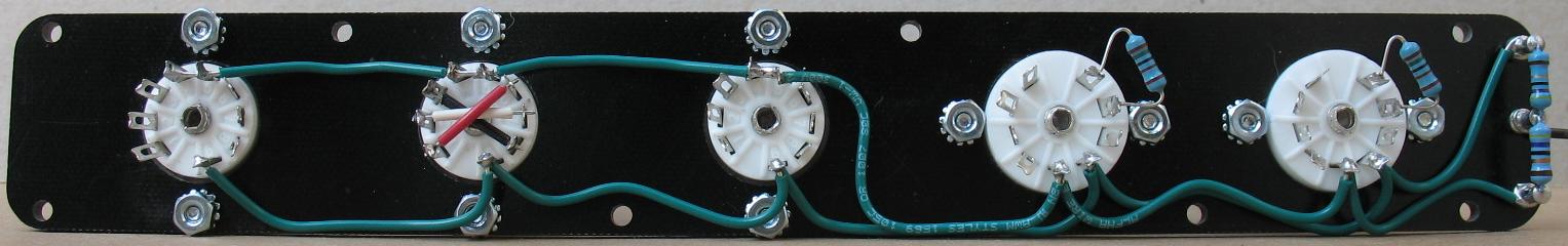

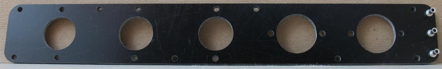

This is the tube socket board that I machine on my CNC machine
The newest version of the tube socket board has recessed screw head holes and eyelets for the 47 ohm resistors
The tube socket board with the sockets installed, the heater wires run, the 47 ohm center tap resistors installed and the 1.5k input grid resistors
The heater wires are not twisted and still the amp runs dead quiet.

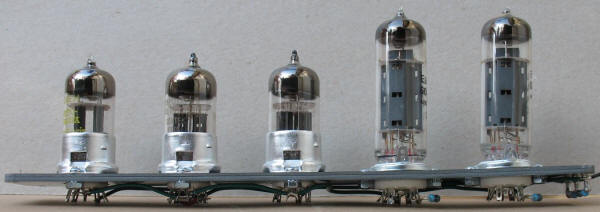

A side shot of the tube board with tubes installed

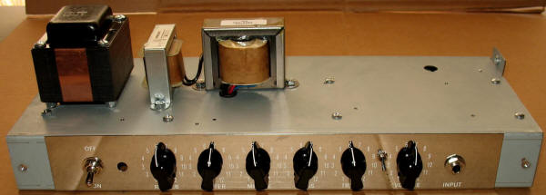

The Allen TP24 power tranny. Mercury magnetics choke and Mojo 768sp output transformer
The BJ does not come with a choke, my customer wanted me to install a choke on this amp

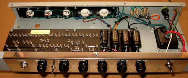

Tube socket board installed. Main board installed. Jacks, pots and fuse holder installed

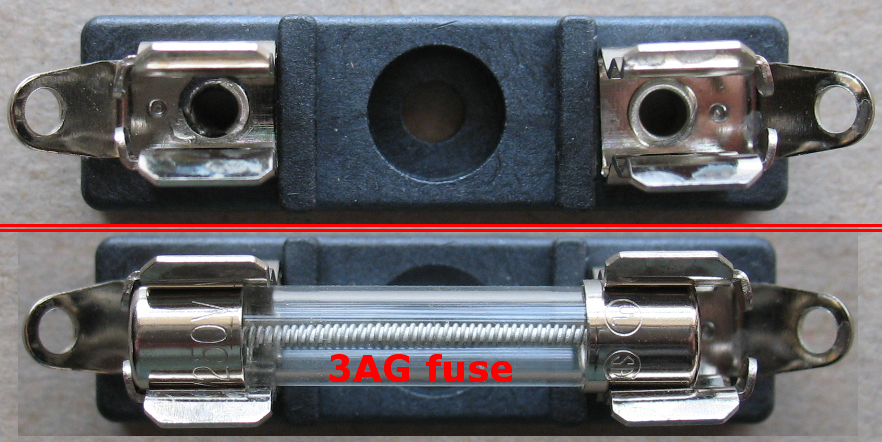

I had to drill a 1/2 inch hole to install the Fender style fuse holder
Update: I have since added a new bolt down fuse holder in my store.
I realize not everyone can drill 1/2 inch holes for a Fender type fuse holder
The new fuse holder looks like this and accepts standard 3AG 1.25 inch long slo-blo fuses
Use a 6/32 x 3/8 inch long screw and 6/32 Keps nut to bolt it down to the chassis

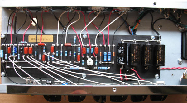

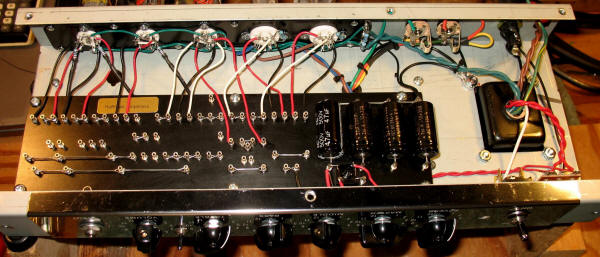

Tube sockets wired up to main board
Components installed and pot wires run
I had to abandon the idea of using sections of the original PC board for reverb and the +15/-15/Bias supply
So then I needed to make a small bias circuit board and mount it next to the main board
The latest BJ Turret board version I sell has the bias parts on the board.
There is no need for a separate bias board.
Note that the brown wires are the bias supply wires from the power transformer.
One wire goes to chassis ground and one wire goes to the 1n4007 diode.
My original idea was to take the PC board and cut out the solid state reverb circuit and the +15,-15volt, bias circuit
This proved to be a no go after I had installed the main turret board.
There was just no where to mount the reverb board
And it would make things way more complicated for others trying to add reverb to my turret board
It took a very long time to cut out those two boards shown above and then add turret lug attachment points
Luckily the customer that owned this amp did not want the solid state reverb and so I abandoned the whole idea
The amp is without the solid state reverb and that is fine with me
The original solid state reverb does not sound all that good anyway
Many people use external pedals and effects for reverb and delay
