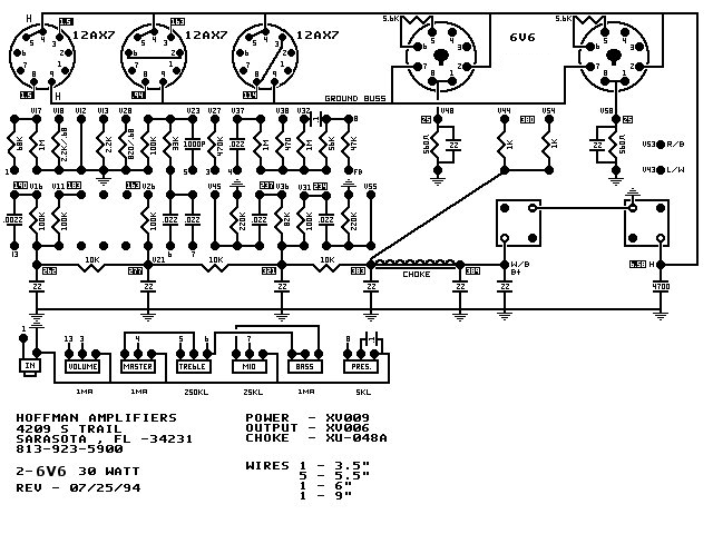

The Original 30 watt Hoffman head layout diagrams.
2 x 6V6 model
Notice that the heaters were run on DC on early models.
 That was dropped later on and the heaters were run conventionally on 6.3 volts ac.

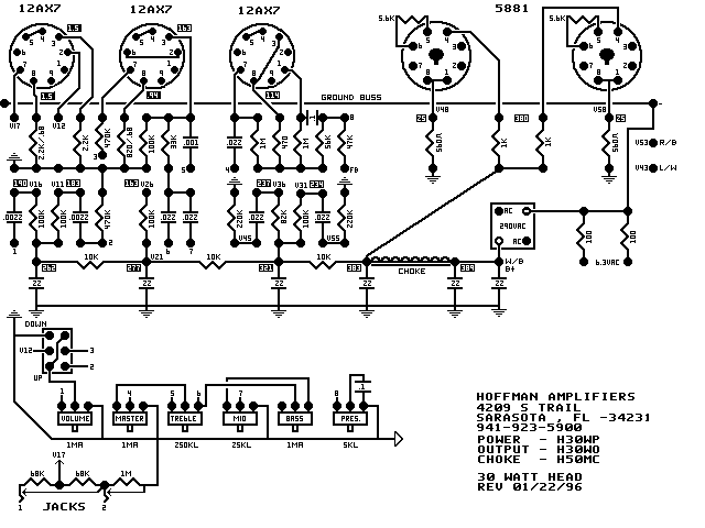

2 x 5881 - AC heaters and hot switch mod
